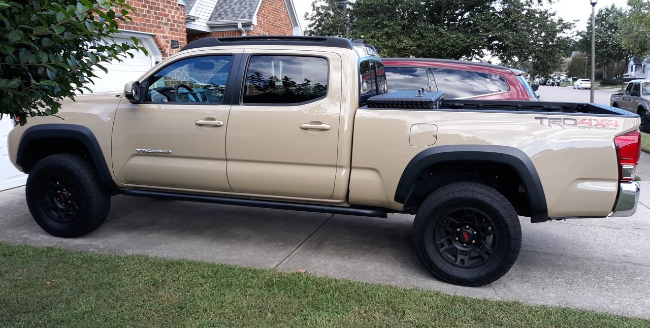

    5100/887 1/4" on drivers side, both fronts set on the lowest perch
  12. May 10, 2019 at 6:39 PM
    #692
    jsinnard
    jsinnard Well-Known Member
    Feb 4, 2009
    #13279
    6,679
    J
    Virginia
    16 QS DCLB OR 4X4
    Stock rear end?
  13. May 10, 2019 at 6:46 PM
    #693
    ATdivide
    ATdivide Well-Known Member
    Mar 3, 2015
    #150063
    155
    Aaron
    RVA
    '17 DCSB TRD-OR '12 DCSB TRD 4x4 '05 Gen4 Runner
    Blank Slate
    5100's and Icon AAL
