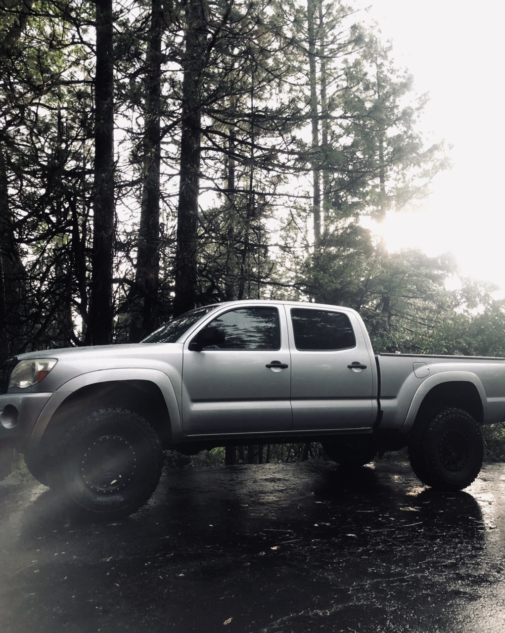

    MAVERIK43
    MAVERIK43 Member
    Mar 20, 2016
    #181812
    6
    Northern California
    07 DCLB
    5100’s/887’s/EL096R’s/35’s
    5100’s/887’s, EL096R’s with bottom overload removed, Bilstein B110’s, 315/76R16 ST Maxx. Averaging around zero f*cks per gallon.

    Looks really good! What did you need to trim?
  4. Jun 1, 2019 at 10:30 AM
    #704
    MAVERIK43
    MAVERIK43 Member
    Mar 20, 2016
    #181812
    6
    Northern California
    07 DCLB
    Removed all of the wheel well liners, I’m going to make some new ones out of 1/8” ABS. Cut 3 1/2” inches out of the bedsides, left tabs for liners. Cut 3” out of the front fenders and left tabs for liners. Cut 2 1/4” out of all four flares, beat the pinch weld flat with a 4lb sledge, and cut the cab mount 3 1/2” out from the frame, even with the fire wall. Tried to get caster to +3.5 with the first alignment, but only got +1.7. Rubs pinch weld, cab mount, and UCA at full lock for now. I’m going to do some more cutting today, and get some wheel spacers. I cut the fenders and flares with a jigsaw and a fine tooth blade, worked great.

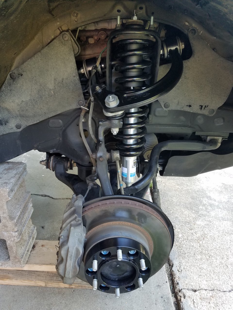

    Here is my setup as of today:
    OME 887s
    Toytec .5" spacer driver side
    Toytec .25" spacer passenger side
    SPC UCAs
    Bilstein 5100s
    GeneralSpringKC 90-297HD Leafs
    Toytec .5" shims
    Bilstein B110s
    I've also added an Icon Sway Bar relocate,
    U-Bolt Flip Kit and Superbumps all around.
    Hub to fender:
    DF: 23.5
    PF: 23.5
    DR: 24
    PR: 23.5
    Ground to fender:
    DF: 38.25
    PF: 38.75
    DR: 38.5
    PR: 38.75
    Looks like I got 4" in the front and 3 in the rear. The front will settle, I'm sure but the rear I've had for 20k miles so it's set.
    For tires/wheels I have:
    Stock TX Edition wheels with 1.25" Spidertrax spacers.
    BFG KO2 265/70R17. They rub on full lock in the rear part of the fender. I have caster at 2* but am going to try to get 3* after alignment tomorrow.
    Jacked Burton likes this.
