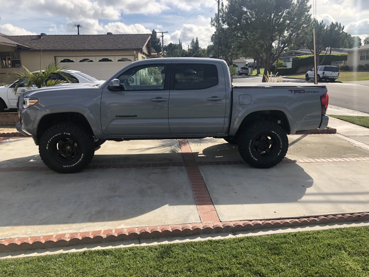

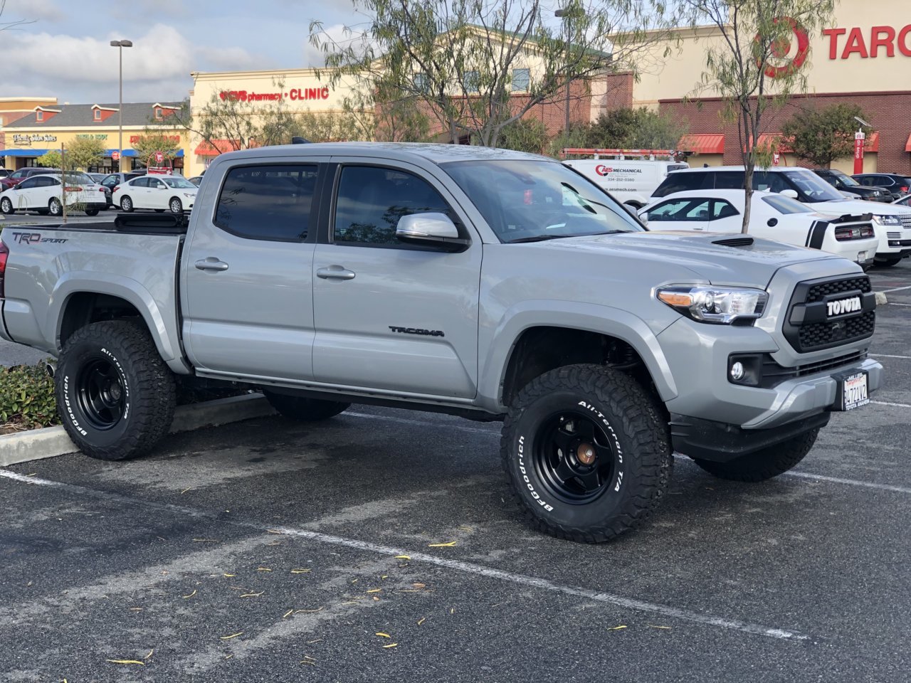

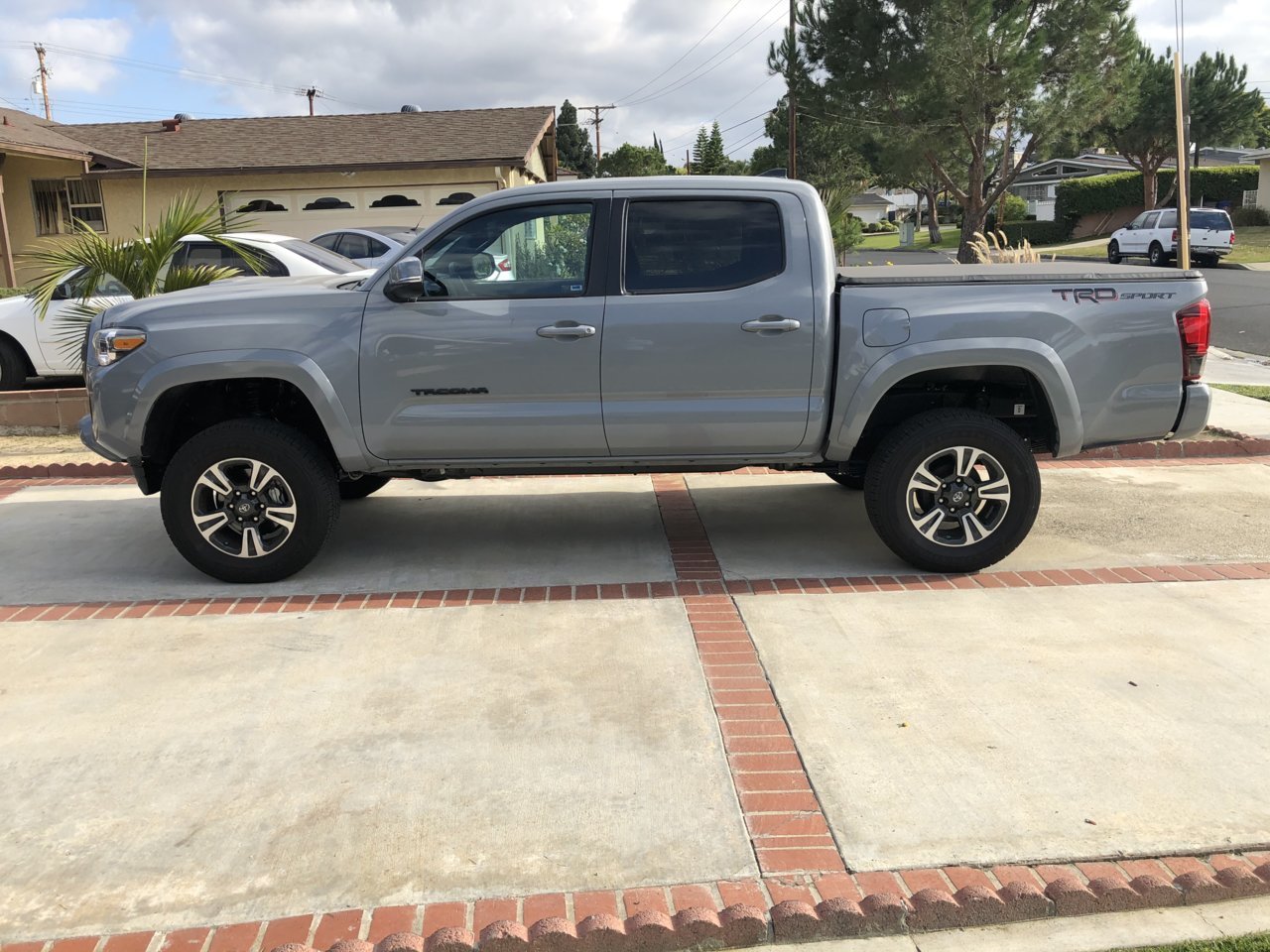

    48C3F843-2D24-4209-A25B-6E0D4385367D.jpg 3CC0E0B1-56D8-4CF8-894D-5B7367284D66.jpg 82FB72E3-3F1E-4F90-BEF8-D9267786BBBA.jpg 3CC0E0B1-56D8-4CF8-894D-5B7367284D66.jpg Well I have a 2019 TRD Sport 2WD. I just lifted the truck with a full OME kit. 887 Coils and Medium duty leaf springs (Standard Dakar Leaf Pack) and soft valving Struts/shocks. On a 2WD it translates to a lift of Front Driver 3 3/8”.....Front Passenger 3 1/4”.... Both rear 2 5/16”. Yauza!! I knew it was going to be taller than the 2 inch advertised increase, due to mine not being a 4x4, but it was a significant increase. I just installed the BFG KO2 285/75/16 on SCS F5 with a -25. I can feel the truck pulling harder with this size. It only rubbed on the front bumper splitter /chin spoiler, so far. 48C3F843-2D24-4209-A25B-6E0D4385367D.jpg 82FB72E3-3F1E-4F90-BEF8-D9267786BBBA.jpg

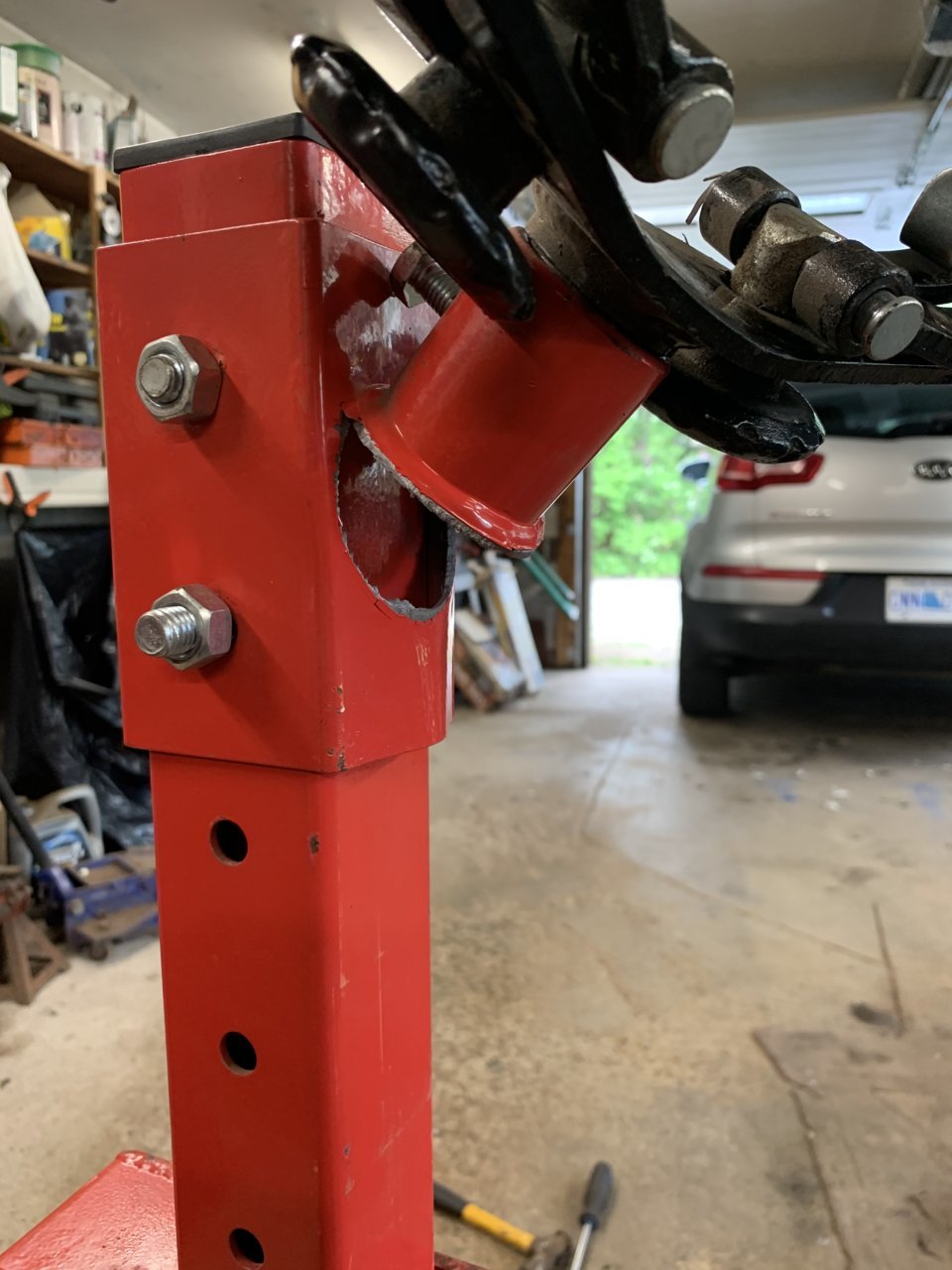

    What is everyone using to compress the coil springs with? Trying broke my floor mounted compressor and the hand held ones bent the tread bars.

    wow, I installed my Bilstein 5100's and OME 887's using the compressor less method. Put the jack under the axle near the ball joint...lowered and raised shock into strut

    Personally, I just watched a bunch of Youtube videos and did the lift myself and I'm no mechanic. You should take your shocks, struts and assembly kit to a tire shop to compress the springs. Then it's just a simple swap out
