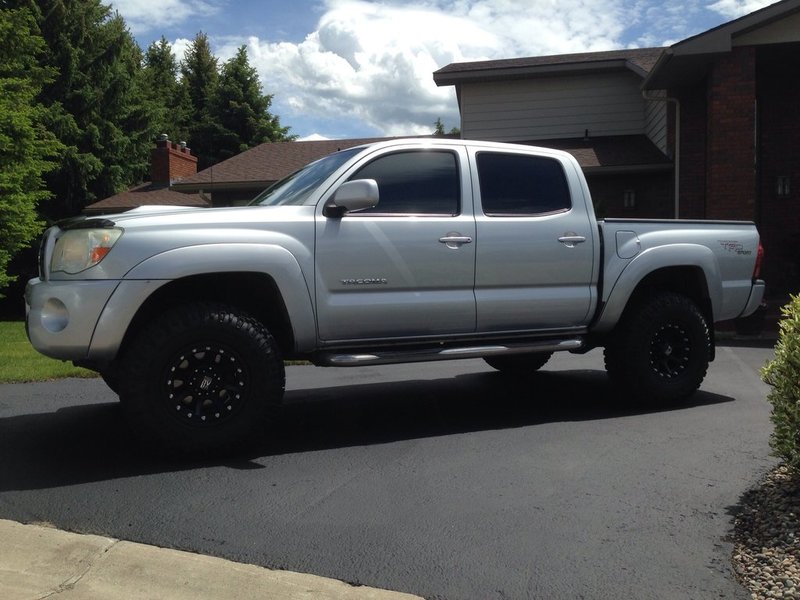

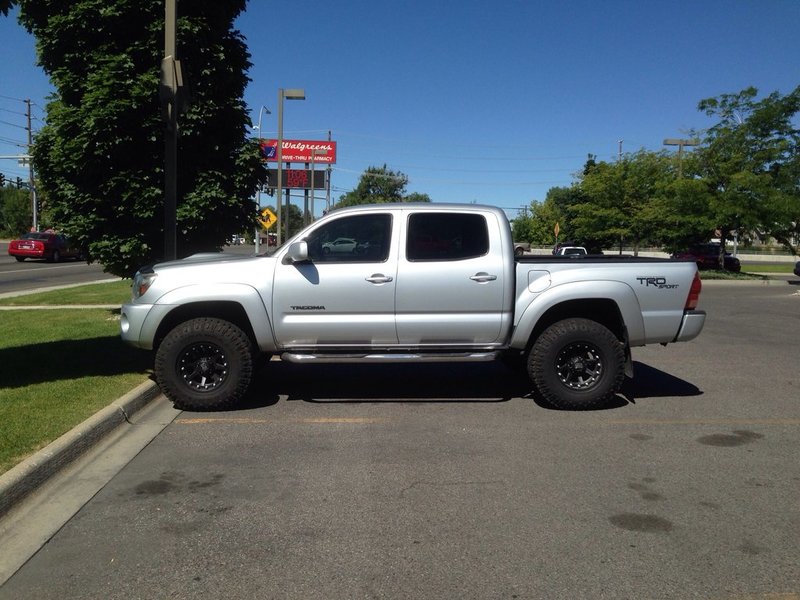

    Day it was installed:
    How it sits now:image.jpg image.jpg

  13. Aug 18, 2015 at 8:28 AM
    #73
    pollock21
    pollock21 Well-Known Member
    Nov 30, 2010
    #46950
    233
    Brian
    Cornelius, NC
    '11 Tacoma DC, TRD Sport 4x4
    Looks good vandal. Tire/wheel specs?
  14. Aug 18, 2015 at 9:38 AM
    #74
    VandalTaco
    VandalTaco Well-Known Member
    Dec 28, 2014
    #145129
    1,045
    Will
    Moscow/Idaho falls, Idaho
    07 DCSB TRD SPORT
    OME 887 lift, 16" XD addicts, 285 duratracs, leather seats, badass JL/Focal stereo
    Thanks!
    Wheels are 16x9 KMC XD Addicts 4.53" BS and -12mm offset. Tires are 285/75/16 duratracs.
