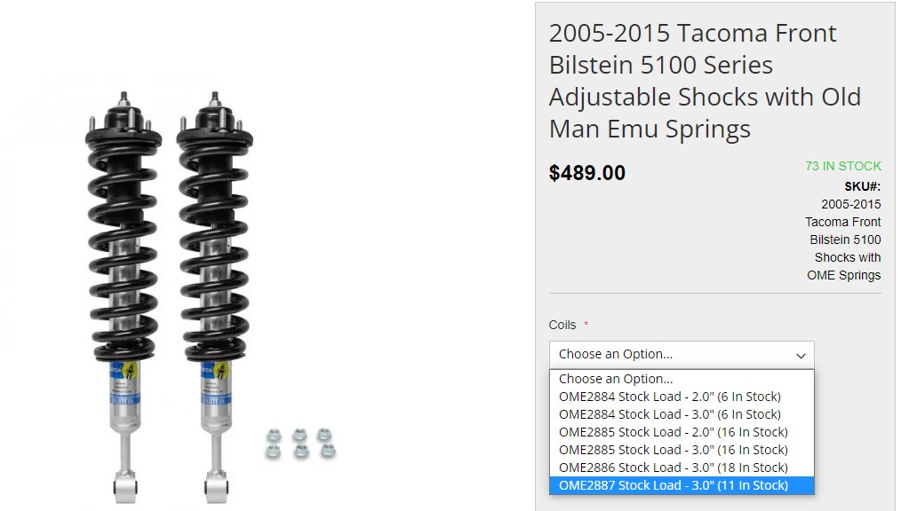

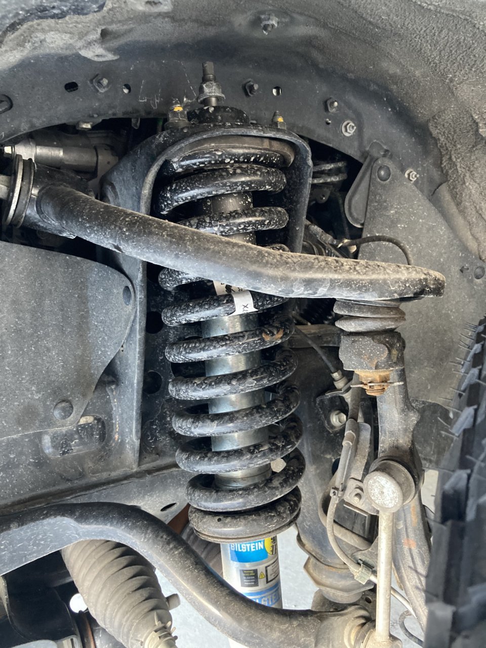

    Resurrecting this old thread for sake of anyone buying the 5100s with 887s assembled from @Wheeler's Off-Road Inc ; make sure you email them after you order and confirm where they will set your circlip.
    I ordered mine from wheelers for my 2nd gen access cab 4X4 M/T knowing that the 887 would give 3" at the most but probably a bit less. On wheelers website they only give one option for the 887 saying its a 3" lift:
    I assumed this meant it was on the lowest seat and they were assuming the highest you could end up with is 3".
    I received the order and installed on the truck and only then did I realize it was on the third perch of the 5100:
    I emailed them about the mistake and they said that it was correctly set up. They said to get 3" out of the 887 for a second gen you need to have it set on the third perch, otherwise it would be a 2" lift. If that were the case I don't know why they wouldn't offer a 2" lift on the 887 dropdown options...
    From reading through all the information about OME coils on 5100s I thought it was common knowledge to set on the bottom.
    Anyways, they're back off the truck now and getting ready to head to a shop to get them compressed and the perch moved down, pretty annoyed I had to pay for assembly just to go pay another shop to compress and fix them for me.

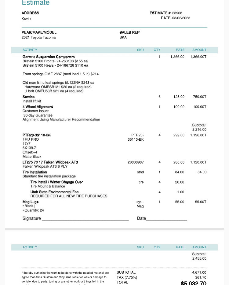

    I’m so close to clicking “checkout”, but I can’t decide on a lift. The shop is highly recommending a full rear leaf spring (OME EL122RA) for 2.25 in the rear. They’re saying the ride quality will be great too. I’m trying to keep cost down a little bit. I don’t hardly ever tow,
    just occasionally load up for camping. I was leaning toward 1.5 blocks. I want just a bit of a lift and good ride quality for my daily driver. What would you recommend? I’ve considered AAL as well, but that also may not be necessary. Do I just send it with the whole new leaf springs? 2021 Tacoma sport 25k miles. Thanks!

    Does this seem reasonable?

    I’d say go with the better components and install everything yourself to keep costs down. Lots of resources on this site for the install, plus folks that are happy to walk thru it with you.

    Here are my thoughts.
    1st - order your own lug nuts. $55????? Amazon will save you $25
    2nd - get BFG's through Costco. You'll save $300 + free install + future flat repairs + free rotation for the life of the tires.
    3rd - Get premium wheels. Check out SCS, RWW, ICO wheels. You'll save. Costco will install as-well.
    Their lift rate seems fair. As for wheels & tires, you can easily save $700-800 by purchasing through other outlets.

    Thanks for the info. I did find the wheels through another site and they were cheaper.
    basically what I’m hearing though, is to have them only do the suspension work, but shop separately for wheels/tires/lugs.

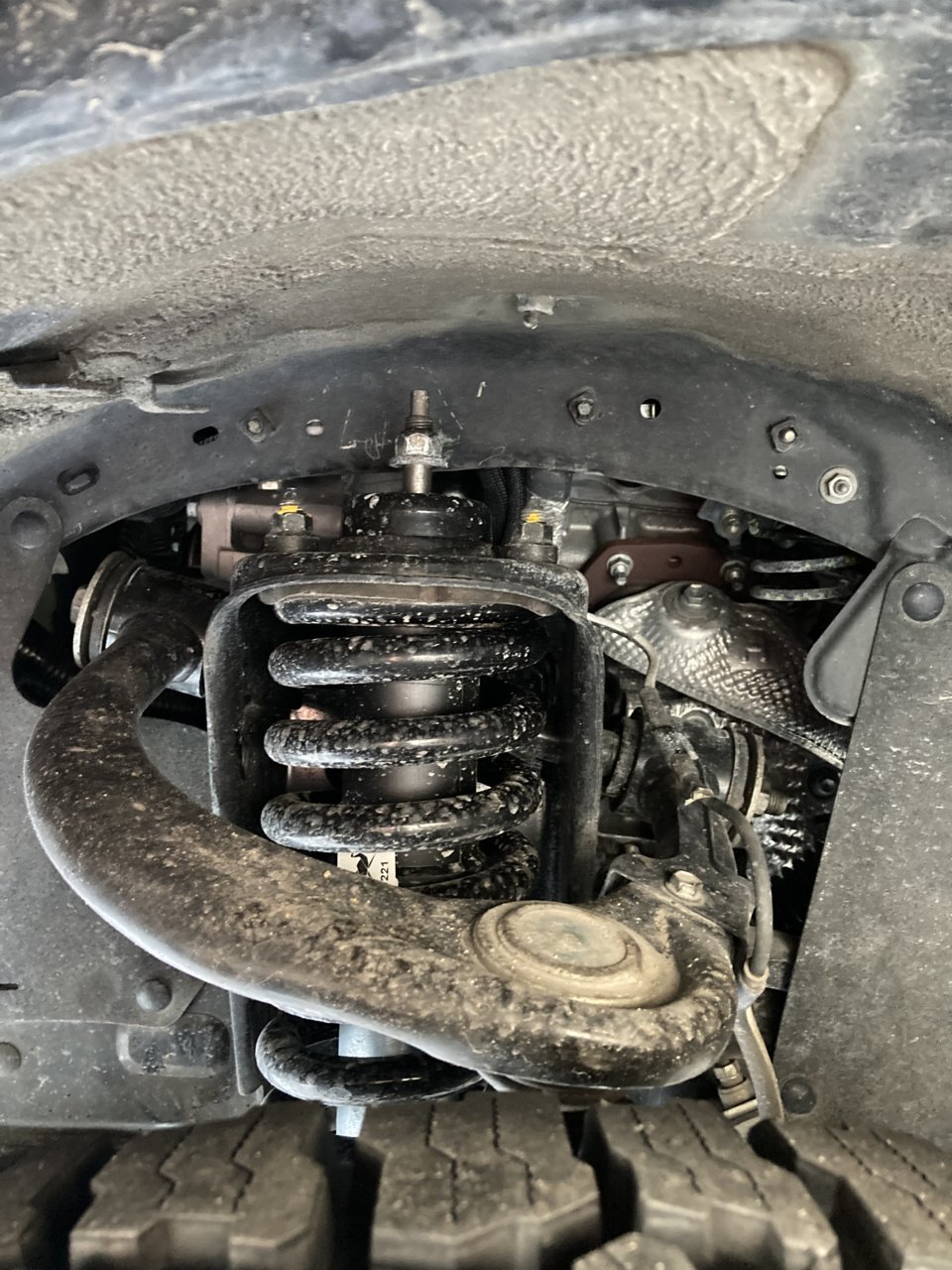

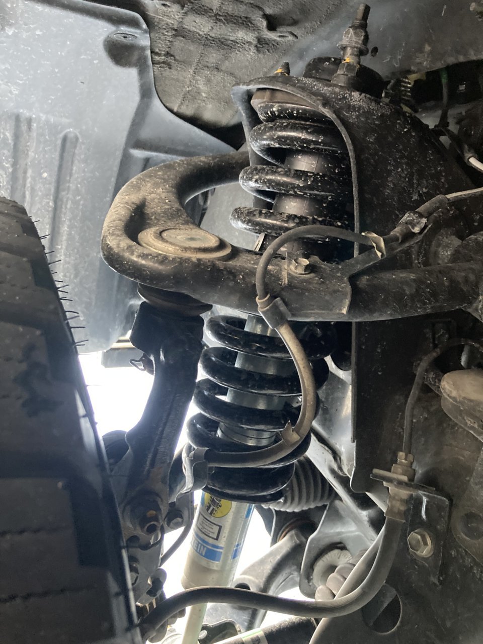

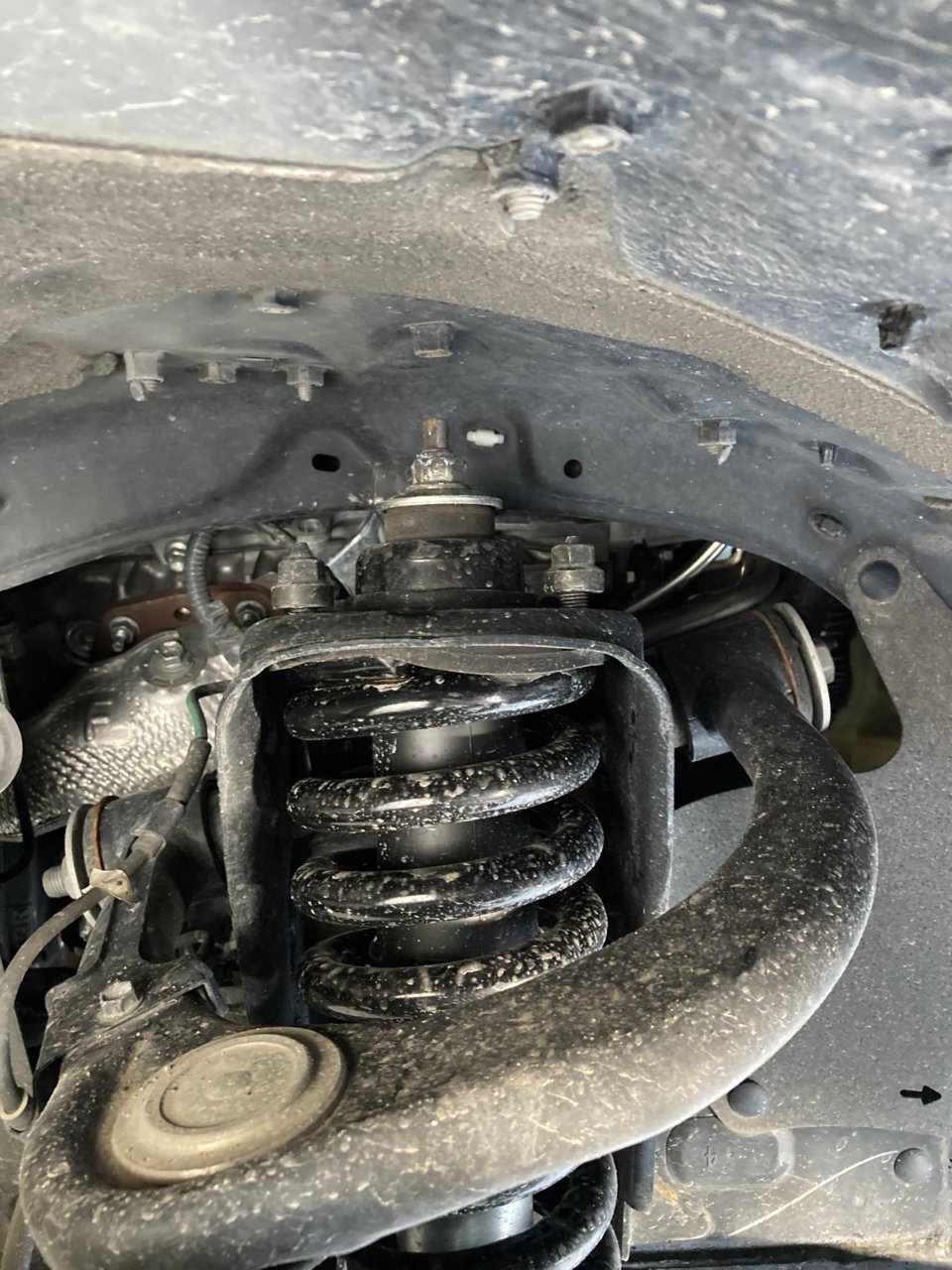

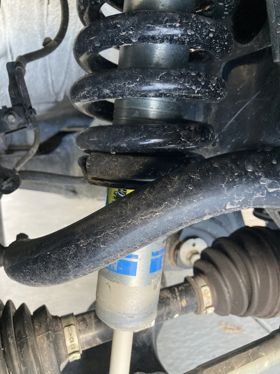

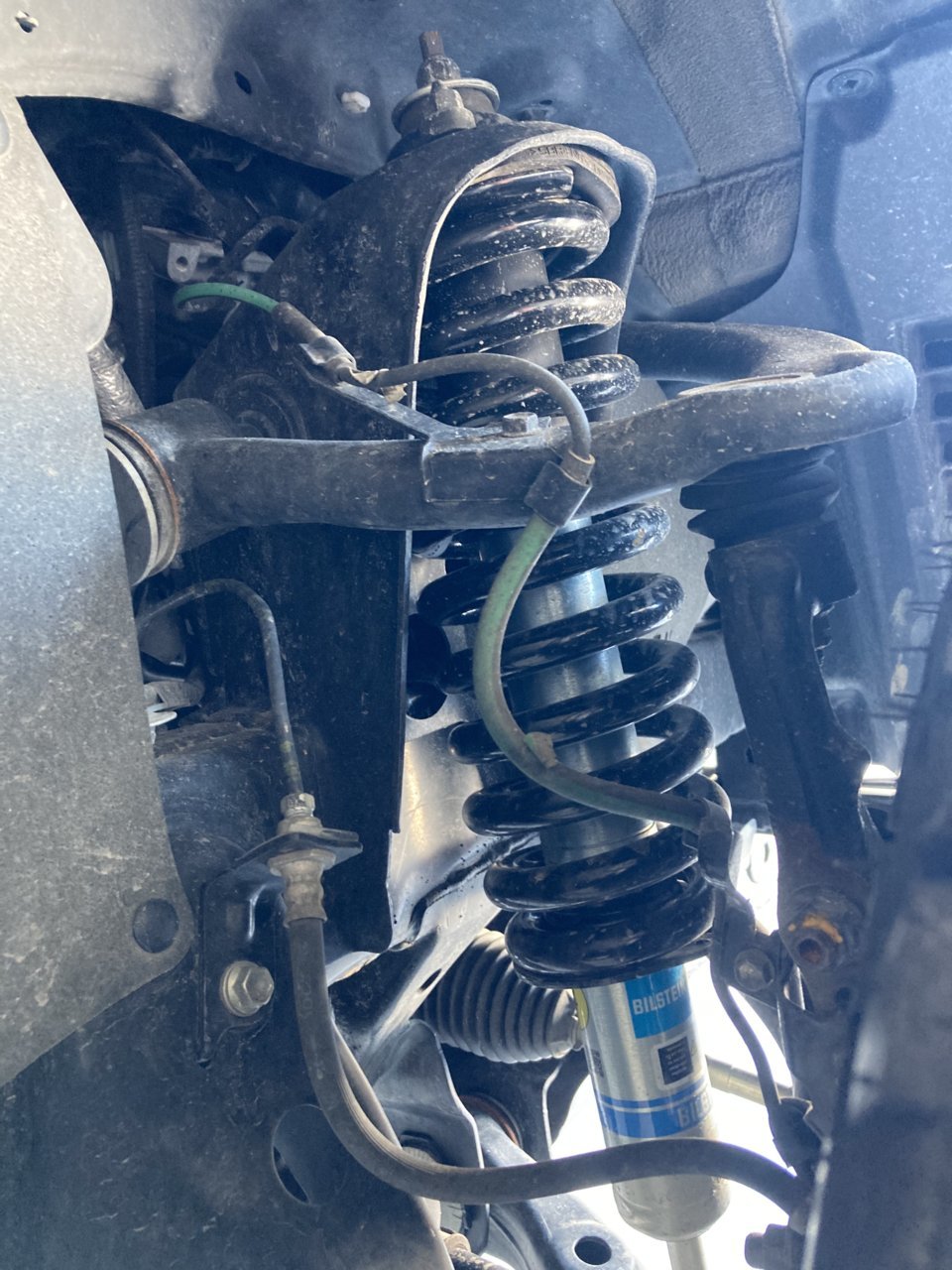

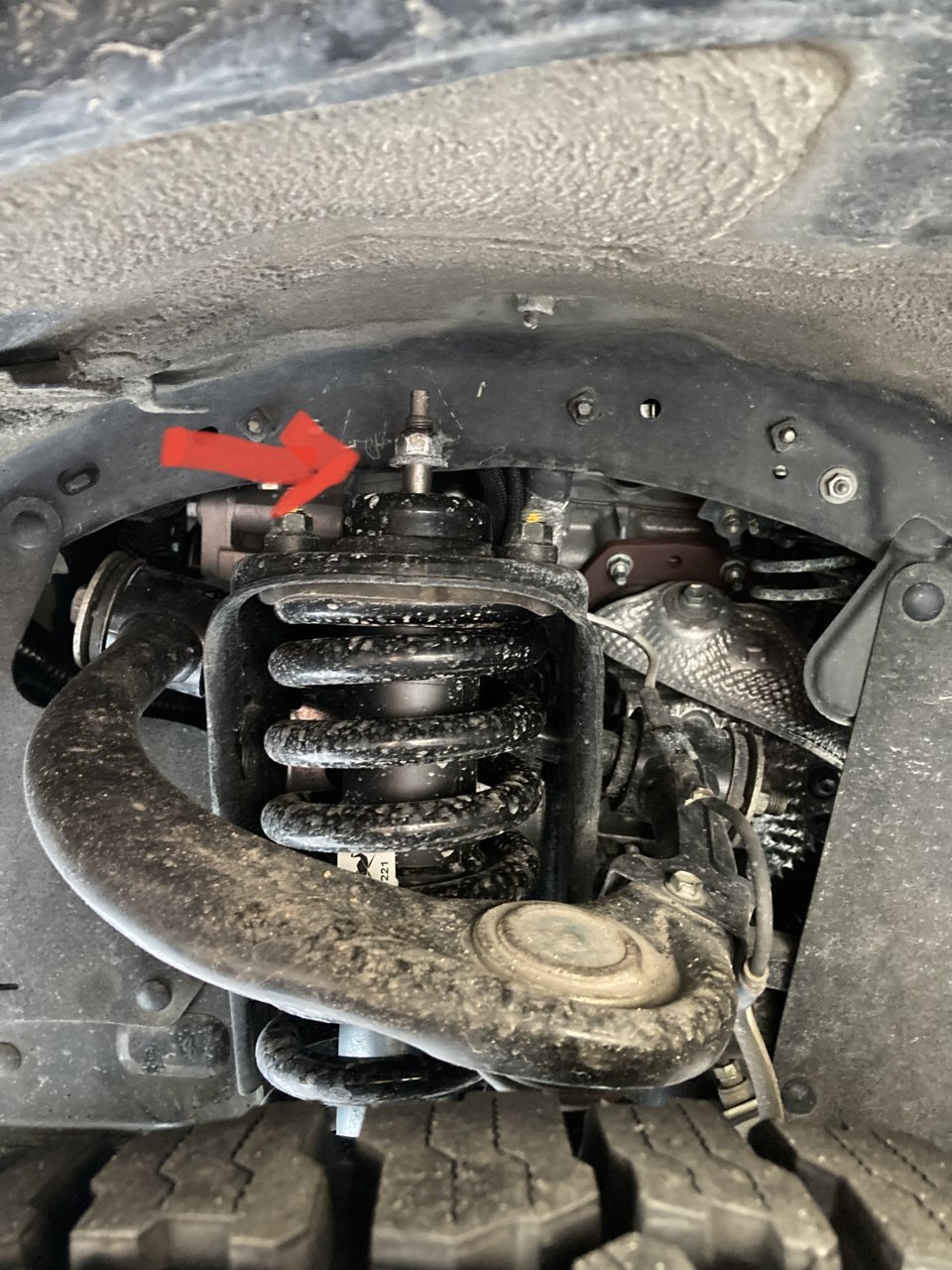

    Great information here. I got 887 installed with 5100 on “0”. After install, going over speed bumps or through gutters, I’m getting a “dull popping sound. It seems like it’s happening not when the coils compress, but it seems more like when they are extending on the rebound. (Sorry, my terminology probably sucks). I didn’t do the install, first time truck/lift. So I don’t know what to look for when inspecting. I’ve posted a few pictures. One thing that stood out to me was the “top hat” missing on one of the sides, is that normal? Thanks for any advice/help. I have a video of the sound, but not sure how to upload video if it’s possible.

  15. Apr 6, 2023 at 3:09 PM
    #795
    Ricardo13x
    Ricardo13x YT: @UrbanOpsOffRoad IG: @urban.ops.offroad
    Feb 9, 2020
    #318785
    2,863
    Upland, CA.
    05 OR DCSB ProRunner(4x4 conv.), Chevy 63”s, NWF EcoCrawler, 35”s
    Random stuff. Oh! and converted to non ADD 4x4.
    What the actual fuck is going on here. You’re missing your upper bushing!
    Go back to that place to get this fixed asap! Like now!
  16. Apr 6, 2023 at 3:13 PM
    #796
    Ricardo13x
    Feb 9, 2020
    #318785
    2,863
    Upland, CA.

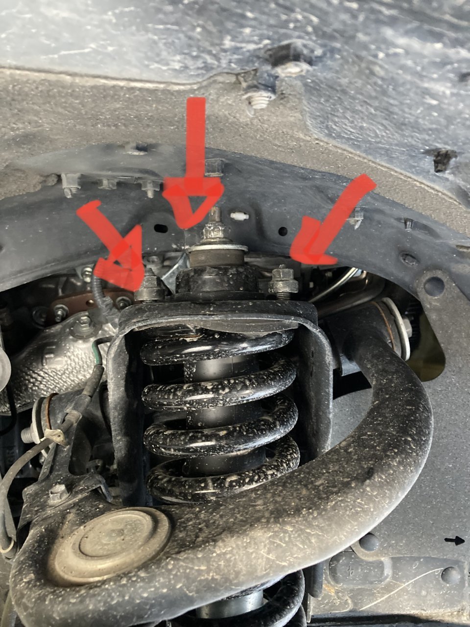

    Dude wtf!!! Your shock is loose! Do not drive it unless you tight those top 14mm nuts!!!!
    Scrat and KevKev_22 like this.
  17. Apr 6, 2023 at 3:14 PM
    #797
    Ricardo13x
    Feb 9, 2020
    #318785
    2,863
    Upland, CA.
    Dude both sides are the same! Who worked on your truck?! We got to put them on blast level 3!!!!!
    KevKev_22 and bmgreene like this.
  18. Apr 6, 2023 at 3:17 PM
    #798
    bmgreene
    bmgreene Well-Known Member
    Nov 18, 2009
    #26145
    2,845
    Brian
    L.A. Westside
    2010 PreRunner V6 SR5/OR
    Alcan Leaf Packs, OME884 Coils, 5100 shocks, U.S. Offroad Winch Mount w/Winch, Trail Gear Rear H/C Bumper, Prinsu Cabrack, DIY custom in-bed storage/sleeping deck, Sway bar delete, hidden "snorkel" intake mod, In-dash CB, Bestop Supertop, Undercover Swingbox, hood lifters, assorted lights and front spotting camera
    Both sides have "top hats" (the fitting at the top of the shock/spring assembly which is also the part that bolts to the vehicle chassis), but one side is missing the upper damper/washer and you should take it back to the installer to get that fixed ASAP. The "popping" sound is probably the nut on the shock piston impacting the top hat fitting as the suspension re-extends after compressing on the bump, which is something that could eventually damage the shock, the fitting, the nut, or any combination of those parts.
    Also, like Ricardo said, the three nuts that are holding the whole assembly onto the truck should be tight on the side that does have the damper/washer in place.
    It might not be a bad idea to go to a different shop to fix all that, and maybe also have them check out the rear install while they're at it since whoever installed that for you does seem to have made critical mistakes on both of the two corners you posted pics of here. I don't know that it's safe to assume they got the other two corners right.
    Ricardo13x likes this.
  19. Apr 6, 2023 at 3:33 PM
    #799
    Ricardo13x
    Feb 9, 2020
    #318785
    2,863
    Upland, CA.
    You should be asking for an installation fees refund and possible damage of a shock. I’m still impressed by the lack of care. Wow!

    Thanks for the quick reply guys. I feel like a complete dummy.
    I’ll be getting it fixed asap.
    So it’s safe to assume, that if installed correctly - there shouldn’t be any sort of noises like that during a break in period or anything?
