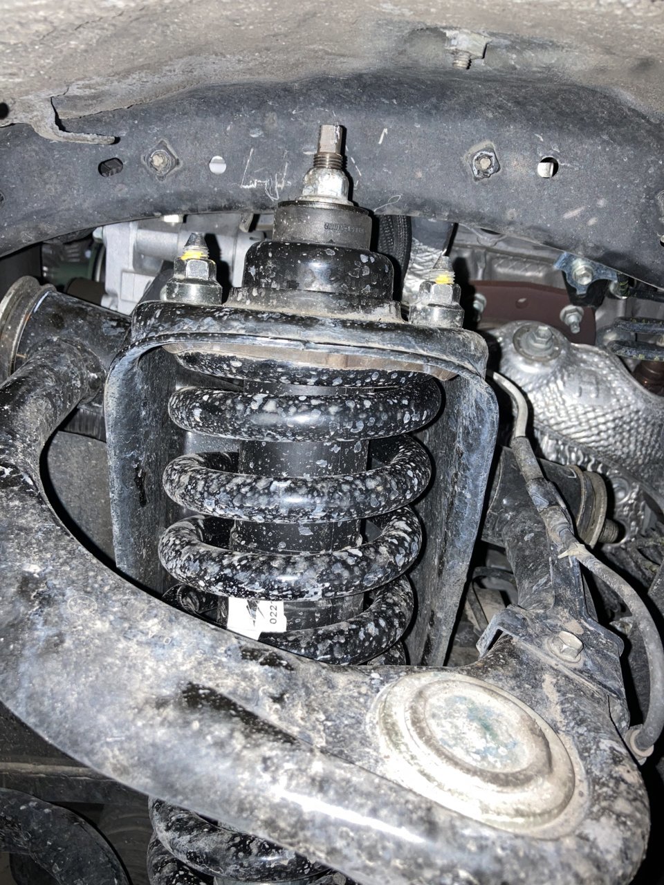

    No noises, no break in period, nothing! Dude seriously it could have been a very very very bad experience for you or anyone on the road if that shit would have colapse! It’s not your fault so don’t feel like a dummy, someone you paid your hard earned money should have completed the job. Dude this is some serious shit man.

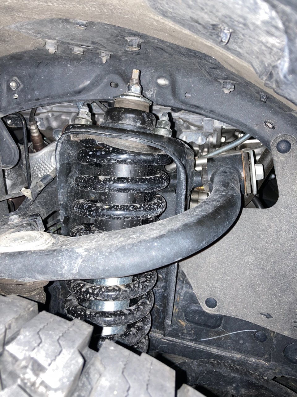

    On the first picture, where I’m missing the upper bushing, should that nut move at all if the bushing is there? On the other side, I have the bushing, but I’m able to wiggle that little top nut if I twist lightly with a wrench - which actually moves the whole shock (not coil).
    Or should it all be locked down right without any movement? Thanks!

    It might be possible to wiggle the nut because you're actually wiggling the shaft with it (or should be at that point). The piston shaft of the shock has some wrenching points (or a hex key/torx socket in its end) for when it's time for the nut to be removed during replacement/installation but that shaft should be fairly free to rotate relative to the "body" of the shock which attaches to lower control arm (at least on a non-adjustable shock unit).
    The time to worry would be if the nut can be turned by hand without moving the shaft

    None of them are supposed to move, get them as snug as you can with a 14mm if you plan to drive it back to that shit shop that put you at risk.

    I believe that’s what he’s referring to. Look at the pictures with the arrows. Those MF actions had the potential of hurting this dude.
    edit: less dramatic still a shit show.

    I though he was talking about the side that had the bushing in place, not the side with the giant gap. If the bushings/washers are in place and the nut is locked in place, a little wiggle in the piston shouldn't be dangerous on a 5100 since the nut isn't loosening as long as the shaft is moving with it.
    Without knowing who did the install, it's hard to tell intent vs incompetence. Either way, nobody should be taking a vehicle to them for work based on those pics and that truck was handed over in an unsafe condition.
    I had a dealership give me my car back with the front strut brace uninstalled and laying on top of the engine once though, but I knew from the rattle to turn around within 3 seconds and date it back into the service department.

    I’m not saying they had the intent of hurting him, im saying their actions had the potential of. At the end of the day if you are taking someone’s money for a service, then provide the service. Its unacceptable either way.

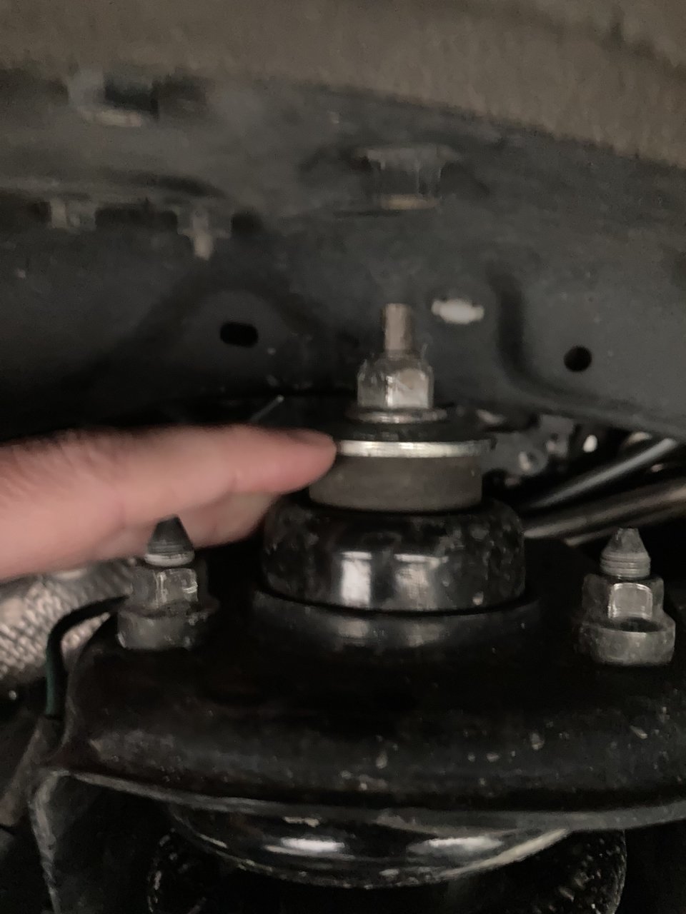

    I appreciate all the info. What I was referring to was this piece. It’s like a washer I guess. I can freely spin that currently. But when I try to tighten the nut above the washer to it moves the whole shock inside the coil, so I can’t tighten the washer down. Should the washer move?
    Sorry for all the questions, I’m bringing it in within the hour so trying to find out what is normal so I can spot check it after for peace of mind. Thank you!

    Nothing in there should be able to move by hand force only.

    Just wanted to share an update. I got all of the correct parts installed and everything snugged up. I feel much better. Thank you all for your responses. It’s sincerely appreciated.
    Ill be keeping an eye on it for the next little bit though just for peace of mind.

    You may need to grip the flats on the top of the shaft with something (Billstein's instructions sometimes say use a crescent wrench, but I prefer vicegrips) to stop it from turning with the nut while tightening; this is where a ratcheting box-end wrench gets to be very useful.
    There shouldn't be any gap between the washer that you're pointing at and the nut (above that, attached onto the threaded part of the shaft), but if the washer turns with the nut while it's being wrenched tight that's not a reason to worry
