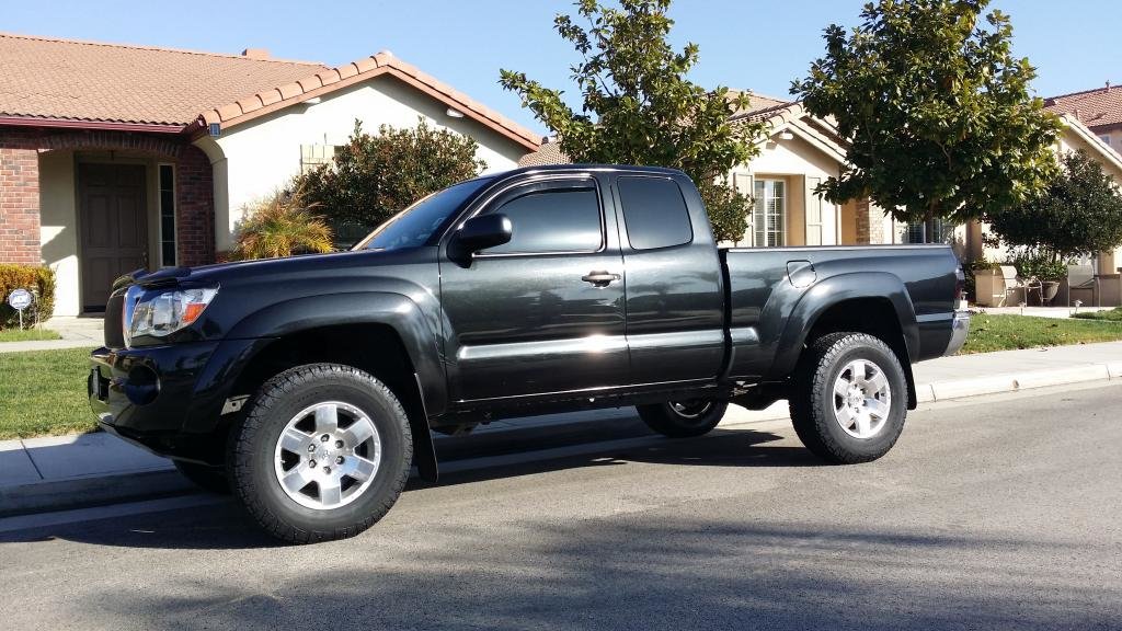

    265/70/17 BFG RT's, FJ 17" rims with 1.25" spidertraxx Debadged, HID's, URD short shifter, Bilstein 5100's in the front, TSB and 1" block rear, URD TCAI with maf calibrator, JBL long tubes, DT Y pipe, Gibson exhaust, Walbro 255 fuel pump, Pioneer stereo, Bak flip G2 tonneau, TRD skid plate, MB Quarts all around with dynomat, Viper Alarm with motion sensor
    This is why I'm staying 265/70r17. I have stock FJ wheels but spidertraxx wheel spacers, have a semi-aggresive tire, and am only 2.5 but I like the look.

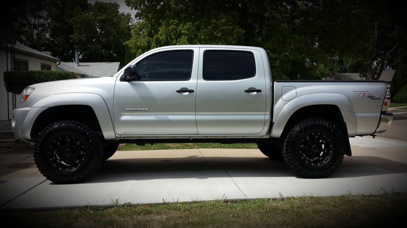

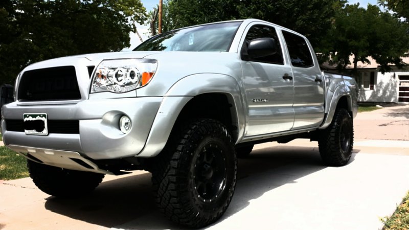

    20150903_133942.jpg 5100 set @ 0 with 887
    285/75/16 Goodyear DuraTracs.
    It rode like a dream with Goodyear 265's highway tread. The DuraTracs roughed it up a little bit.20150903_133851.jpg
