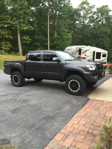

    Lifted it Saturday. Still have stock ucas, but am putting LR ones on this weekend. Wasn't sure on how to remove the ucas, but looks like I have to just bend some metal.
    887's out front, driver top plate spacer with the 4 leaf pack + deaver aal. Sits level, 23.5inches from hub to fender.
  3. Sep 28, 2015 at 9:50 AM
    #103
    Mtnflyer
    Mtnflyer I'm big in Japan
    Jun 28, 2015
    #158366
    5,176
    Las Vegas
    Is the Deaver AAL 1" or 2"?
  4. Sep 28, 2015 at 10:05 AM
    #104
    DirtyTerp
    DirtyTerp Well-Known Member
    Oct 2, 2014
    #139509
    1,854
    Randy
    Freeland, MD
    '14 DCSB MGM
    1.5". It's the one that comes with the bundled kit from headstrong.

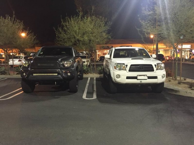

    Bilstein 5100 RHA/OME 887s/LR UCA's, 5100's in rear w/ Wheelers 3 leaf progressives, wrinkle black/silver TRD front skid plate, emblem removal, LED third brake light, remove/replace TRD Sport stickers with custom black TRD stickers, tail gate lock mod, BLHM & BLTM, VLED 430lm DTRLs, VLED LED rear turn signals, LED headlights from BadAssLED's, black mesh grill, AVEC LED light bar behind grill, AVEC LED light bar lower valance, 91' Cadillac Deville Horns, Hood Scoop LED from C4 Fabrication, Procomp 5001's Satin Black, FlowMaster Dual Exhaust American Thunder, Blue Sea Aux Fuse panel, AVEC 12" ultra slim light bar in bed, Undercover Flex bed cover
    For what it's worth/shits n giggles: OME 887s/5100's at 0. 3/8" top spacer on both sides and 1/4" top spacer added to driver side to even out the lean. 5100's in rear. Wheeler's 3 Leaf AAL with OEM 3+1 left in place. 17s with 265/70/17. Comparison next to my wife's stock 2006 with same size wheels and tires.

    Oregon
    ^^ Looking Pretty Sweet!
