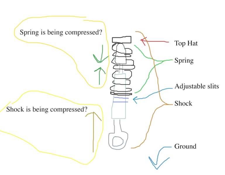

    When I had just the 887 coil, and 5100's set at 0", The ride was smooth but my truck was raking.
    Excuse my poor illustration skills..
    1011or_07_+bilstein_5100_leveling_shocks_toyota_tacoma_2wd_prerunner+struts.jpg Screen Shot 2015-11-09 at 1.02.29 PM.jpg
    I do not want to change out my springs again, so what can I do?

    If you don't want to replace your springs then set them back to the 0" setting and add a spacer on top to give you the desired height. I personally like rake but I have a constant load on my truck (shell, rack, tent, etc). I also pull a boat and load a bunch of camping/hunting gear in the back so rack is required to support all that BS

    3" longer???? NOPE.
    Only slightly longer resulting in more preload in addition to having a higher spring rate over the factory coils. The lift is primarily coming from the spring rate and not the length of the coil.
    The worst thing that can happen is coil bind followed by the lower spring seat failing.
