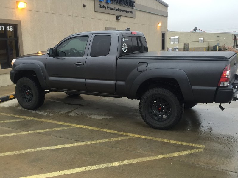

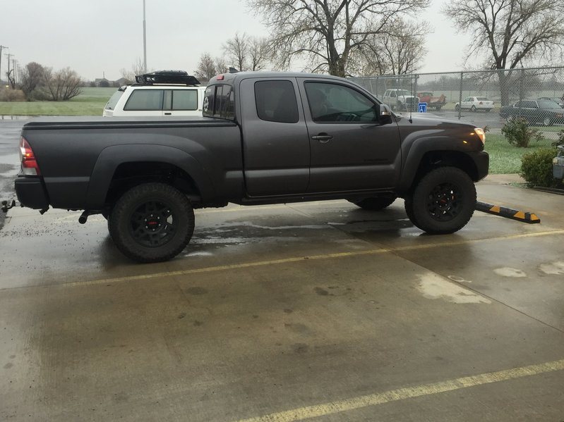

    Some of the things...
    887s/5100s on 0 setting camburg ball joint uppers with the wheelers 3 leafs aal. Rides very Well.
