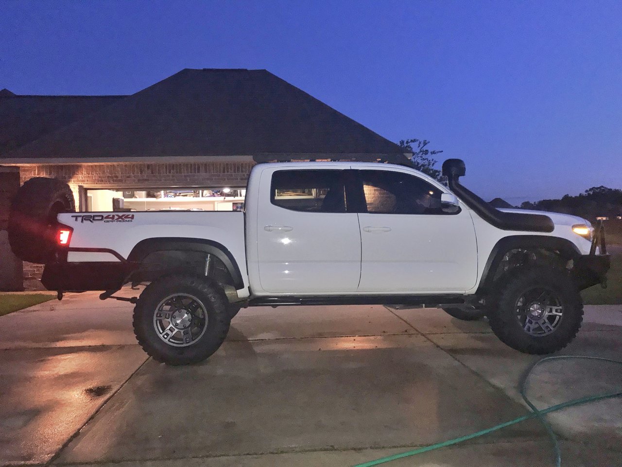

    Just a heads up if you ever decided to swap coils....
    I was told by Headstrong and Wheelers not to run 886s with 5100s. Something about coil bind. I didn’t look into it any further. I just took their advice and went with 886s and Nitrocharger 90000.
    I assume they’ve settled some, but I really haven’t noticed a difference.
    It’s a real shitty picture, but the only side shot I have to give you an idea. I also have 1/4” top plates.

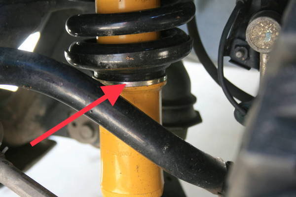

    That washer looking thing.
    It’s 5mm thick.

    Cool. So two of those and a 1/4” top spacer on both sides. I gotta be able to stuff those 35’s soon :thumbsup:

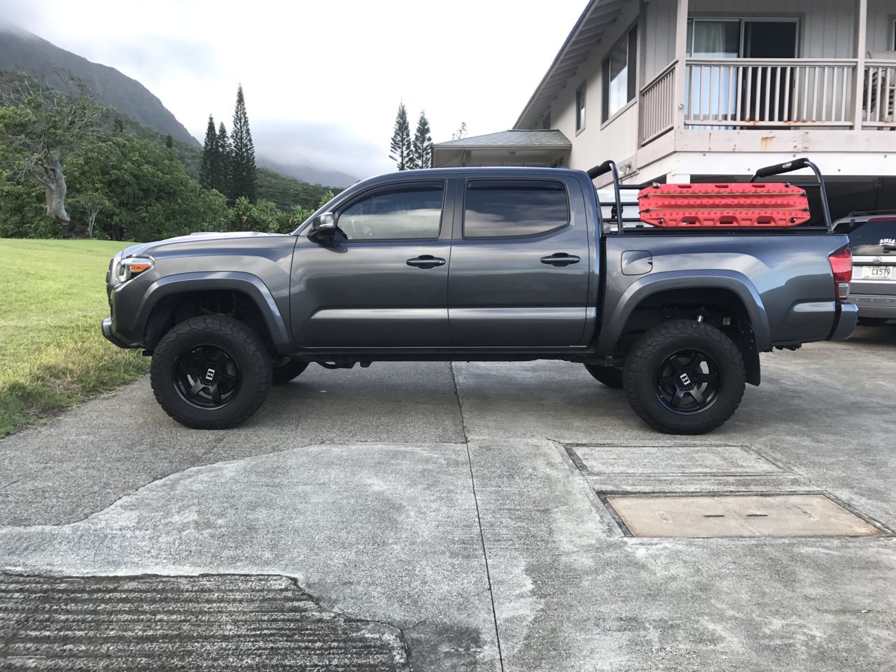

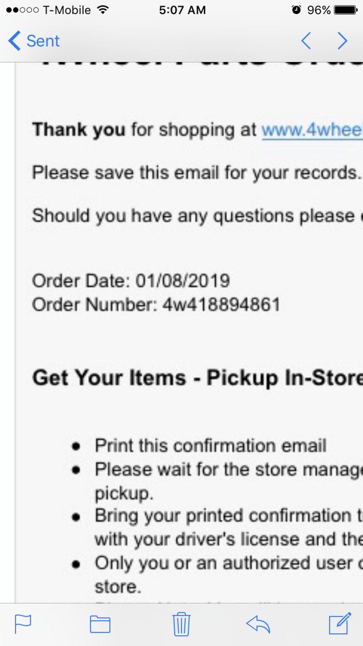

    I have first hand experience of 888s sagging 3/4" after only 6 months of driving on them with absolutely no added weight up front and barely any weight added to the bed.
    Barely on 2" of lift up front with 888 coils
    Order 1/8/19, delivered a month later and installed.
    ERR-Nee and jerzsubbie like this.

    2,064
    Jax Beach, Florida
    Our C59-314 give 2" lift with stock weight on a 16+ Tacoma. If you ended up with more than that to start with, maybe it just took that long to settle? Were you at 2.75" and it came down to 2.0"?
