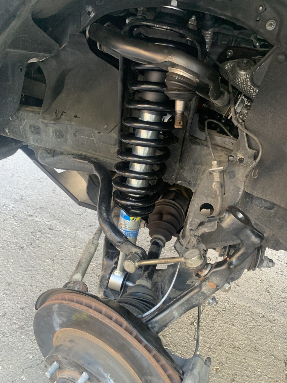

    I’m installing my front Bilstein 5100 with OME 888 this weekend and have hit a snag. I’ve got the shock mounted but there isn’t any travel in the suspension. Hard as a rock.
    Any ideas what’s causing this?
    Much appreciated.

    Thanks. I do have the weight of the truck on it. No movement. Moves fine without shock and spring connected.

    Assuming the truck rests on the stands.Jack the lower arm. Use a long pry bar to push the upper arm down.

    Get a jack under your lca and raise it up

    Unbolt your lower control arm from the knuckle will be two bolts underneath don't touch the middle one. Attach the knuckle to your upper control arm. You may need to use a bar to pry the UCA down to get in the knuckle than crank it on. Then jack up your lower control to reach the bottom on the knuckle. It's really hard to put the UCA on that way.
    Edit: This all assumes you have a floor jack to lift the knuckle/LCA. I am surprised that you can't jack the LCA as it stands now?

    1. Disconnect the sway bar end link from the spindle.
    2. Jack up the lower control arm to put some weight on the spring. You might lift the truck off the jack stands. Be prepared for this in case the truck does want to fall. I’d probably put the other side tire back on.
    3. Use a pry bar between the uca and the spring to pull it down closer to the spindle.

    It does look like OP forgot to disconnect.

    Worried for that exactly seeing as we have the UCA detached for a strut swap. Rather he connect the UCA first then do the LCA to the knuckle.

    Loosen the UCA main bolt. I’m sure the UCA bushings are binding and that’s part of your problem. I’d also recommend loosening the cam bolts for the LCA. Both issues combined could cause the issue you’re describing. you’re not just fighting the suspension from compressing, you’re also fighting the bushings at both control arms.
    Your fist pic showing the UCA floating up in the air shows that the bushing is holding the the UCA in the “ride height” position. Once you have everything bolted together you can torque it all with the tires on the ground at ride height.
