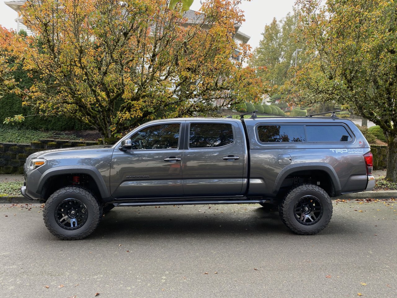

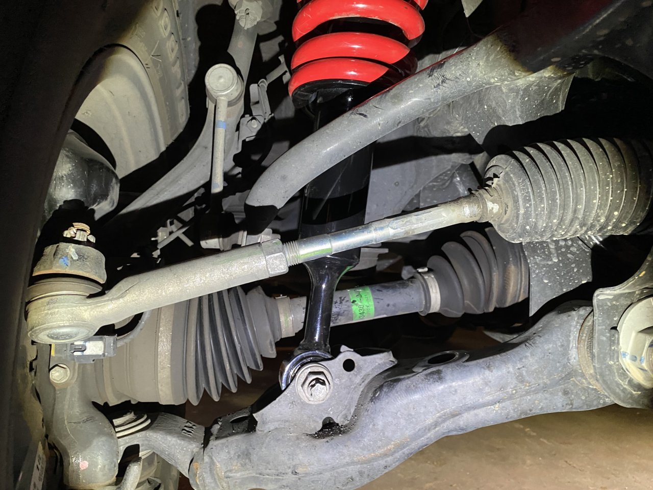

    I ended up going with a completely new set up to fix the OME 888 sag. I went with Dobinsons GS59-220 shocks and C59-352 coils. I got the lift back that I lost with the OME 888 coils and the ride quality I think is much better. The front end does not dive when braking as much anymore. I gained about 1.5" of lift on each side.
    One concern I have is the angle of the CV axles. Here is a picture of one side. Let me know what you think. I do have the differential drop as well as a carrier bearing drop kit. With the OME 888 and Bilstein 5100's the axle almost went straight across.
    Here is a picture of the truck with the new lift in the front.
    Aaronparker001 likes this.

    Hey mate, looking at getting those same coils. How does it ride? And have you gotten a front bumper of any sort? I'd be going that same route with a heavier bumper.

    I do not have a front bumper yet although I’d like to get one. I would say it rides a little stiff without any weight in the front, so with some weight it would ride about perfect. No sag with these coils like I had with the OME. I think these coils are much better than the OME and would be a great way to go
