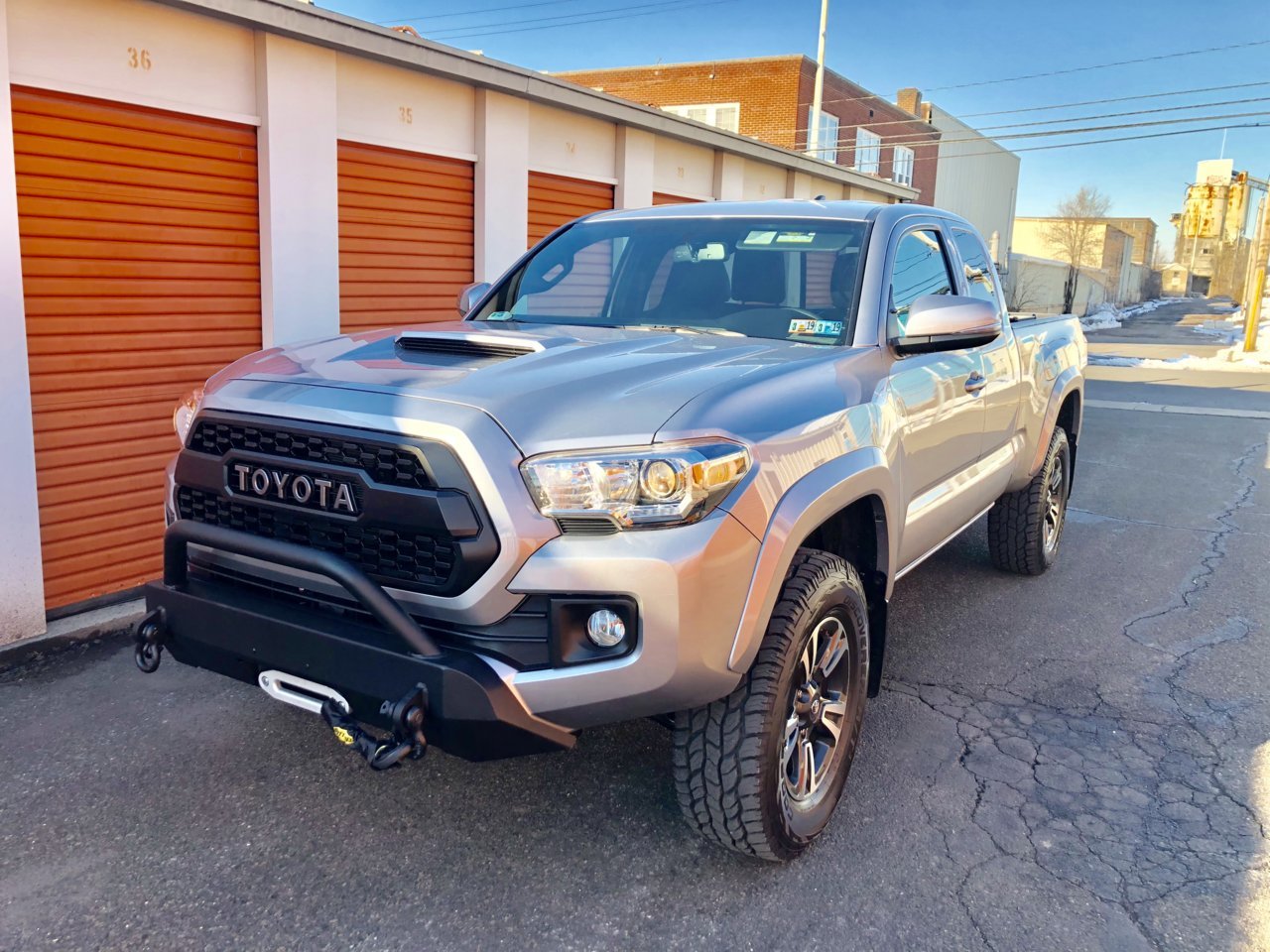

    I’ve considered going to OME coils but decided to leave on my stock coils at 1.1” with front slim bumper and winch. Settled maybe to 1/2” lift and AAL in the rear.
    You could always go back to stock coils and raise it a little.
