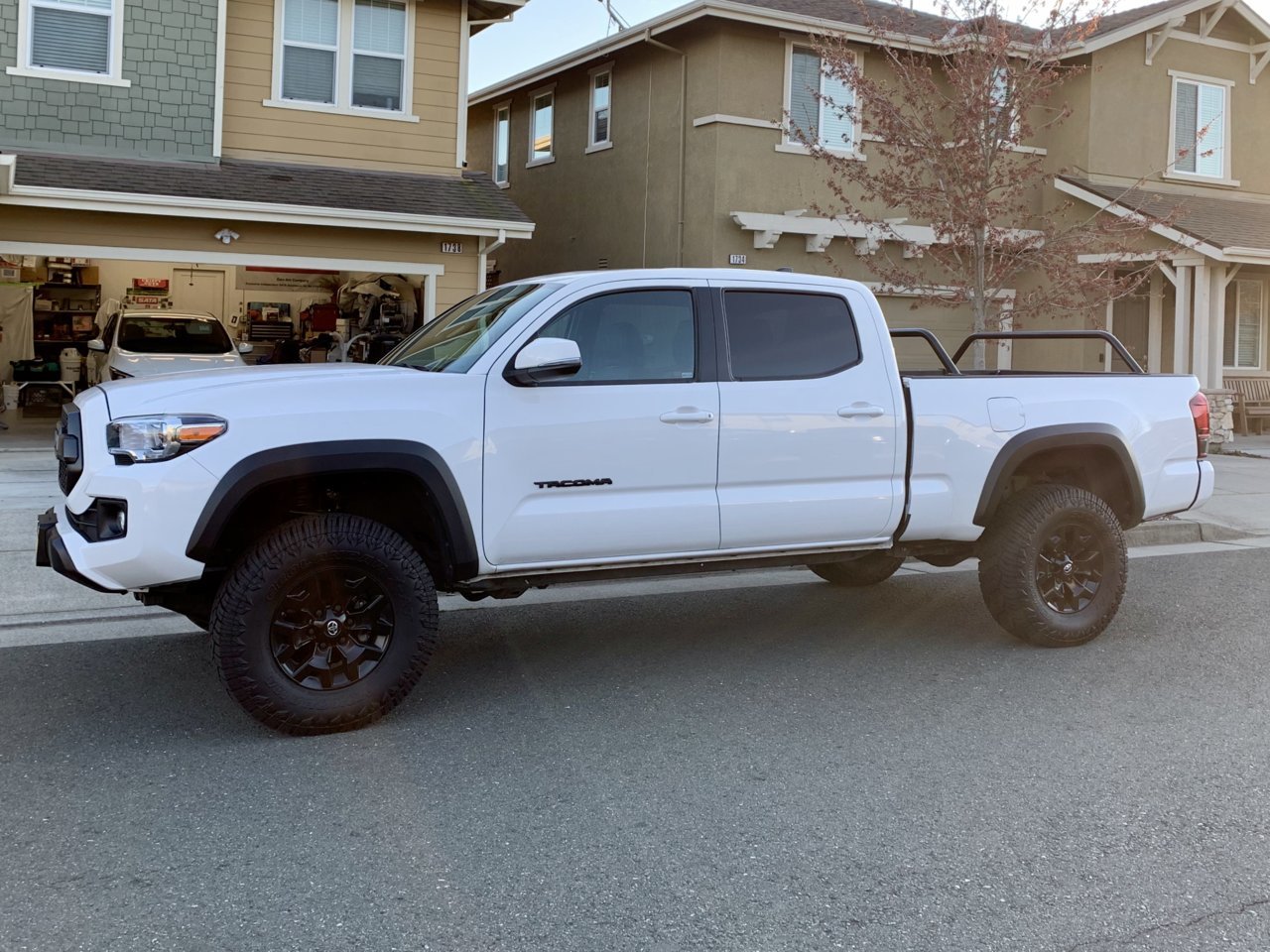

    5100’s 1.5” up front 4th setting 1.5” rear AAL. Factory rake cause it’s a truck. No sag stock coils. Ride is great IMO. Was on the fence with getting those OME COILS. Glad I didn’t. Subtle lift is what I wanted. Just my 2cents

    I’m at 22” front center cap to fender on 33” tires. Seems extremely low...

    I agree. With the 888’s you should be closer to 23.5-24”. This is what ultimately persuaded me to go with the Eibach kit. No sag. I kept reading one report after another about the OEM coils not being able to handle the front end weight of the 3rd Gens.

    You shouldn’t be over 23” without long travel.

    Not at all to short. 5100’s are designed to work with stock coils on our trucks. I’m using stock coils with 5100’s on 4th setting. No sag ride is great. I learned a lot on here from members. Went with this set up based on needs. Light trails camping work etc. There are a lot of great set ups out there. As for 5100’s great lift IMO.
