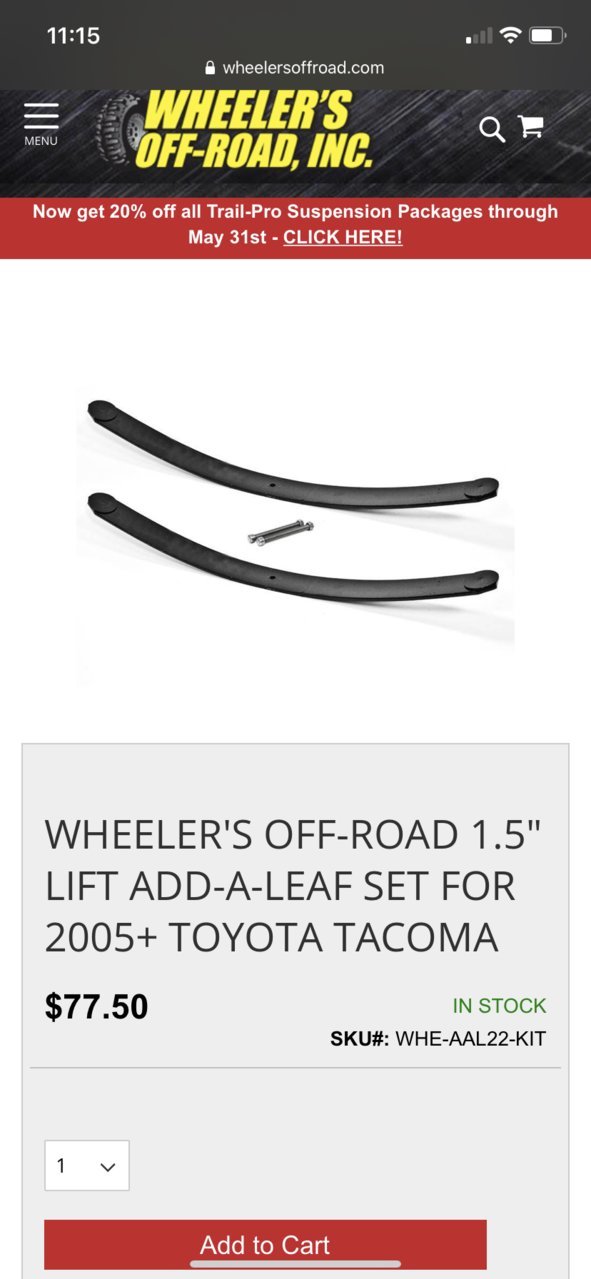

    I really like your stance with yours. What rear aal did you use?

    Thank you bro. I used a 1.5” aal from wheelers. IMO aal is a little stiffer but I dont mind it at all. Not soft at all. It’s a truck love to use it.

    nice. Is this the one you used?

    Yes it is
