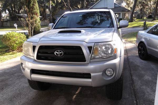

    I got my OME kit with 9000's/885 assembled from Toytec and OME rears/aal. I was planning on doing the install tomorrow with a buddy, but thought I would look over the truck/undo some bolts to see how difficult it would be. Well, that turned into just installing the fronts myself this afternoon. Here is pretty much how it went:
    3 hrs. from getting tools out to clean-up completed
    1: Disconnect driver's side sway bar end links
    2: Remove the two bolts holding the LCA ball joint to hub
    3: Remove engine bay splash guard
    4: Disconnect tie rod end w/ tie rod end puller (really easy)
    5: Remove sway bar brackets so it can be moved around
    6: Remove lower coilover bolt
    7: Remove 3 upper coilover bolts
    8: Slide coilover out
    9: Put new coilover in & finger tighten upper 3 bolts
    10: Put bottle jack upside down (base against inner fender) & "jack" the UCA down until you can get the lower coilover bolt in place
    11: Do the same thing on the other side
    12: Reassemble and torque everything to spec.
    After seeing all of the difficulties that a number of people have had, I was very worried about this process. As I was putzin' around and the stock coilover almost fell out, I thought why not try.
    Here are some pics
    Driver's side coilover in
    Passenger's side
    In progress
    Final Product
    Now my question is this really:
    I have not done the rear (TSB is installed) and the truck comes out almost dead level, should I install the aal or just skip it. I really don't tow (maybe once-twice a year).
    Measurements (center of hub to fender):
    Pre-lift
    Front Driver: 20
    Front Passenger: 20.5
    Rear Driver: 24
    Rear Passenger: 24
    Post:
    Front Driver: 23.5 (3" of lift + trim packer.... needs time to settle)
    Front Passenger: 23.5
    Thank you to all of the members that have posted their antics on here. I think I have read almost all of the OME install threads and it was extremely helpful.
