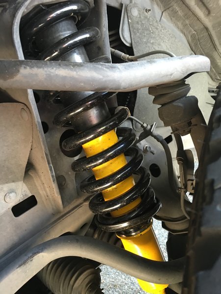

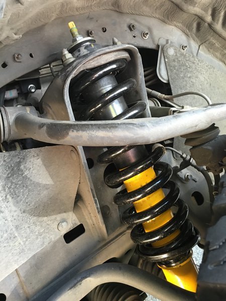

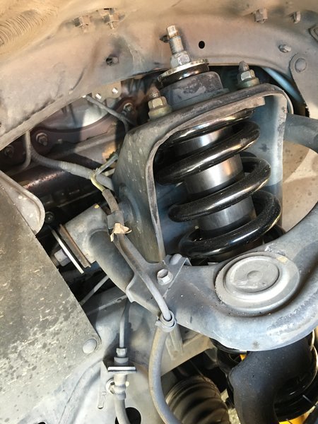

  14. May 31, 2016 at 4:33 PM
    benzy
    benzy [OP] Well-Known Member
    May 4, 2016
    #186122
    656
    Bay Area, CA
    2006 DCSB TRD OR
    Simple OME/884/AAL lift. 32” WP’s
    One odd thing is the top nut spins on one side. But the nut is tight enough to compress the bushing. See photos. Does this indicate anything?image.jpg
