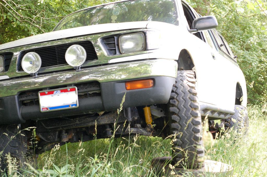

    My hand was forced when I wrecked it and broke the spring on my camburg coilovers, looks like I may have picked up an inch or so of lift over where the coilovers were set at and I still need an alignment but it seems to do the job!
    Also took me 3+ hrs to do the passenger side and a whole 35 min to do the drivers side...barely had time to drink my beer lol
    And what's a thread without a picture of my success!?!?
