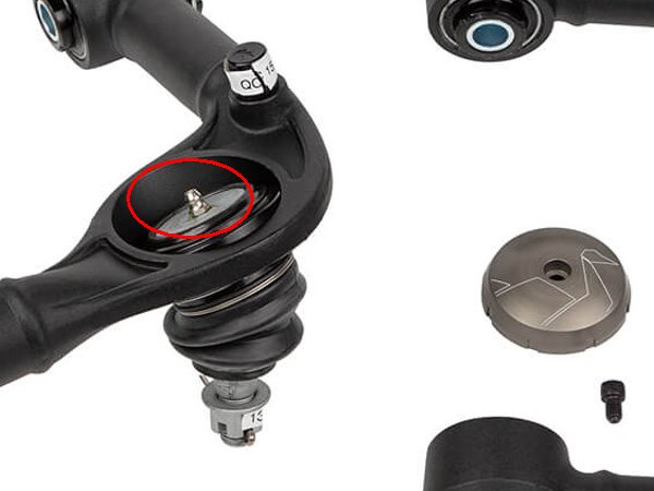

    Hey guys, today I decided to grease up the truck and upon going underneath I found that my upper control arms OME did not have any zero fittings. The control arms are a part of the OME BP– 51 kit and I thought that they would need some sort of grease. Can anyone please confirm for me if these control arms do not need grease? I also learned that my driveshaft doesn’t have zerk fittings either. Might’ve got all the stuff for no reason lol. I am a bit confused.

    :facepalm:
    :evil:
    • Heavy Duty Greaseable Ball Joint w/OME Ball Joint Protective Cap
    • GIIRO Bushings, Free-Pivoting, Grease-Free and Maintenance-Free

    The ball joint needs grease. The bushings don't.

    remove the cap and then grease.

    yes the UCA's there should be a grease zerk
