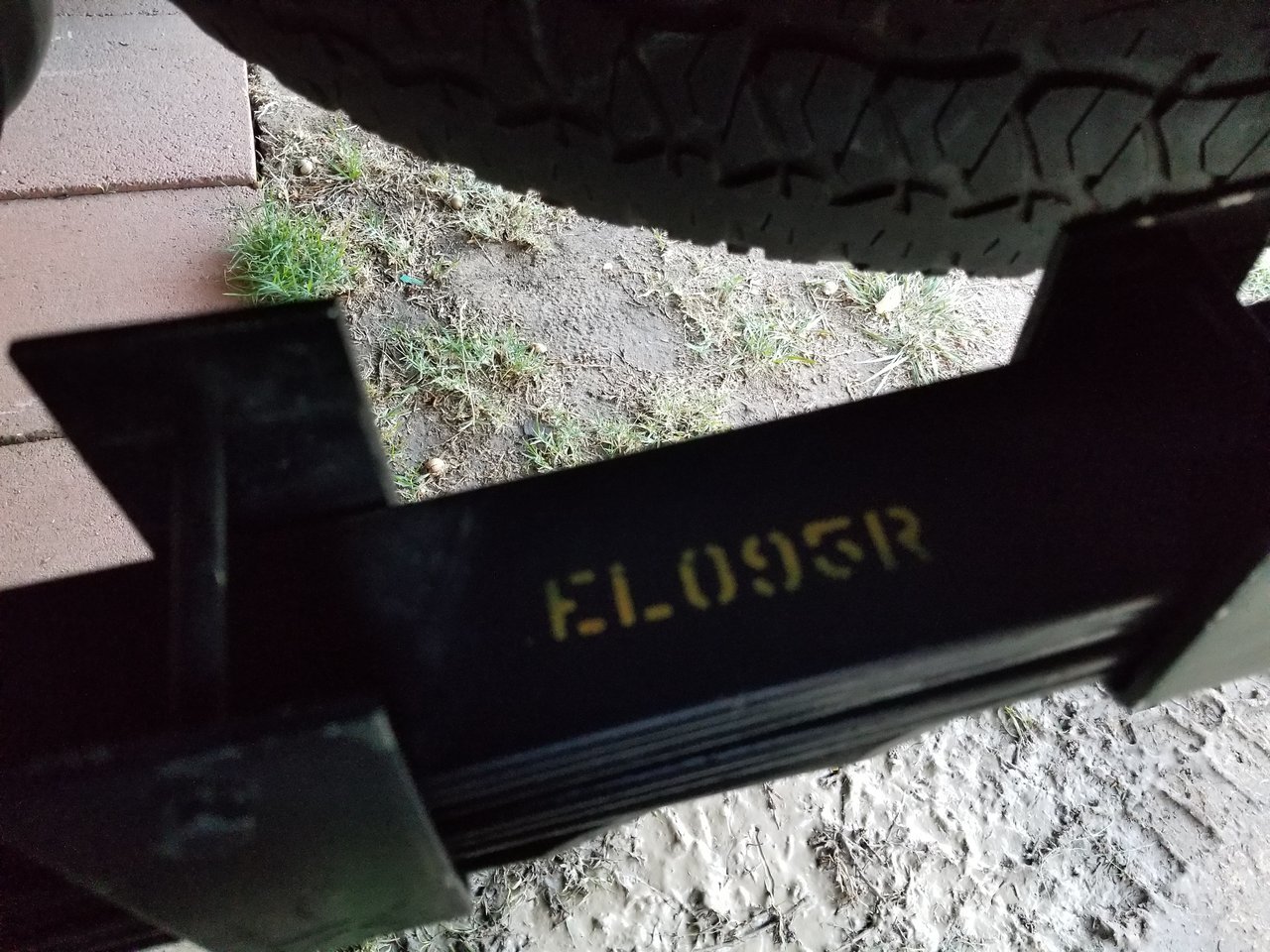

  16. Dec 15, 2017 at 11:39 AM
    #196
    Volksparts
    Volksparts AKA The Un"Official" Meso Taco
    Jan 13, 2017
    #207523
    899
    Dave
    San Diego
    2017 Taco Runner
    You probably got the same set of leafs that I have. I can't have a comparative opinion because when I installed the kit I set my fronts at 10mm and the rear sat level even with my camper but once I put a load of stuff in the back, it sagged in rear. Just installed my D29xl add a leafs the other day and looks more level even with the added RTT. Is will try to take measurements later but I'm not currently on level ground. But yeah, again post pics on level ground. I'm assuming you've been driving it some for it to settle also.
    Below is the picture of the leafs that come with the kit right?
