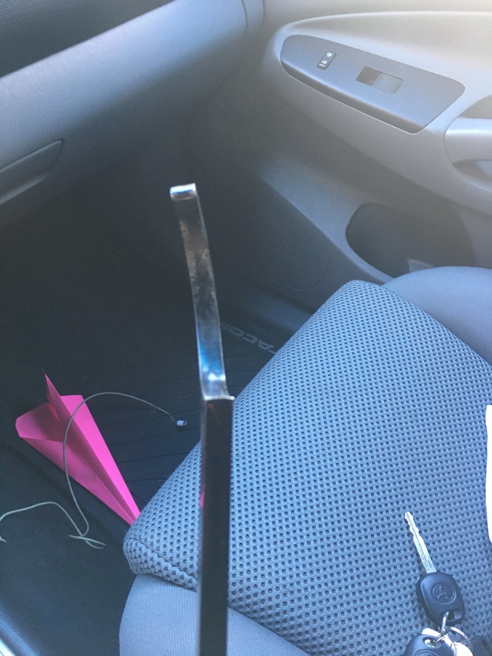

    So I went to adjust my comp and rebound settings today. I have been driving around with them cranked up from the last trip I took. 2 of 4 were extremely difficult to adjust. IMG_0398.jpgI sent ARB an email asking if I should be concerned by this and if they would send me another spanner. I have tweaked the settings 6-8 times in the year+ I've had them on and never an issue. See what ARB has to say.

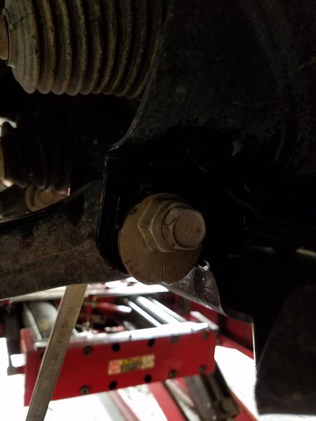

    Why is your alignment cam upside down?
