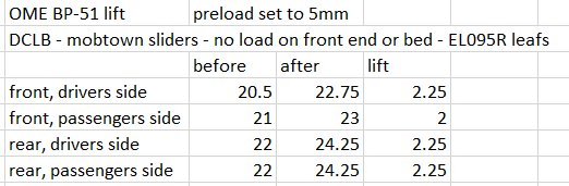

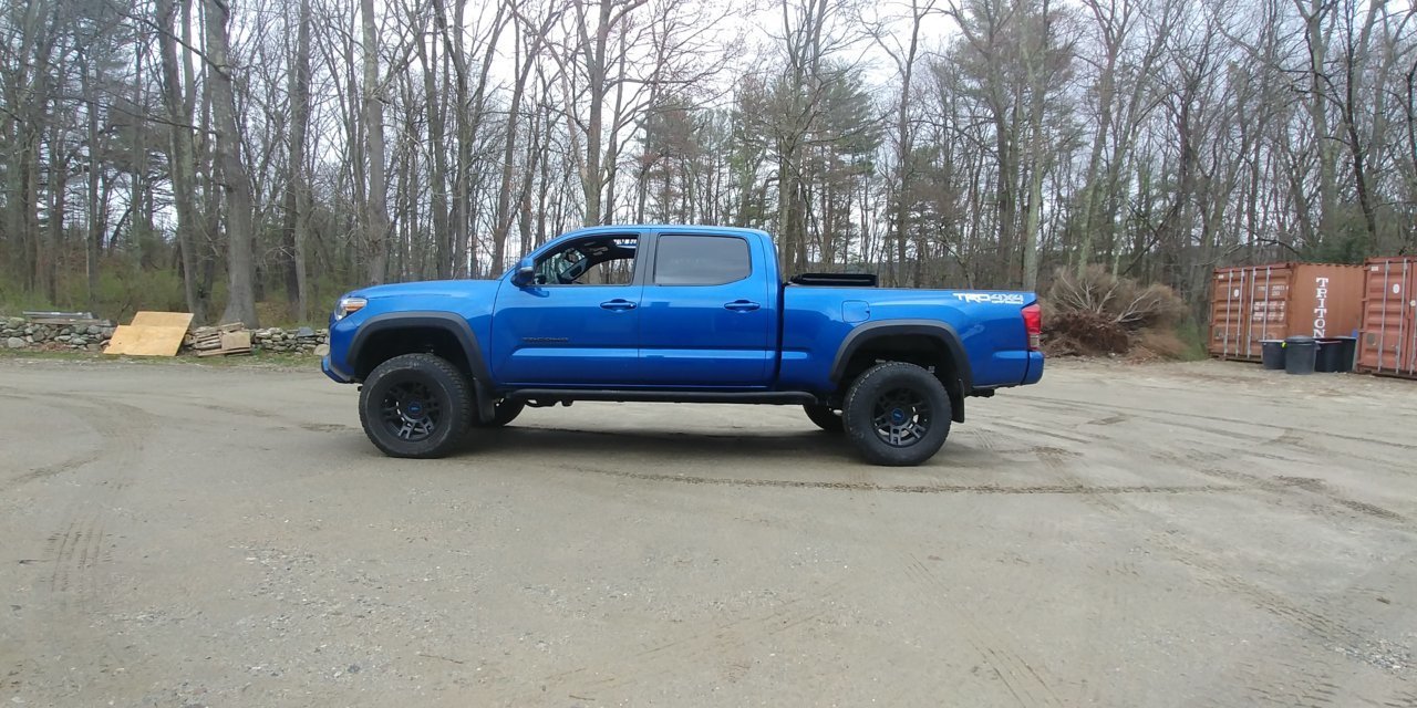

    So my measurements before were just like the OP, 21 in the front and 22 in the rear.
    I set my preload to 5 mm and went with the el095r’s in the rear. I am running just sliders with nothing added to the front or rear of the truck. I was planning on getting 2 inches of lift all around.
    At the 5mm I got 22.75 on the drivers side and 23 on the passengers. I haven’t decided if I’m going to even bother trying to level it at all, with a spacer, or trying to adjust the preload. I really don’t want to take the shocks back out ha ha.
    I ended up getting 23.5 on the drivers side in the rear and 24.75 on the passengers. That’s 1.5 inches of lift vs 2.75.... that’s a crazy difference and I’m still trying to figure it what’s going on. I double checked both lead packs. Both are definitially marked el095r, both are 0 and the arrows are pointing forward, and both have 6 leafs... I’m pretty irritated about it. That’s almost double the lift from one side to the other....
    Overall the whole install took about 10 hours - I also put in the spc light racing upper control arms. Put about 50 miles on it and for it alighed today. Toe and camber to 0 and the caster at +1

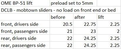

    after letting mine settle out, and fixed the rear end. here are my numbers
    i dont know if im gonna bother doing anything to fix the lean on the front or not. i really don't want to take the shock back out just to adjust it a little bit
