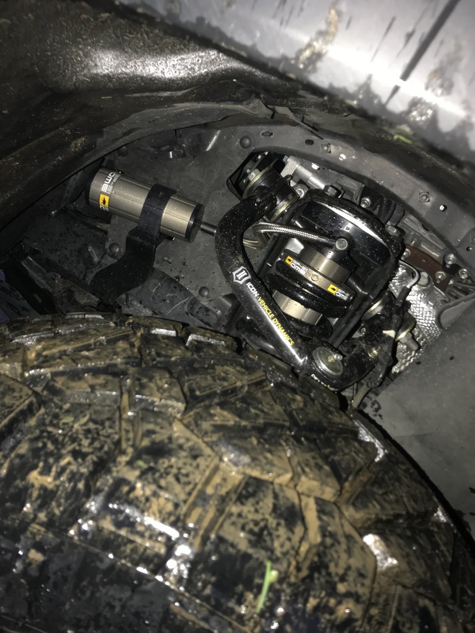

    Anyone know where to get the rubber material behind the remote reservoir that he has stretched? I tried to stretch mine to no avail. I would like to get some and cut mine larger. The guys at Auto Zone didn't have and had no idea where to source it from.

    Are you talking about the splash guard for the engine bay?

    Yes

    They are sometimes called gap guards and wheel well aprons.
    Most people seem to make their own.

    Any idea what type material? I would assume it needs to be heat resistant?

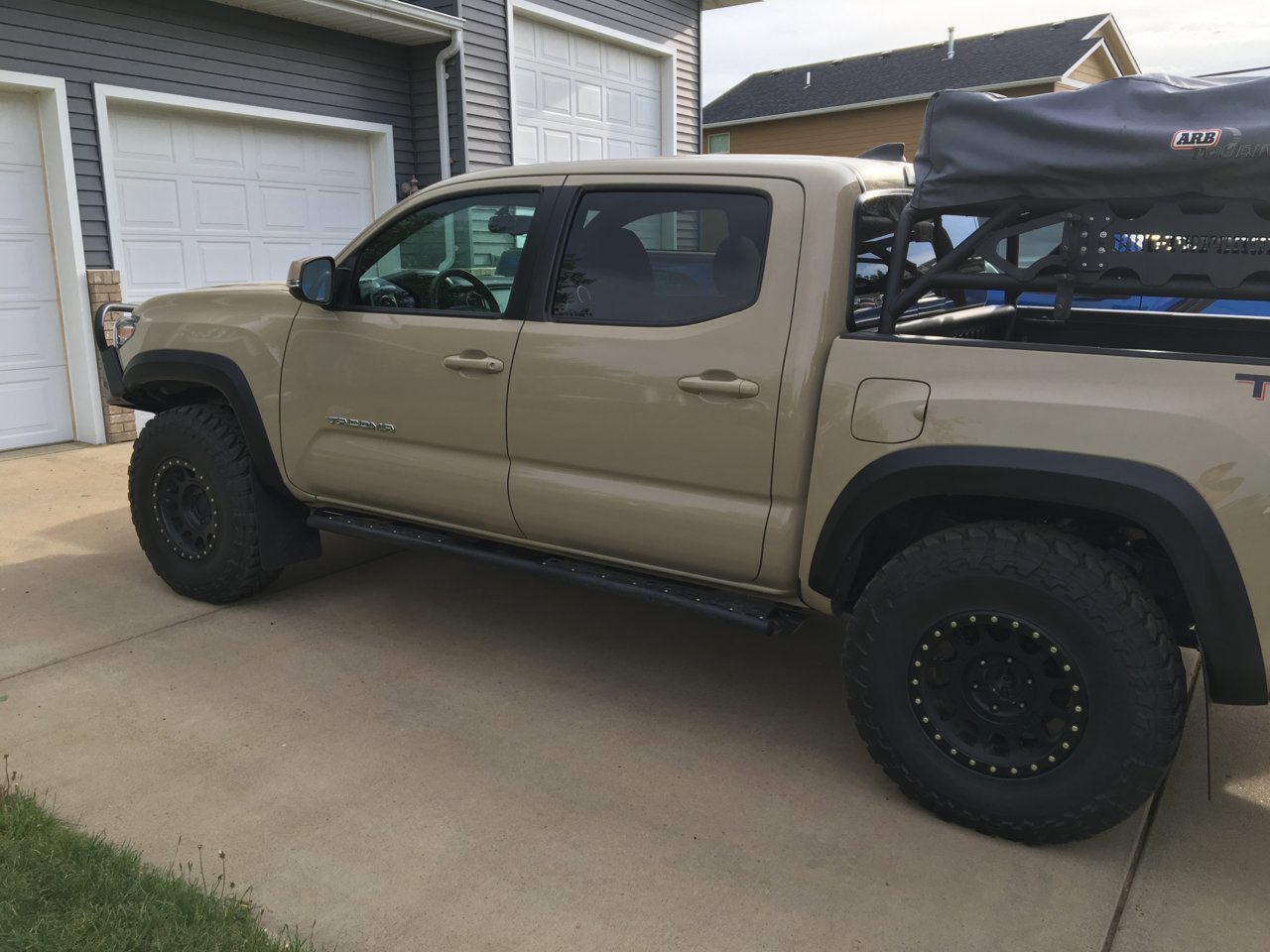

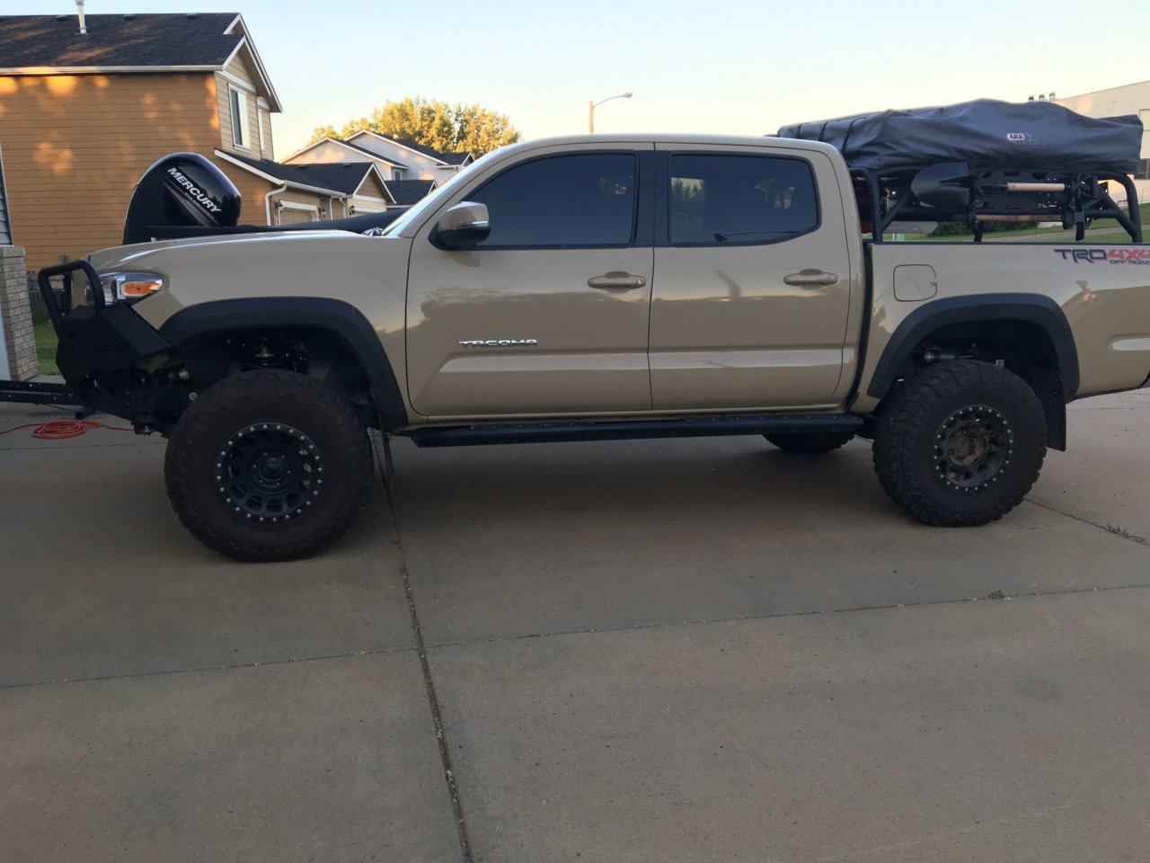

    Got mine back from alignment today. Camburg UCA and Dakar HD leaf pack. 20MM (factory setting) I have sliders,bumper,winch, some lights up front. Rear I got bedrack,rtt, full-size spare, hijack etc...
    First impression leaving the shop, OMG I just wasted $3k. Ride was harsh, felt like shit. Remember reading how people made slight adjustments and all was saved, I’m thinking to myself BS! So I pull over, make 2 adjustments on rebound drive a few miles, I start to smirk, pull over adjust the rears a few adjustments, drive a few more miles. Now I got that shit eating grin. Make 1 more adjustment and it feels great. I will say that the rear is a little rough, but that’s to be expected with out a full size bumper and tire carrier ( on order) on the HD pack. I ended up3/4 of a inch high in the rear. But I prefer it that way. Overall seems like a good kit. Time will tell I guess. Read someone else’s post up a few. I agree the softer the ride gets the more roll there seems to be. But that was on street and nothing is broken in on my rig yet. And yes ECGS bearing is installed, carrier bearing drop installed. As of right now it doesn’t feel like I need shims. Let’s hope it stays that way. Truck is a toy, not a DD so IM looking for a 70/30 balance off-road / on road
    1st pic prior to install.
    Thanks to everyone’s who added info or experiences with this kit. It helped me a lot.

    Nice rig! Are those c4fab sliders?
    -40[QUOTED] likes this.
  18. Jun 27, 2018 at 8:57 PM
    #298
    -40
    -40 Well-Known Member
    Jul 26, 2015
    #160383
    1,057
    North Dakota
    01 DC Camburg LT & 17 OR OME BP-51
    1 st Gen TRD Supercharger. URD 7th Inj. Camburg 4x4 LT Kit. Tundra Brakes. 3rd Gen just get’n started, OME BP51 Dakar HD, Camburg UCA & various armor.
    Bumbper and sliders are C4fab. Brute force bed rack.
    Jaggerbub[QUOTED] likes this.
