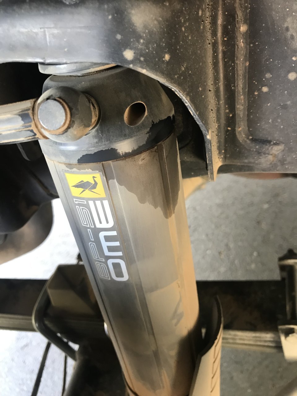

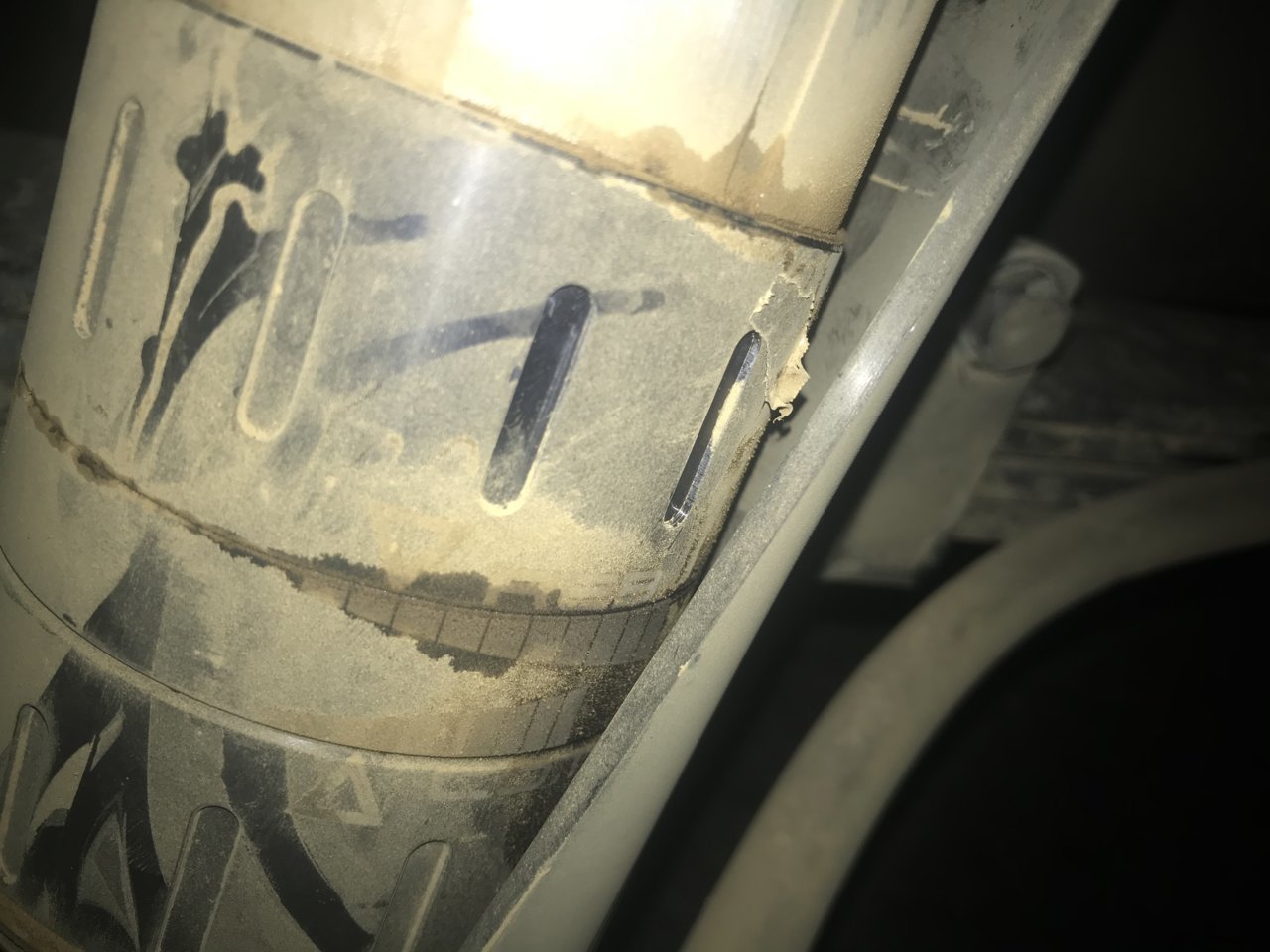

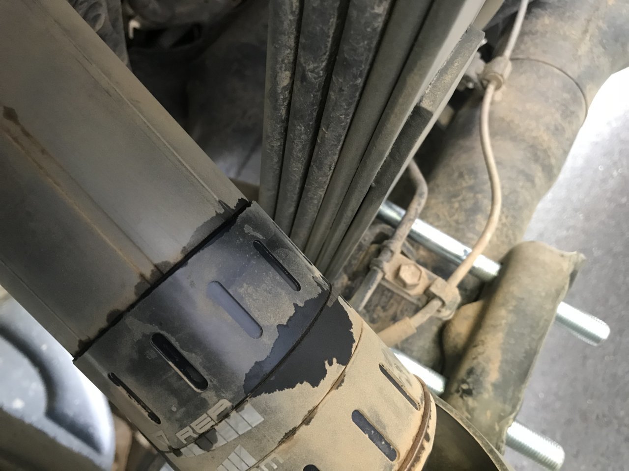

    I just had new BP-51s installed last week, went off-road for 5 miles on mild dirt road and have about 60 miles on these shocks. Is this normal for both rears to be leaking a small amount of oil? If so, will it stop or are these a defective batch? 351B1AF0-1BF0-4580-8CAD-D2C2A44C60E2.jpg D96F5F6C-F15B-4A23-99EF-8D7FE98C1078.jpgC27756FE-2BE6-4B89-A470-94C250A562B6.jpg

    Not normal, contact ARB USA

    Very bad, what did ARB say

    ARB Tech said it was most likely leftover oil near the seals during manufacturing. I was instructed to clean the areas with de-greaser and pressure wash after, which I did. They said if it keeps occurring then they would work with me and OKAuto to resolve the issue. So far, post-clean--no leaks are showing after about 100 miles on-road and another 5 miles off-road driving :)
