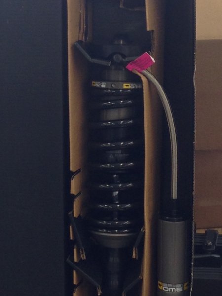

    With the body of the shock so close to the coil I don't think it will fit. IMG_0039.jpgI know it's a crappy photo but you can see not much room for the jaws to grab the spring.

    Thanks, I see what your saying, and just went out and looked at the set I have. I know I could make them work, I may have to modify them a touch.

    I initially tried renting a spring compressor from the local autoparts store as I've done for several other suspension jobs, but the body of the shock was too close to the coil to get a secure "grab" onto the coil as Juforrest mentioned. I'm sure there's a spring compressor out there that could get the job done in the garage/driveway, but rather than trial and error since I already had the coilovers off of the truck, I just headed to a local shop with the wall mounted version. Not the most convenient, but much safer in my opinion.
