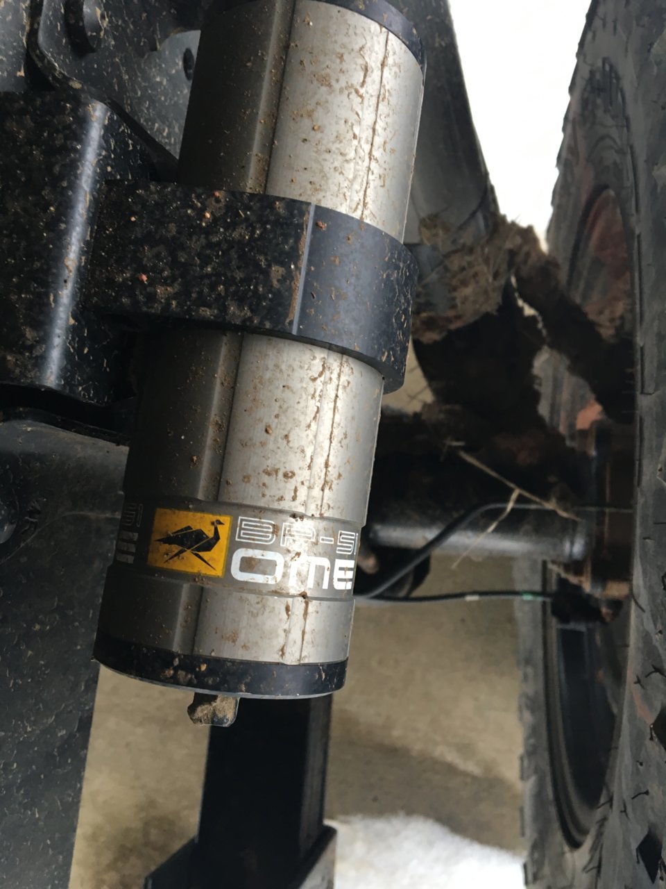

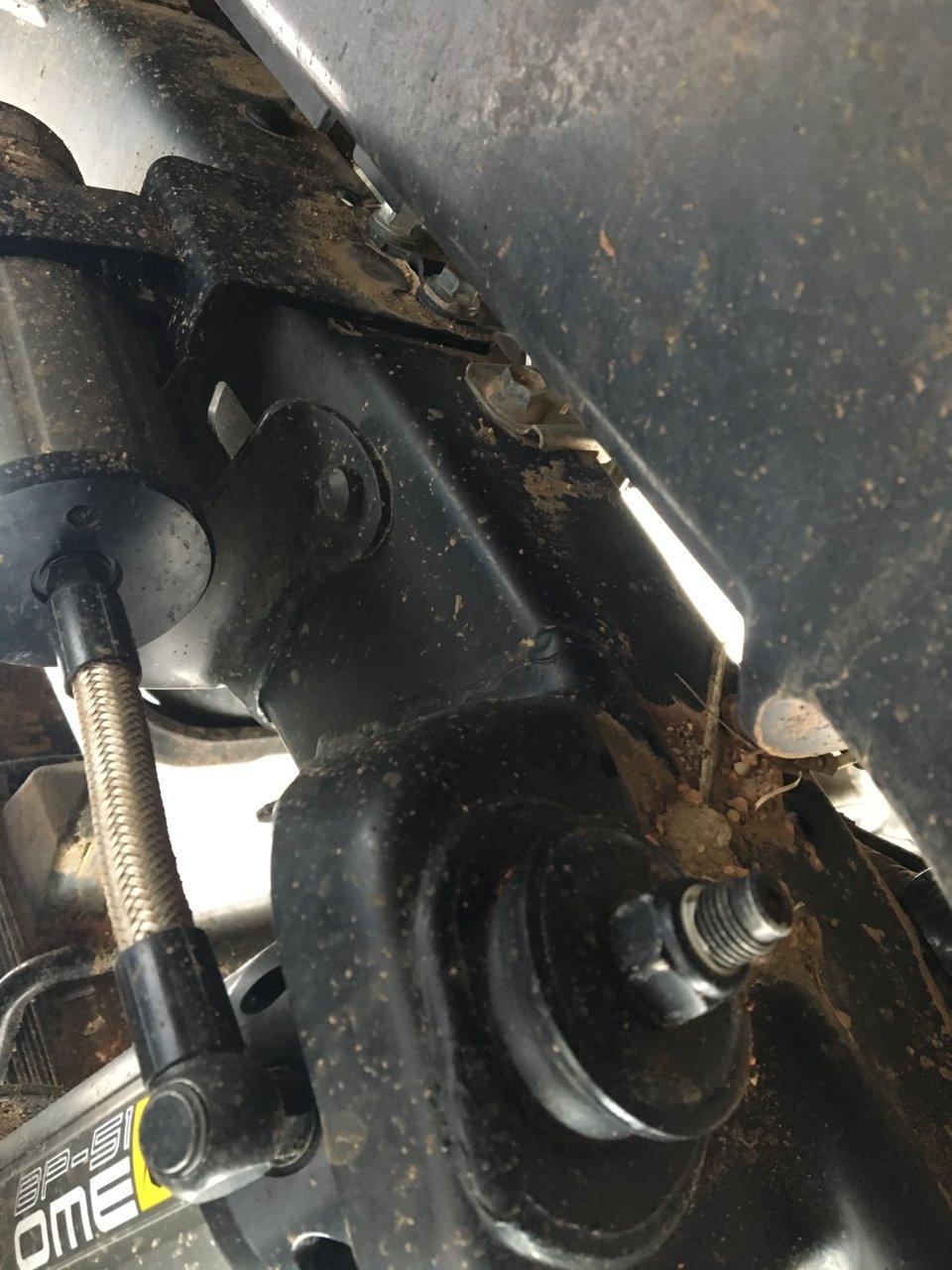

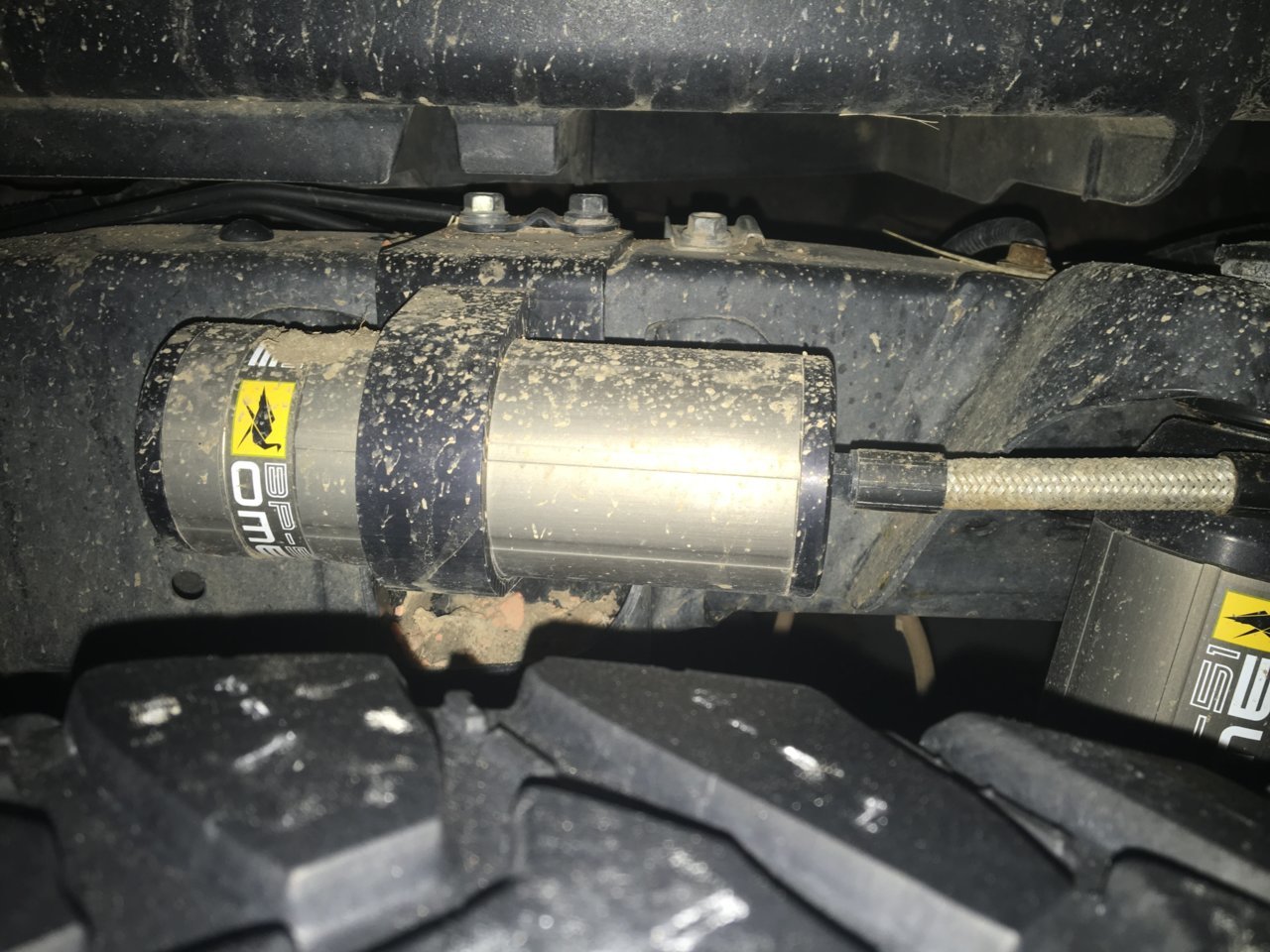

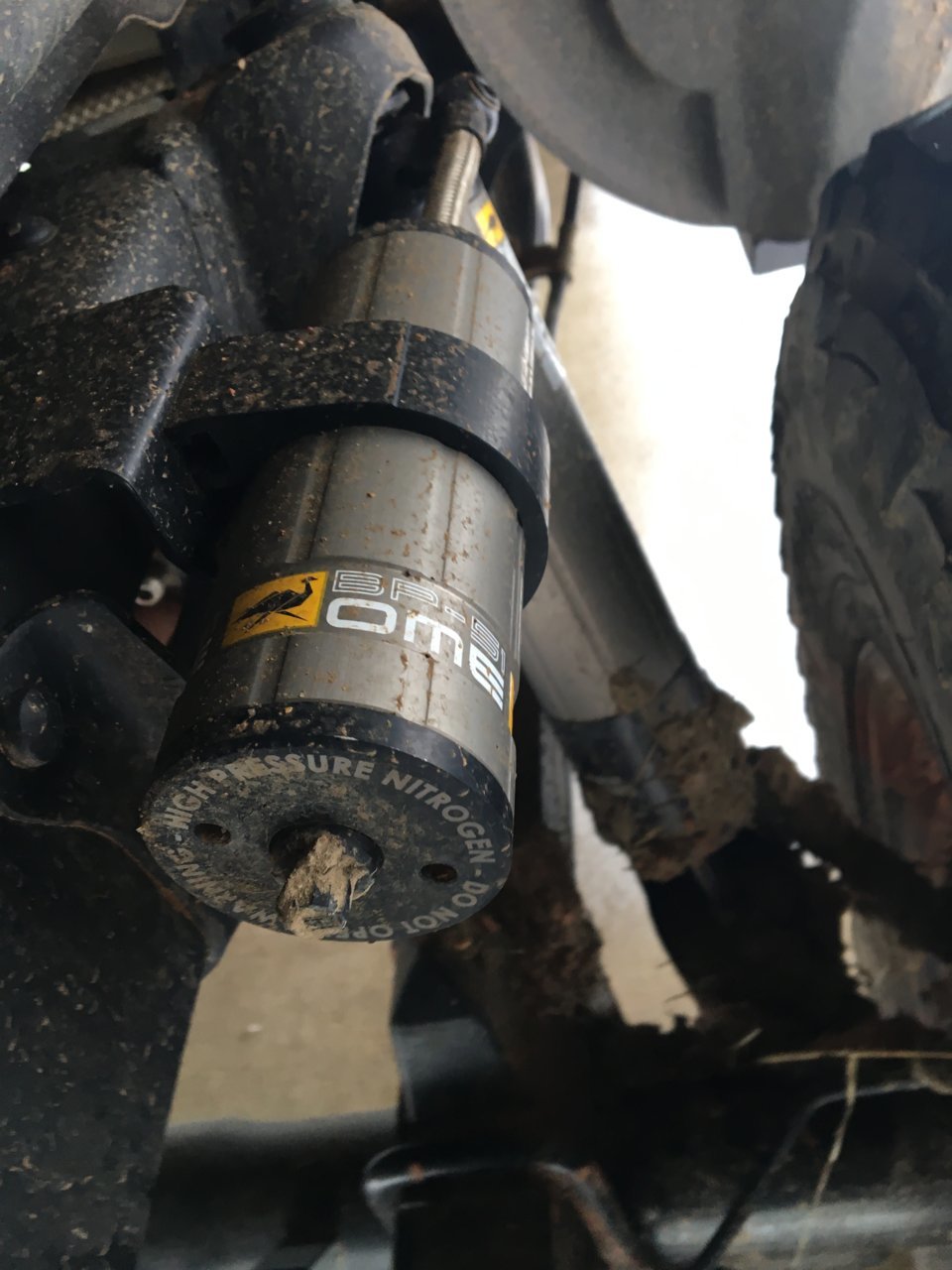

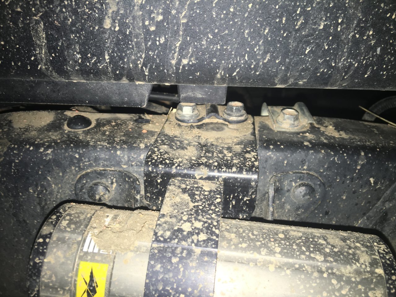

    Can any of you lovely folks with BP-51's on your truck do me a HUGE favor and take some pics of how the rear resis mount up to the truck? Pictures of the brackets themselves and/or a description of how it mounts to the frame would be awesome too. Is there drilling involved??
    I am trying to work out a similar mounting setup with a different brand shock- I really want to mount the resi in that same spot, right above the bump stop strike plate.
    I am pretty sure OME sells the mount kits individually too so I may just end up buying one and modifying it to work.

    -40
    -40 Well-Known Member
    Jul 26, 2015
    #160383
    1,057
    North Dakota
    01 DC Camburg LT & 17 OR OME BP-51
    1 st Gen TRD Supercharger. URD 7th Inj. Camburg 4x4 LT Kit. Tundra Brakes. 3rd Gen just get’n started, OME BP51 Dakar HD, Camburg UCA & various armor.
    9FECD8C2-B786-40E3-B650-7A9E33C625F7.jpg 8223C326-44A1-451E-8C49-D563BF00AFF2.jpg
    Nitori[QUOTED] likes this.

    See I didn't realize without a close up shot that they are angled in slightly towards the frame, and with a longer resi that's not gonna work.
    You saved me about $100 and a lot of frustration my man, I am very thankful.
    -40[QUOTED] likes this.

    I dunno it really looks like they are pointed inwards to me. @-40 if you could comment??
    This is my current setup:
    And while it clears everything just fine that noodly pigtail on the line and the fact that I have to shove on it and get on that clamp hard just... bugs the crap out of me.:annoyed:

    Not sure what you mean by pointed inwards ? Are you asking if the rear end reservior is pointed inwards?
