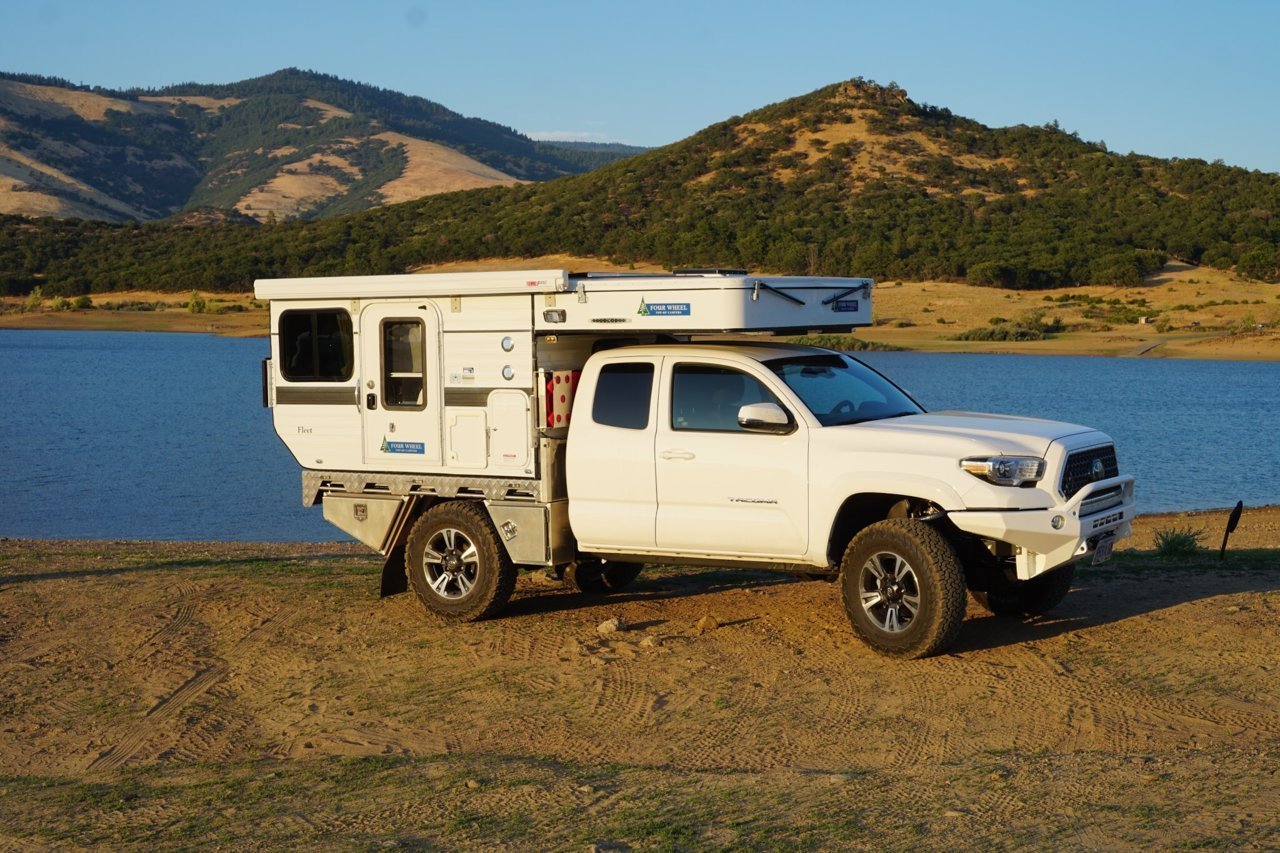

    Just got the truck back from the installer and driving for the first time over moderate bumps was amazing. So then I took a large bump at a bit faster rate and bottomed out the rear suspension, hitting one of the rear boxes. My question is in the rear are the shocks adjustable for height? I see that I can adjust them for a stiffer rebound. I'm afraid that the installer who also put on the flatbed may not have provided enough clearance for the rear suspension travel.
    Need to run the truck over a scale
    The picture below probably has the truck parked on a backward slope
    Thanks for your thoughts

    I believe the only way to raise it at this point would be to run additional leaf springs.

    I don't want to body shame, but she looks heavy.

    Yup, you're just being honest. She was designed and built that way. BP-51's with Dobinson heavy duty springs, ARB front and rear locking diffs, load range e tires. She's built to drive around the world starting next year. If interested in the build and the TW discussion, my thread is "Taking a Tacoma around the world,need advice"

    Looks heavy for sure. What's your current spring pack config ?

    Ah good question. What I do know is that installer who’s a very well known overland company in the Seattle area put on Dobinson heavy duty rear springs. These Dobinson heavy rear springs are rated for loaded Hilux trucks running up to 2000 lbs of payload. Is there a way to look at them for the specific config?
    I do know that there’s 9 leaf springs. I’ll send a photo tomorrow

    It's a way heavy rig, no doubt about it.
    Is that just the way your tray fits? Is it rubbing? It's tough to tell from that photo, but I'd start by seeing if the truck sits close to level. Park somewhere you know is level and see how it looks?

    That is the way the tray was mounted using the standard Norweld mounting system for the Tacoma. It does not rub but only has about 4 inches of total travel in the rear suspension, clearly not enough. The installer used the heaviest duty Dobinson rear springs and they are almost flat so we’re reviewing our options. May have to go with a custom Deaver or Alcan setup. Good idea on taking it to a level parking lot with my 4 foot construction level
