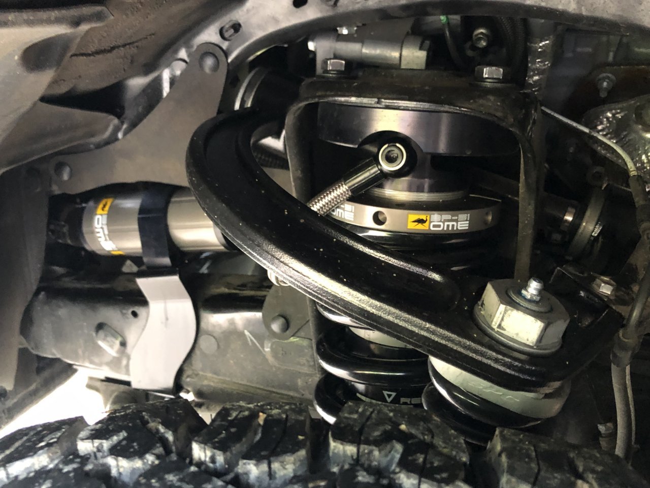

    I ordered the OME BP-51 lift kit from Headstrong Offroad with the SPC adjustable UCA’s, the HD Dakar leaf pack and just had it installed on my 2017 SR5 4x4 today.
    Also, installed a set of 285 70R 17 BFG KO2 AT’s and had those mounted on my existing 17x8 Ultra Maverick rims. Installer was concerned the tire wouldn't clear the UCA’s but I was confident they would based on the information I got here. Which proved correct and the BFG 285’s filled my wheel wells up nicely, with no cab or UCA rubbing issues.
    Decided on a full performance lift after much research here on TW. I prefer the nose down stance which the OME lifts are known for and for adding aftermarket weight up front. I haven't made any comp or rebound adjustments yet, everything was installed as received from Headstrong. I’ll look at making any adjustments after all the weight is added.
    Neglected to get any measurements before I started the mod and just added all the weight to the truck before the kit was installed. Its got a bit of a rake which was what I wanted with no gear, no people, or supplies loaded. When I haul my boat, my buddies and some beer I expect it will level out some.
    For aftermarket weight I have added the N-Fab rock rails w/removable steps, a full steel skid plate pkg incl fuel tank skid from RCI at 145lbs, SSO Hybrid with Smittybilt X2O 10k winch at 125lbs, steel Fab Fours Rear bumper at 115lbs, Decked sys for a DCSB at 185lbs and a Thule TracOne ladder rack at 45lbs.
    Not sure what the net gain was from all the lighter weight OEM parts that were removed and addition of the new equipment and tires but the front coil overs alone must be in the plus 90lbs range not counting the HD leaf pack. Figure I’ve added about 640 lbs of aftermarket weight once the SSO bumper and winch are installed.
    The BFG AT’s are pretty quite on road which was a surprise, I expected more. My initial impression was a giddy laugh as I felt the improved handling. Its a bit stiffer but not overly so. I live in the mountains on a beat up dirt road and all my rigs are 4x4’s or I’d be walking a mile up hill in the wintertime. Handled the washboard up my hill very well right out of the box and I hope to dial it in this hunting season even more.

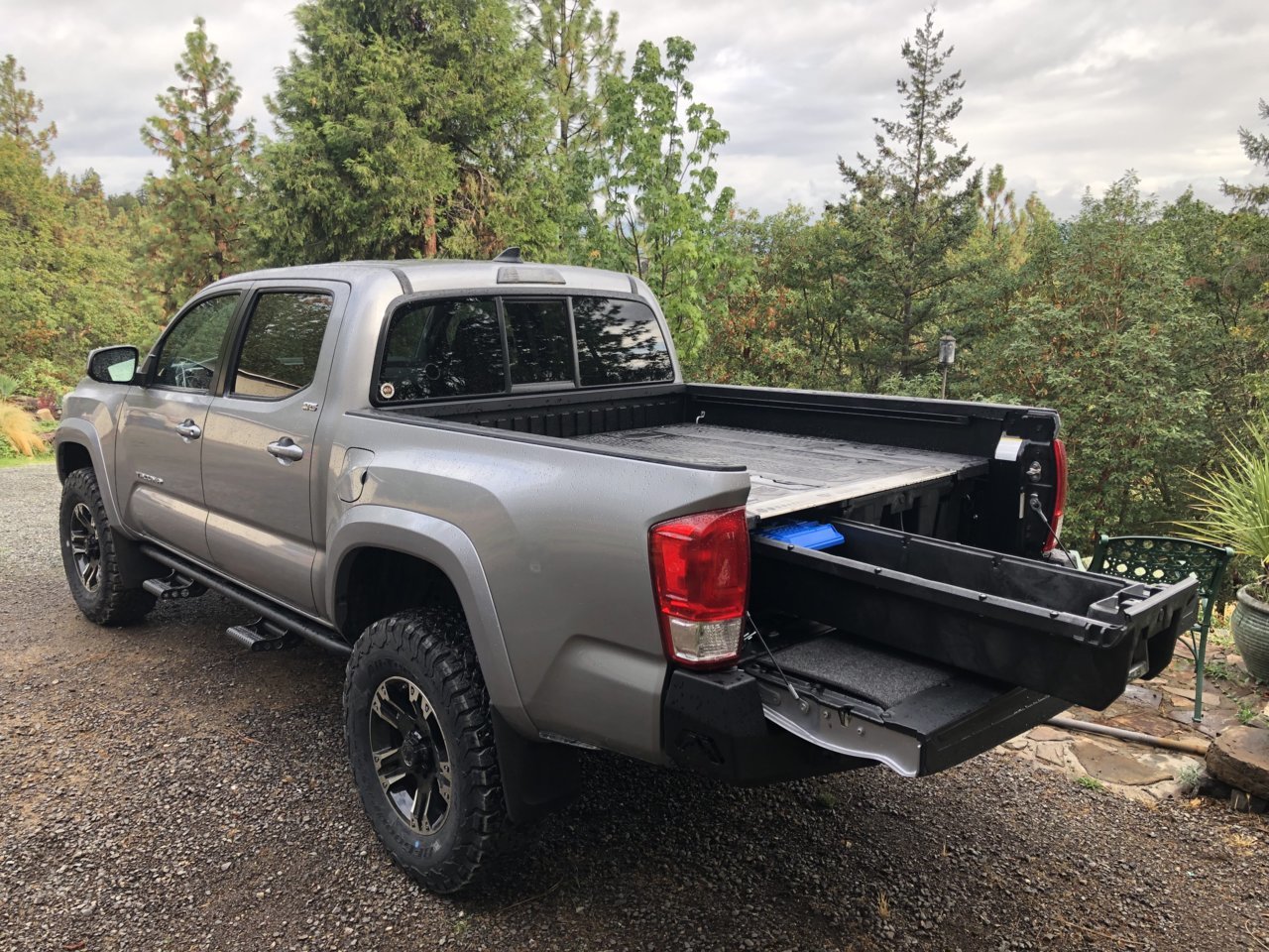

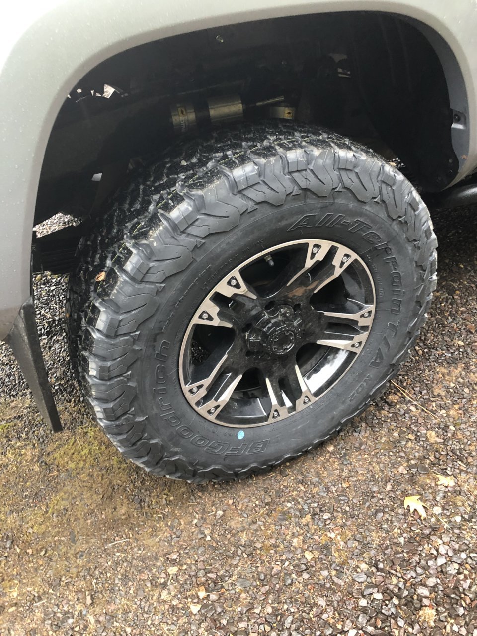

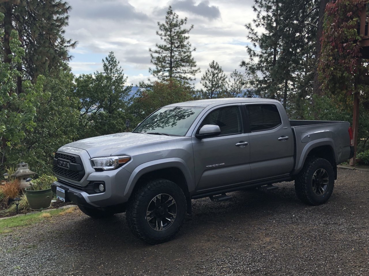

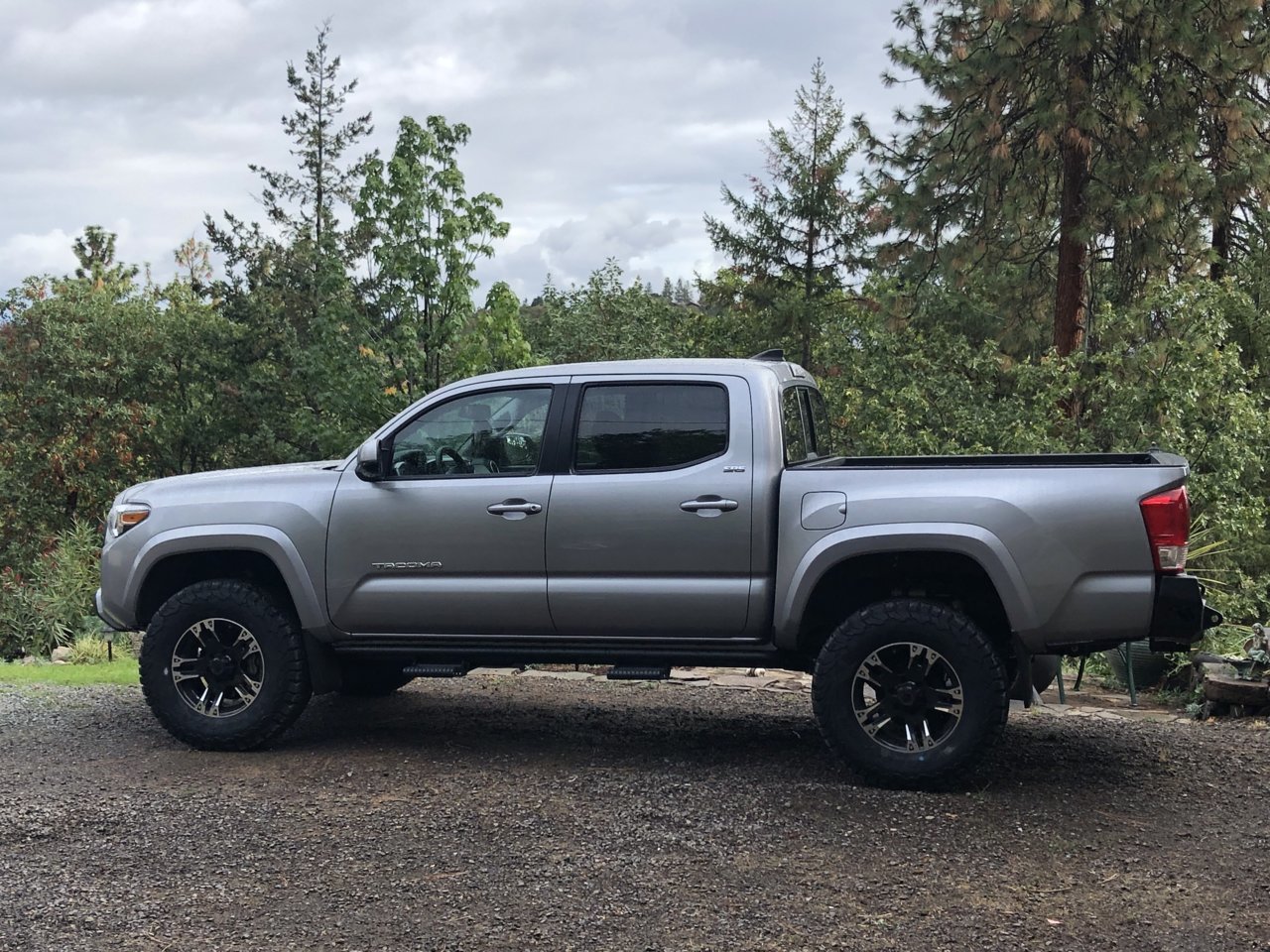

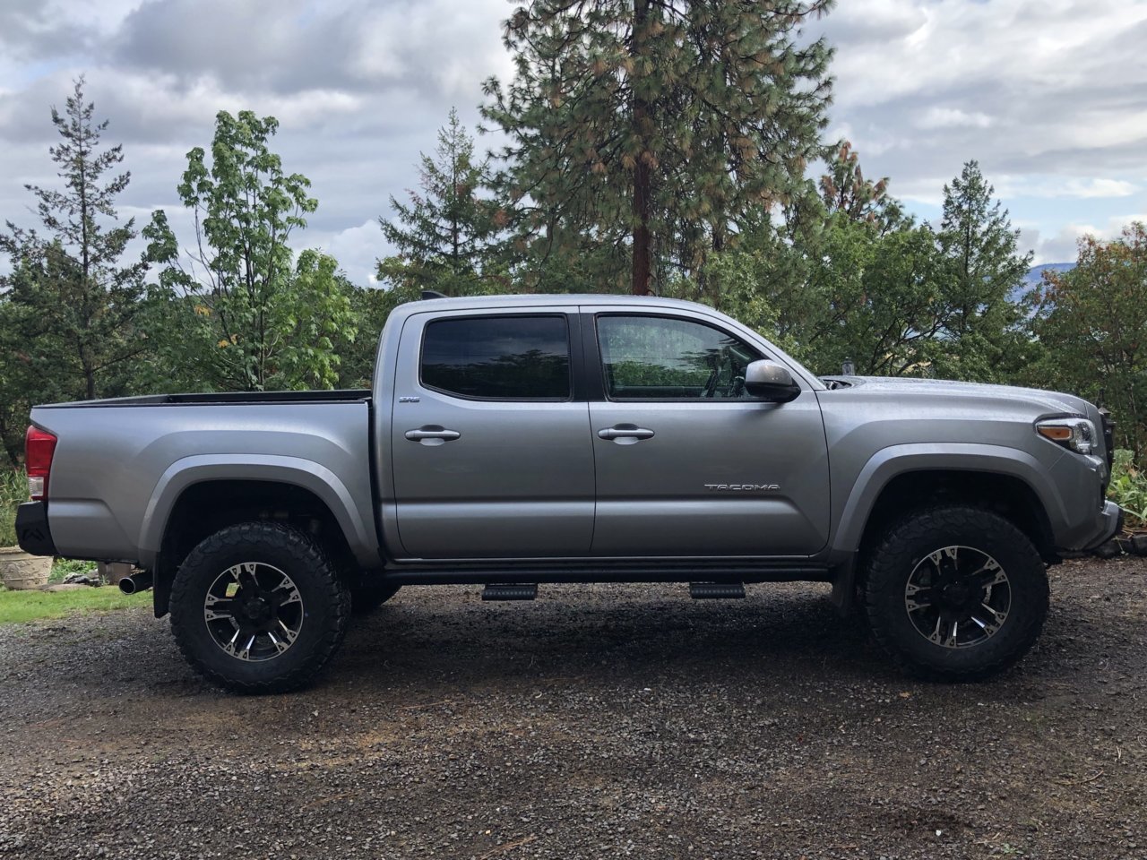

    Here are some pic’s for ya!
    I’ll post some of the bumper and winch setup if it ever gets here!
    DavesTaco68, eurowner and SCHNUGGS like this.

    BEAUTIFUL! Your Taco sits perfect... and I appreciate the pics! I'm planning on going with a BP-51 set up someday too. Have fun flogging it! Cheers, Carlos

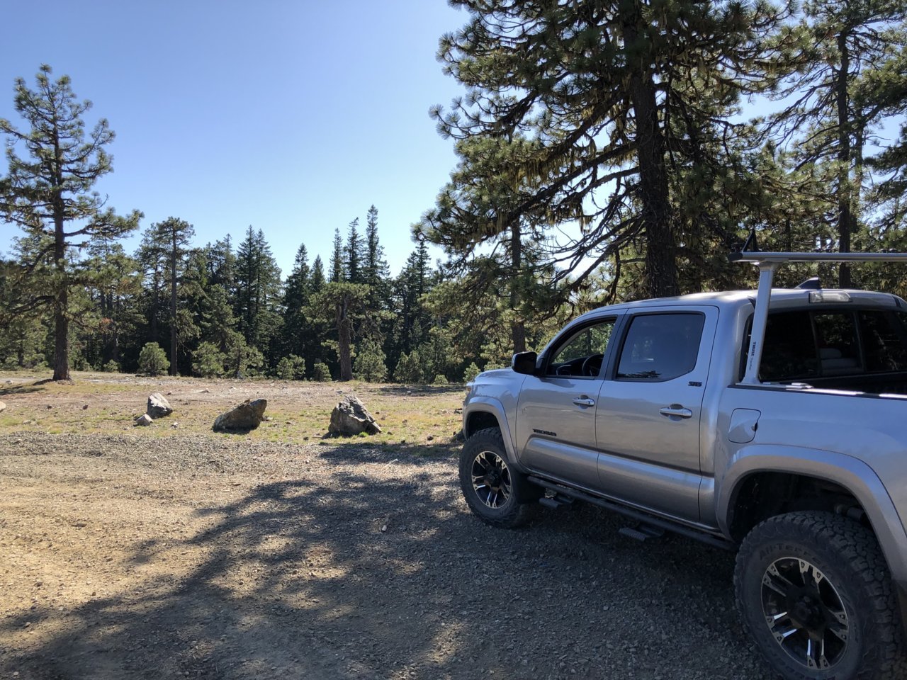

    So a little update here:
    I’ve had a chance to put my new BP-51 lift and 285 tires to the test off road during the first opening week of hunting season and I’m impressed with the difference in my trucks handling off road.
    Sippi-holes, rocks, ruts, out sloped washouts, tight 3 point turn arounds, potholes, washboard, broken chip seal, no worries! The BP-51 lift took the big hits from those sneaky potholes hiding in the shade with ease. I would grip tight and hold my breath as I was about to hit a pothole, passengers would gasp and reach for grab bars and then say, hey that wasn’t to bad, wow! Handled the washboards at speed very well and overall the truck was just “smooth” as a back seat passenger noted.
    I did experience a bit of rubbing when I was doing slow maneuvering under compression, forward and backward, with the wheel over one direction or the other. Didn’t have any rubbing during tight maneuvers on the flats.
    Having a SSO hybrid w/X2O winch delivered soon so plan to have the height adjusted to 15mm from the current factory 5mm setting when that gets installed and see how that works out. I’m lightly rubbing the mud guards so I’m not too concerned about it as this only occurs when I am off road doing slow full turn maneuvers while the shock is under compression.
    Other than that, I’m really liking this setup!
