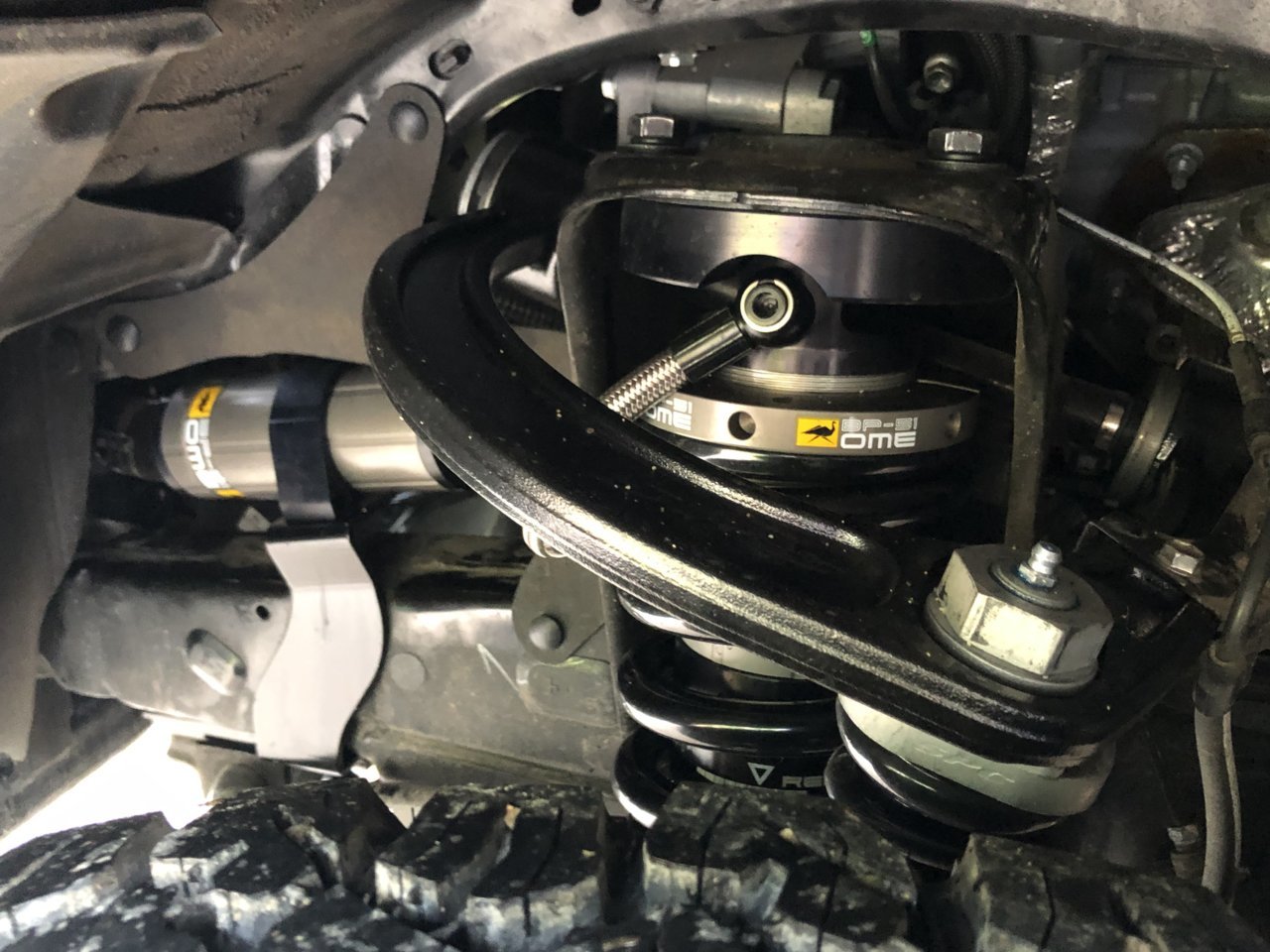

    Here’s the factory out of the box setting looks like 4 threads equals 5mm.

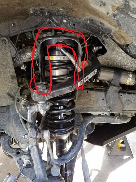

    Anyone know what the thread/length is on the bolts holding the top of the coil over?
    I want to put the 1/4 spacer on the driver side and am going to grab some longer bolts for them....

    this part just blocks everything

    For me, I wasn't able to access the lock nut to even attempt an adjustment. So, I’m going to have my tire shop make the adjustment with them off when my SSO Hybrid/winch is installed. I did see something about using a 5/16” punch instead of the spanner wrench in that tight space on youtube? Plan to use ARB’s spec of 10mm for a gas Tacoma w/bumper and winch setup. Right now I’m set at 5mm no spacers and getting slight rubbing on mud flaps while making tight maneuvers under compression off road, no rubbing at all on road.
