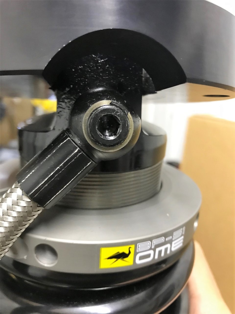

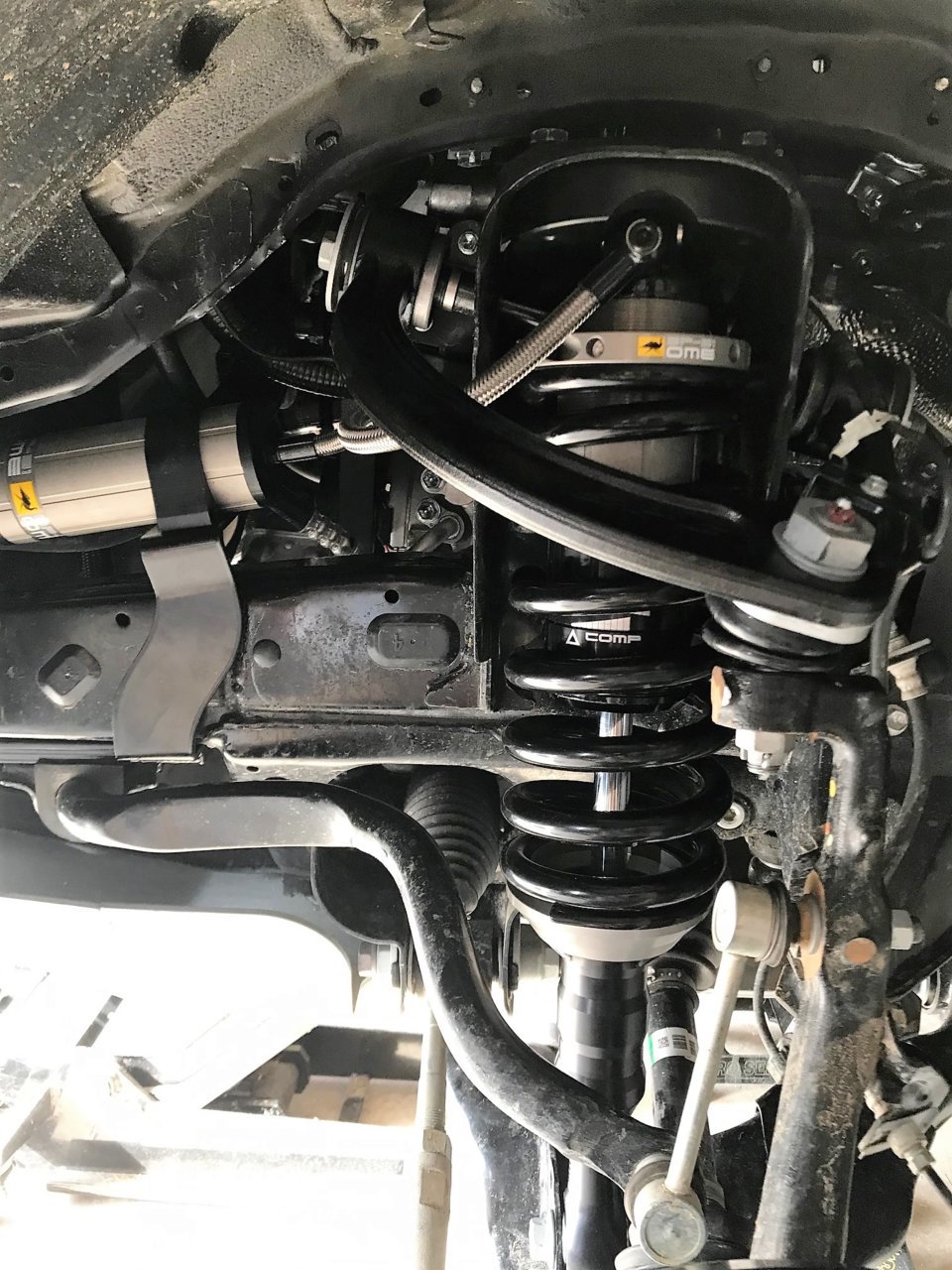

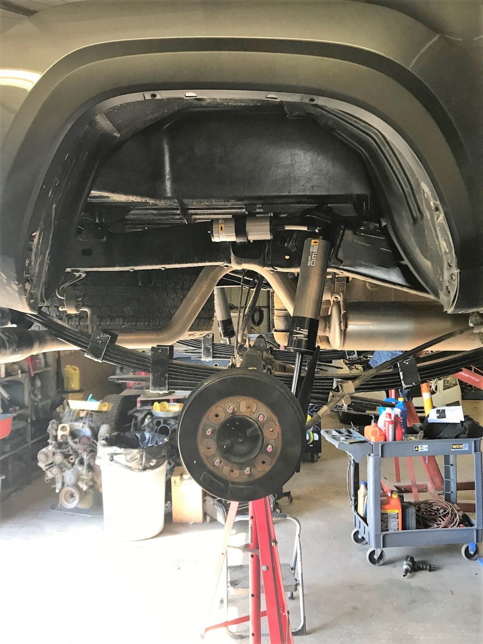

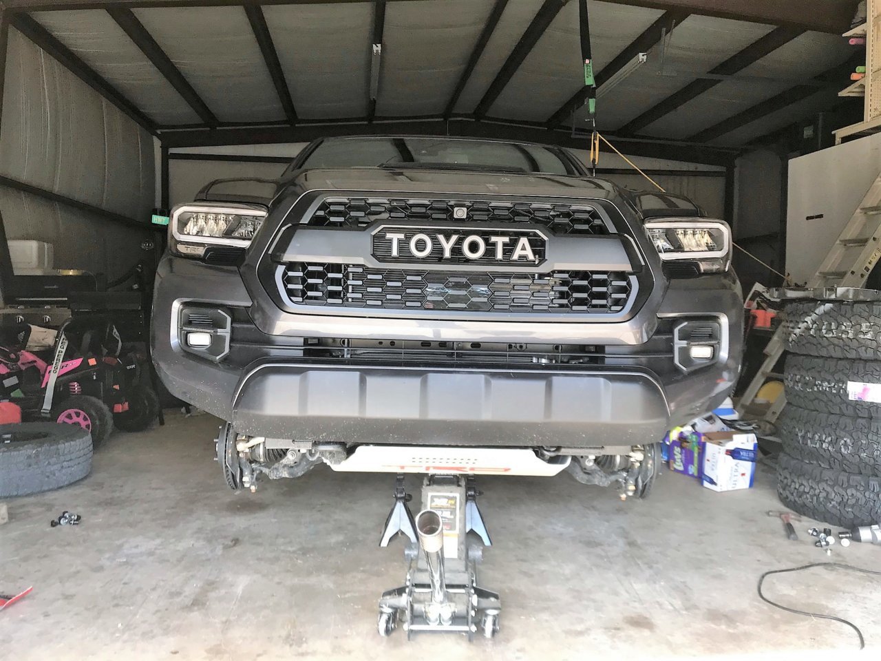

    So, installing this BP-51 kit has been an adventure. Got with my buddy who's a mechanic and has a lift at his shop this past Saturday. We installed everything without a fuss, except for a few minor annoyances (plastic collar guards for the rear shocks and attaching the front reservoirs to the frame). After we set the truck back down on the stock wheels/tires you could tell it had a major rake to it. Luckily, I took measurements before installing everything. Here's what I got.
    Post lift with factory setting of 5mm on coilovers with a 1/4" Headstrong spacer and the heavy duty rear leaf springs:
    Front Driver - 1.25"
    Front Passenger - 1.25"
    Rear Driver - 3.5"
    Rear Passenger - 3.5"
    That was way too much rake for me at 2.25" difference. So, I took my truck back home and jacked it back up and removed the front coilovers this past Monday. I tried to use some spring compressors that were recommended on a thread here, but they were kind of sketchy and were starting to make contact with the body of the shock. Decided it was best to take them to someone with a wall mounted spring compressor. I had already purchased the tool to use with a wall mount compressor to make the job a little easier. After scrambling around, I found a shop that could do it for me right then (since I had already taken off work to do this). Got them set to 15mm right before they closed the doors and headed home to install. Luckily I had some whiskey on standby in a glass I purchased of the TW forum. Next post with the continuance of what happened next.....

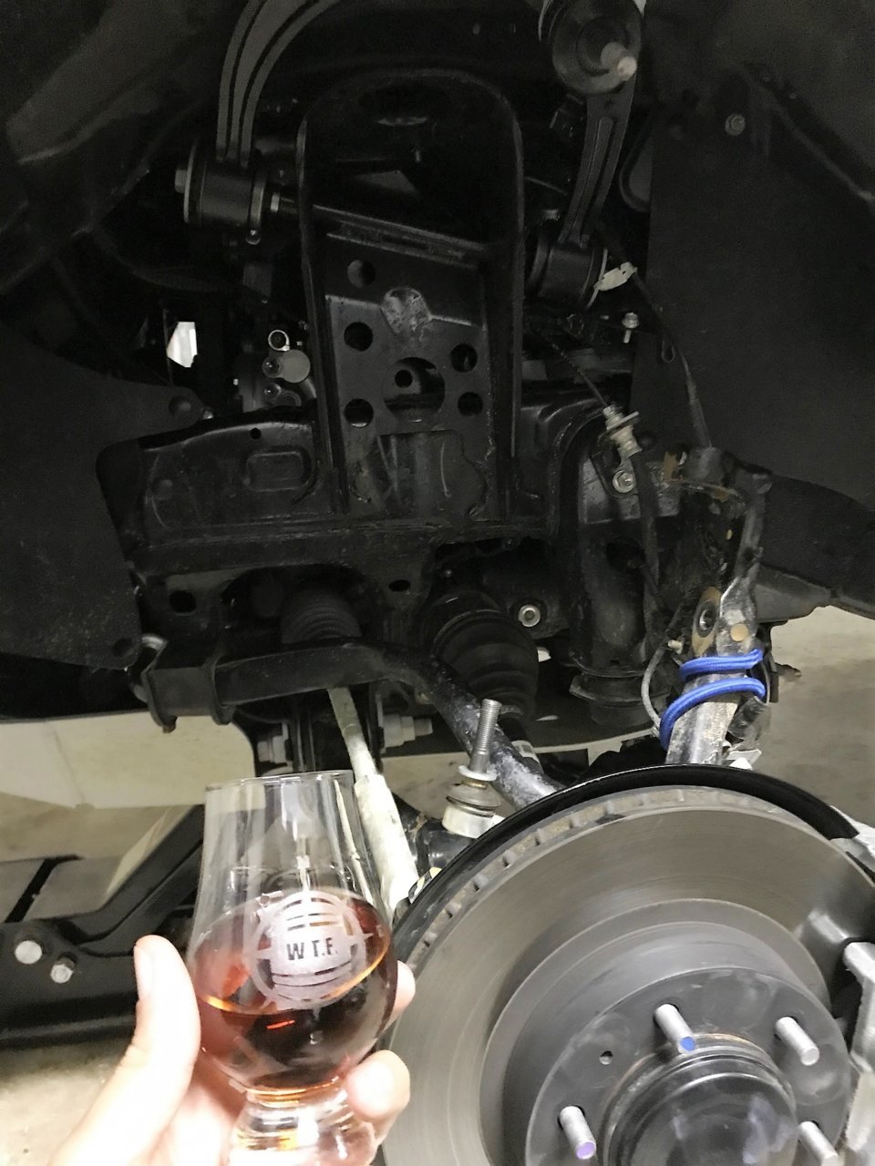

    Well, I get home and notice that one of the shocks looks like it's leaking. ARB is closed, so looks like I'm waiting until the morning to figure it out. Great! At least I had the whiskey there to keep me company.... Call ARB first thing this morning (10am my time since they are on the west coast) and shoot them the picture below and they confirm it's a definite leak and needs to be replaced. YAY! I told them that I had already paid to have them adjusted to 15mm and would like the new one to come set at the same height to same me some time and money. Said it would be no problem and I have one on the way.

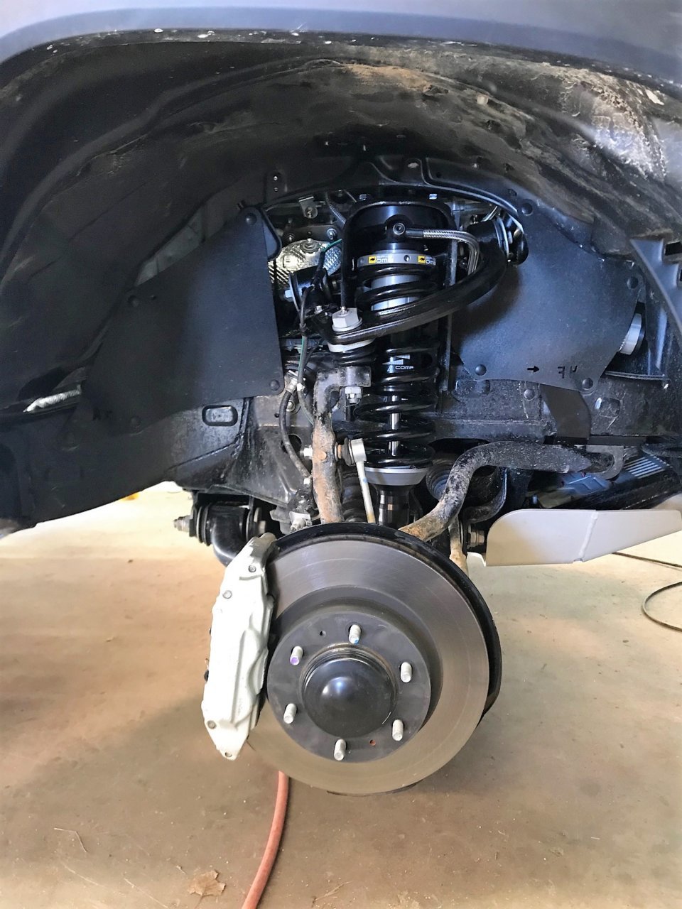

    However, I already had an appointment scheduled to have my new wheels and tires mounted/balanced and an alignment done. So, I went ahead and installed the leaky coilover and just dropped it off at the shop to get everything done. Figure I'll just remove the damaged coilover and replace it with the new one preset at the same height and not have to do another alignment and rock on. Should have some pictures with the new lift/wheels/tires this evening or first thing tomorrow. Will be a big change for the little truck. Here are the new measurements on the front going from 5mm to 15mm:
    Front Driver - 3"
    Front Passenger - 3"
    Only a 1" rake now and looks a lot better. New tires should yield another 1" total of lift from the ground.
