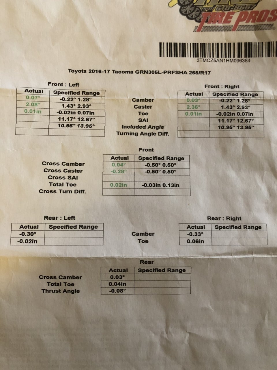

    I finally found my UCA caster numbers, not sure what they mean specifically but everything looks to be in the green?
    How’s does it look to you?

    In the green is good to go. I need to check and see what they set my SPC's at and compare it to the chart they provided.

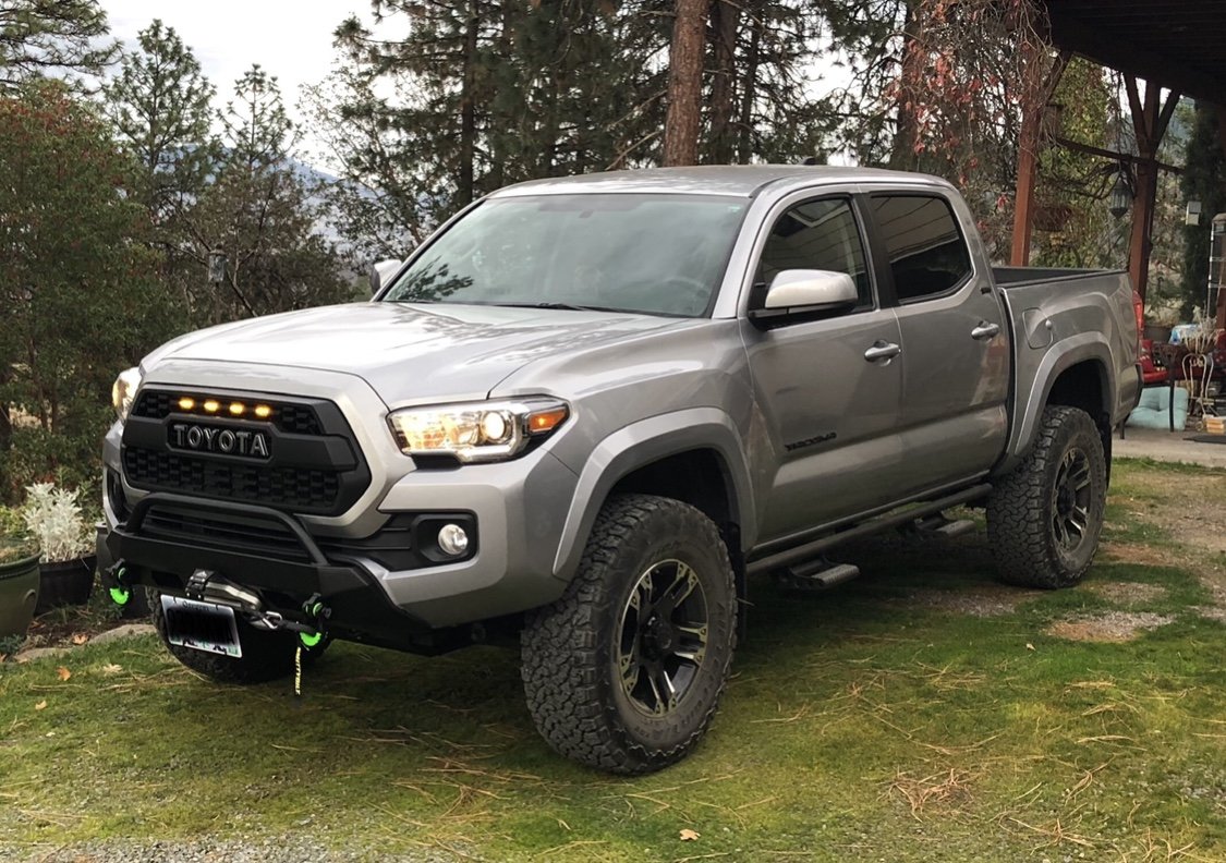

    Just installed the SSO hybrid w/winch and figure I’ve now added approx 630lbs. OME BP-51 lift, HD dakar leafs, BFG 285’s, full steel skids, steel bumpers, winch, decked, matched wheel/spare, & rock rails. Thats before any gear or passengers.
    I’m going to give 10mm pre-load a test, see how that works then go up from there as needed.

    Hey just to be fair to yourself don’t count your wheels as extra sprung weight except for the spare. Their weight matters for mpg but it’s unsprung.

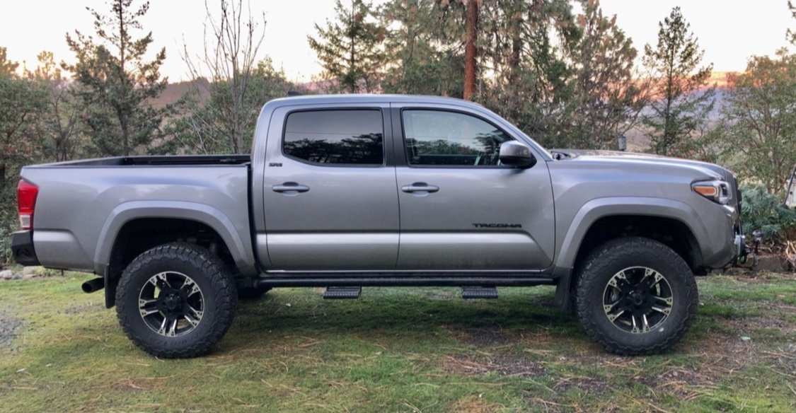

    Here’s an update,
    I had my BP-51 pre load adjusted today and that took care of the rubbing I was experiencing. Had them installed out of the box at 5mm and I was getting some minor rubbing in the driver side wheel well off road. I added more weight recently with a SSO hybrid/winch setup and got a bit more rubbing. Asked for 10-12mm but they went ahead and set them at 13mm for safety. I don’t have any spacers installed with this setup, running 285/70/17 on 17x8’s
    Really liking this BP-51/SSO Hybrid and Smittybilt X2O setup. Plan a tougher ride this weekend to test for any rubbing but so far, so good!
