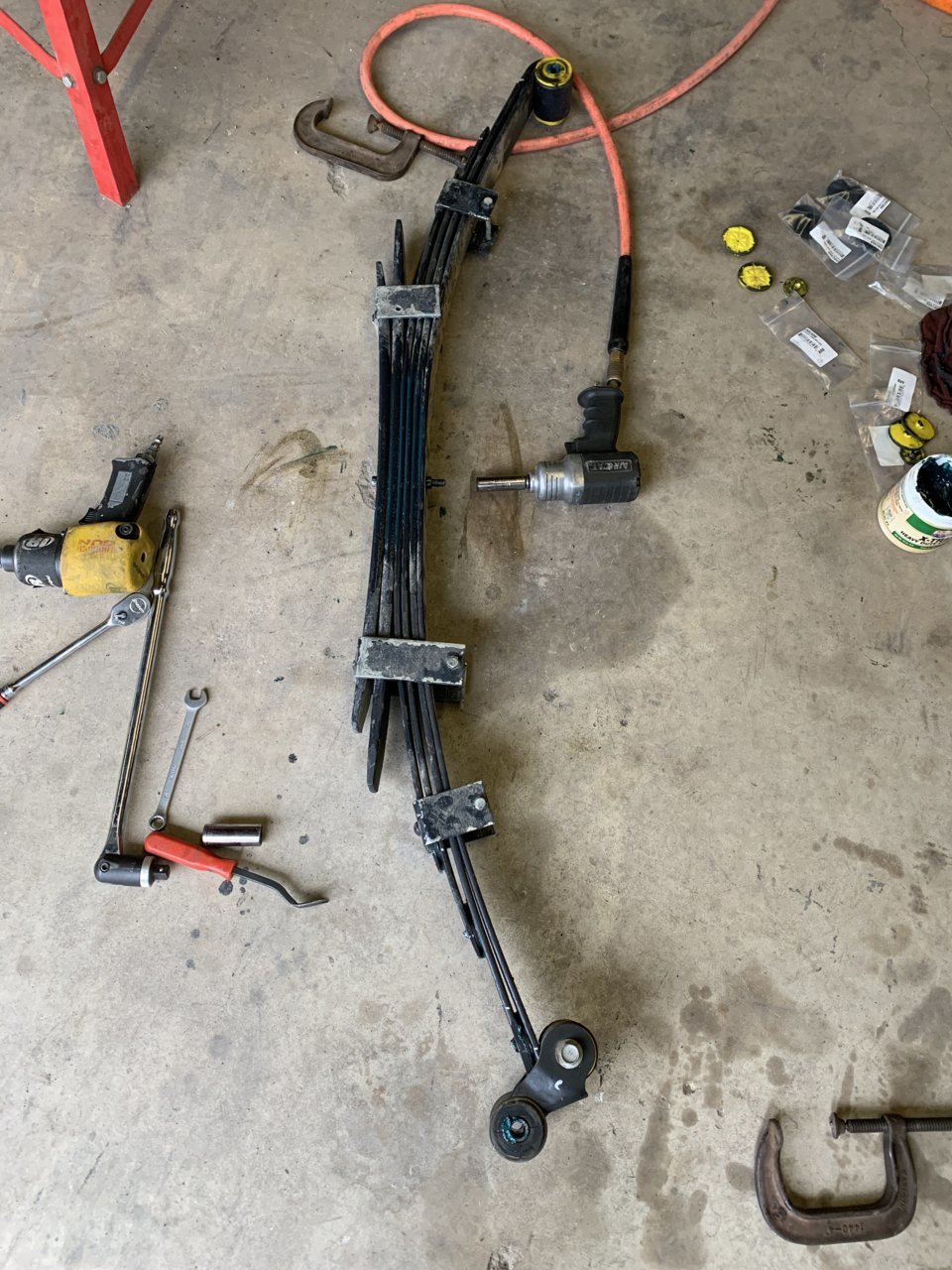

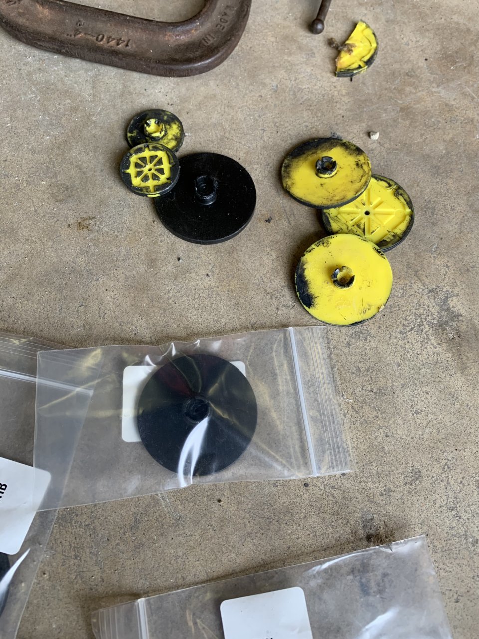

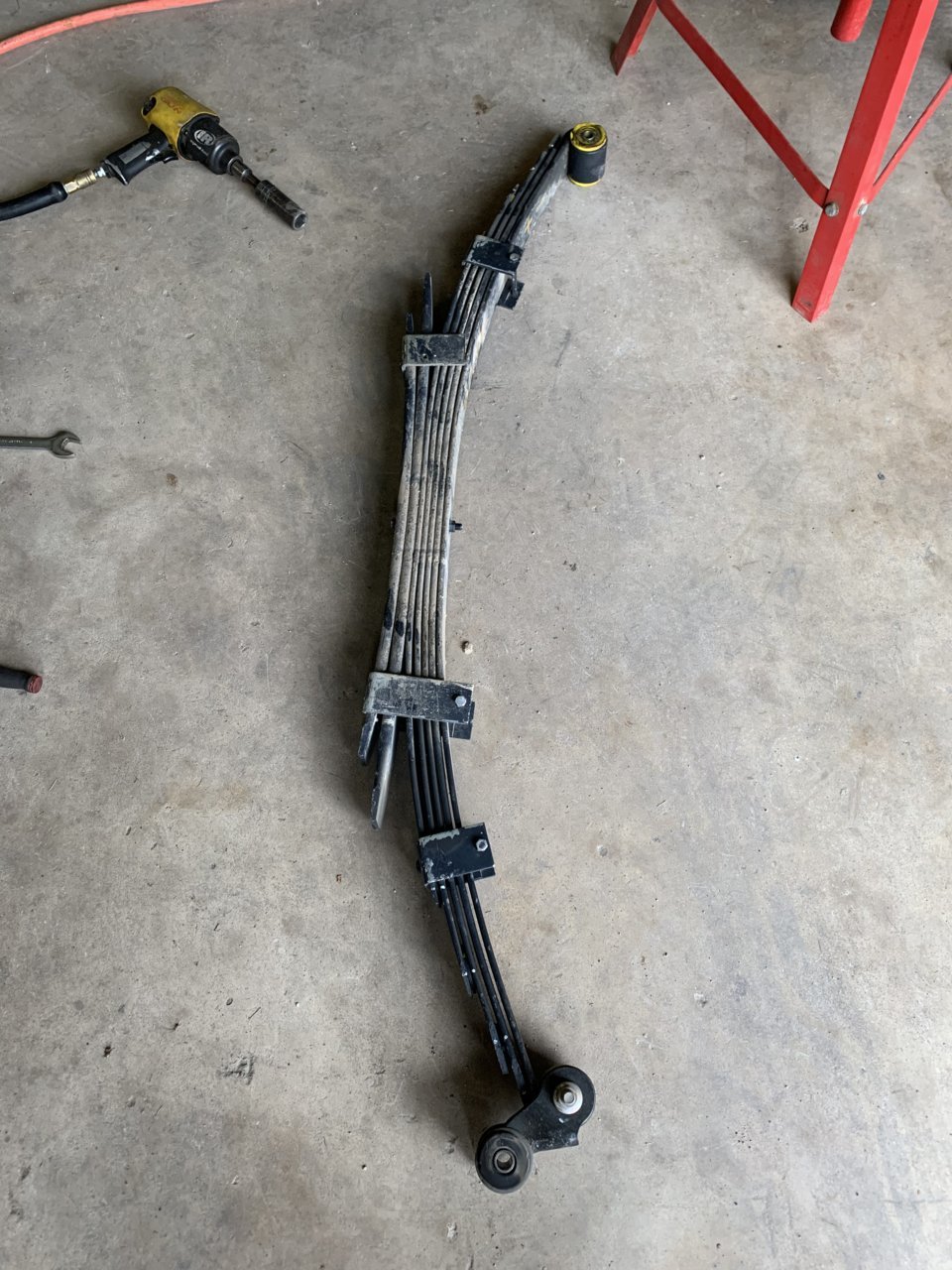

    Pulled the leafs today and removed the 3rd leaf to take it from an HD pack to a medium duty pack. Definitely a better ride since I don’t have any weight back there. I also replaced the spring spacers (yellow) with the newer ARB ones. To be honest, I’m not sure they helped much. But they were cheap. Greasing everything got rid of all the squeaking (yessssss!!!). Now I’ll just have to dial in the compression and rebound after driving on it for awhile.
