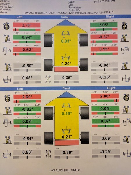

    No need for LCA for alignment purposes unless you are going to a longer travel setup. I haven't encountered a Firestone tech yet that I didn't have to "guide" through alignment 101. I'm thankful for the fancy Hunter alignment technology which superscedes human brainpower every time I go to Firestone...

    Firestone is GARBAGE for good alignment, for little toe adjustments they are fine. Get your alignment done at a REAL alignment shop. BP51s and SPC UCAs. Initial Alignment was knocked out of wack at an offroad park.
