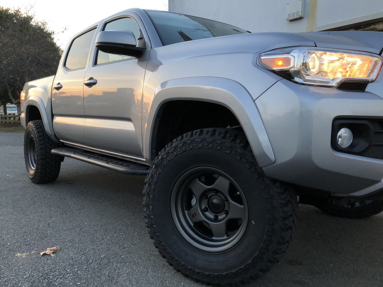

    Some updates, I just finished the bp51 install this afternoon. After performing an at home self alignment the trucks handling great. On my 2019 sr5 at stock 5mm and 1/4” spacer and medium duty Dakars I got just a hair above 2.5” up front measured center hub to fender flare. And just under 3” in the rear. I’m sure it will settle some but the truck looks great. More pics Tommorrow after I cut up the front to get tires to not rub.

    After some settling and front is just under 2.5” and rear just under 3” of lift so far from the suspension. I’m a big fan of the ride so far. Spc upper has really helped with clearance. So far no rubbing and no cmc with the lift and got truck driving very straight after dialing in my alignment. It barely touches the cab mount at full flex 3/4 of the way through the steering. Not enough to worry about at this time.

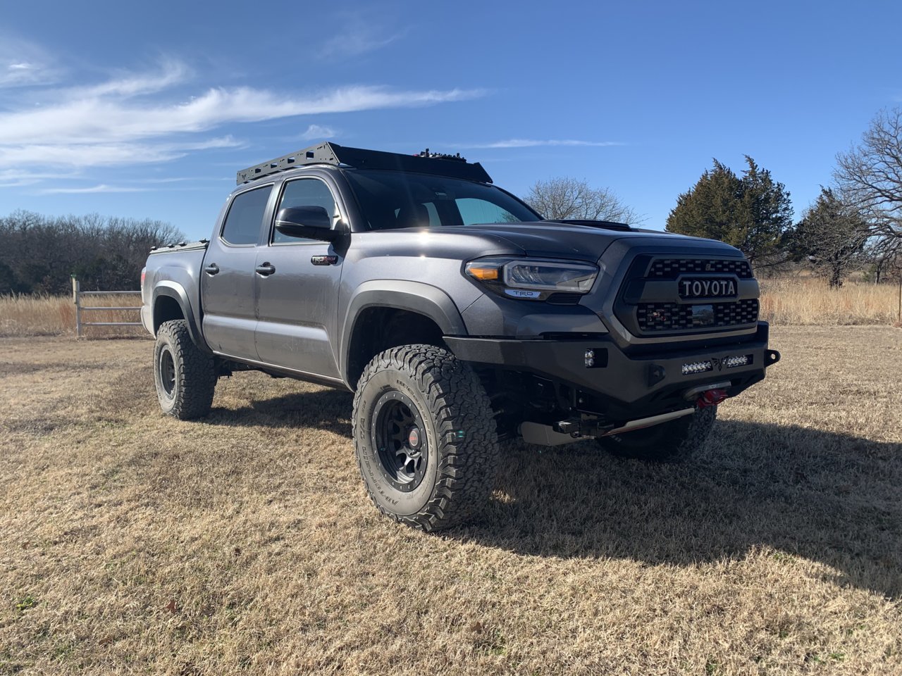

    nice! It looks great man! You’re at the 5mm setting right? At 15mm and no weight, I was at 3” over stock (Trd pro, so ~4” maybe?) in the front and I was having topping out issues and a rougher ride. Just installed the front bumper and winch and it brought me down to 2.5” in the front and I haven’t experienced any topping out yet and the ride is a lot smoother.
    I’m still rubbing against the rear inner fender a bit when the tire gets tucked in and at a turn at the same time. But, I have my caster set at 2*. Going to change it to 4* today and get another alignment Tuesday and see if that helps. If not, I’ll be doing some cutting. With the new front bumper I have a lot of room up front so I think the 4 degrees should fix my issue.
    my current height from the ground to the fender with 285/75r16 tires and 1/4” HS spacer:
    FP 38.5”
    RP 40”
    FD 38.25”
    RD 40”

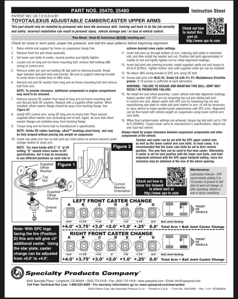

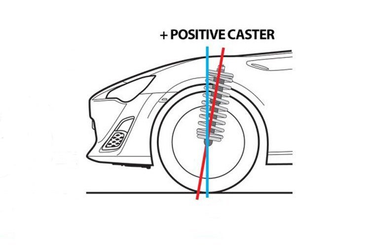

    from what I understand, adding positive (+) caster will push your wheels forward. I went from position D to position A. Attached the SPC sheet and a diagram.

    a lot of mis information has been spread on this topic. in fact. Adding positive caster via the lower control arm eccentric does push the wheel further forward. However adding positive caster via the spc uca does the opposite and pushes the top of the wheel back toward the back. In order to get the most clearance from the back u want to max the lower eccentrics for caster *most important* (rear eccentric all the way out, forward eccentric all the way in) And on the spc uca go more toward position D,E,F less caster, but also moving the wheel forward. It is important to end up with still positive caster overall in the end. In that diagram that red line has more positive caster than blue. The more angled it gets the more caster u have.

    well, put my wheels back on the ground and they are definitely further back. And created some bad positive camber. Going to put it back the way it was and get with the alignment shop and let them adjust it. Letting them know I want to go as far forward as the suspension will allow without causing any negative effects to steering. Then, from there, decide what needs to be cut in the rear.
