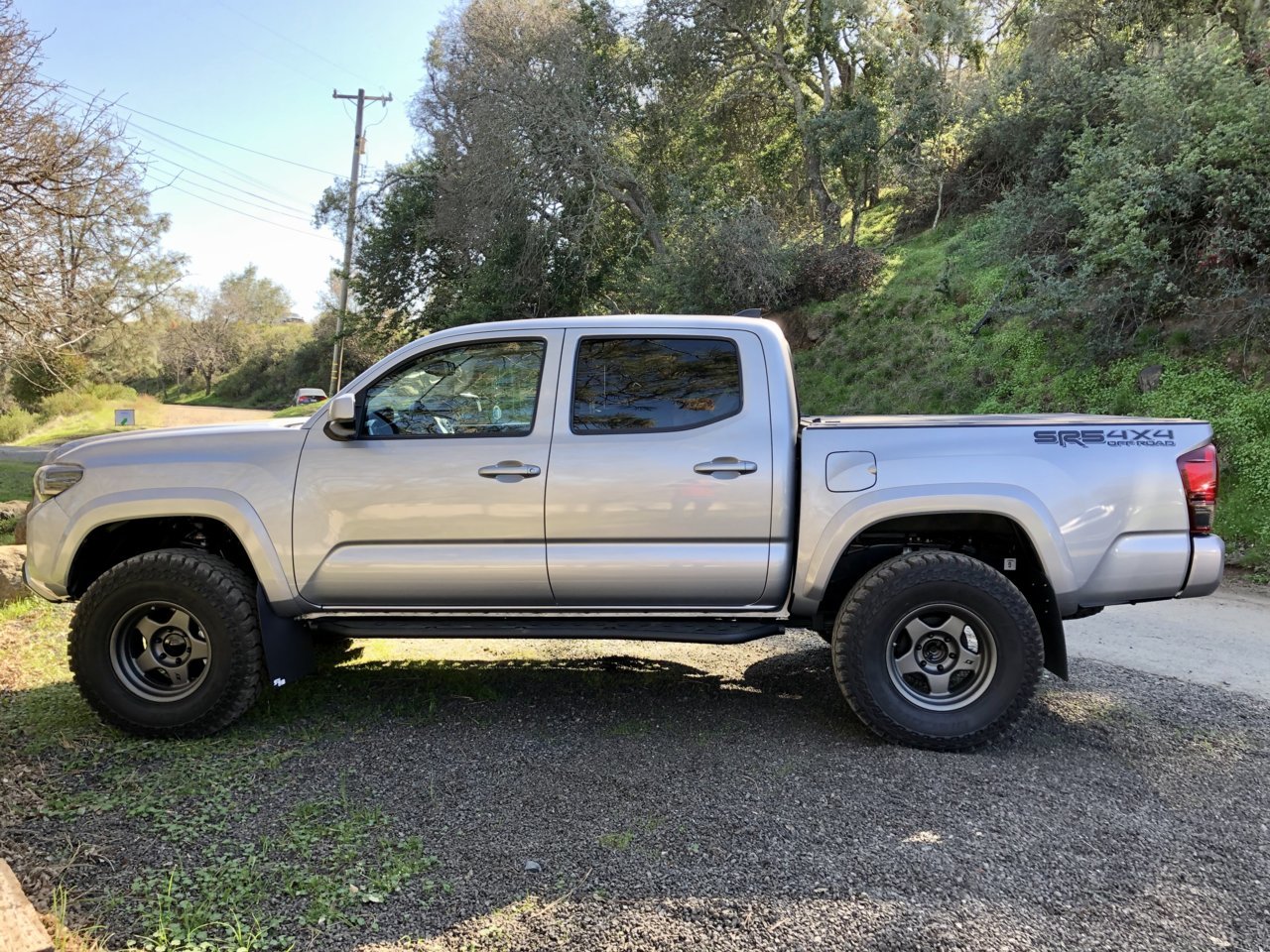

    I’m running that setup with 285/70/17 KO2’s. Purchased lift through Headstrong Offroad and had it installed by my tire shop out of the box at 5mm with no spacers. Experienced some minor rubbing off road up front but none on road while running rails/steps, full steel skids, steel rear bumper, and decked bed storage unit. Last year I installed a sso hybrid bumper/10k winch and had pre load adjusted to 13mm per my shops recommendation “just to be safe”, with regards to the rubbing issues. Currently running with about 630 additional pounds.
    Still experienced a very slight rub (once) when front passenger side coil is under compression in 3/4 turn position, but only off road. I would say, based on my own experience with similar added weight, that 10-15mm would be appropriate with the dual batt and compressor setup. Definitely 15mm if you add bumper/winch. Only other thing I would look into is the need to use spacers with this kit as I’ve seen others? This kit is made specifically for adding weight up front so I would expect it to be a little stiffer without it. My tire shop also recommended that each time the pre load setting is adjusted that a front end alignment should be done. So I started at 5mm and didn't adjust until I added the bumper and winch then went up to 13mm. Awesome off road suspension, no comparison to the stock suspension. I’ll likely go to 15mm when I have my tires rotated and hopefully that will be my last alignment and be the end of that little rub.

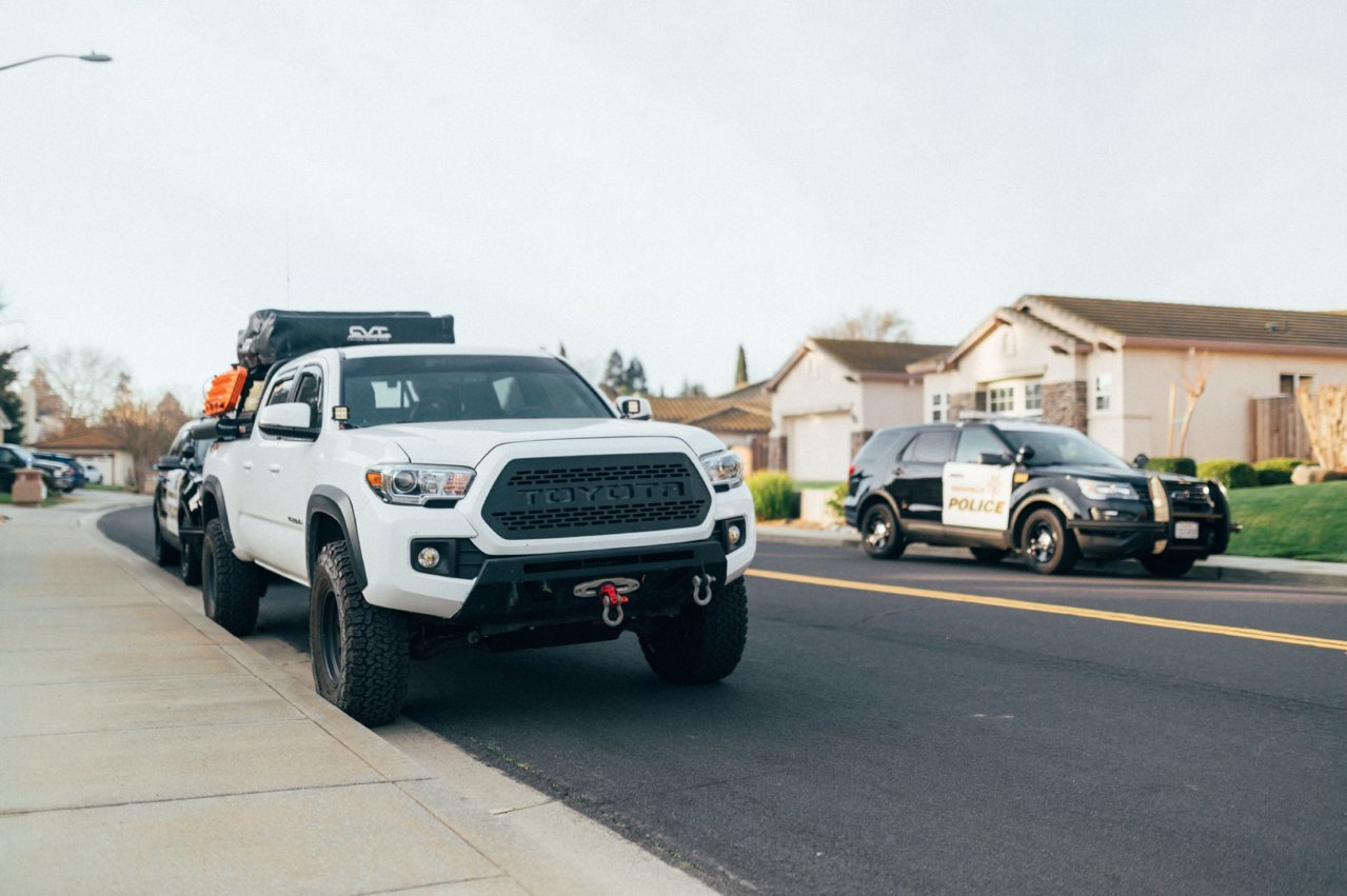

    I have the BP-51's and they ride incredibly well.... one thing though.... the front springs dont handle extra weight very well... I have two batteries, BAMF (full) skids, C4Fab front bumper + Winch and the truck looks stock AF in the front and ready to rumble in the back LOL
    Gonna have to see about getting stiffer springs, if not, start looking at a different front setup.

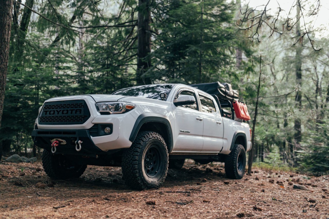

    These are shitty examples, I haven't taken any proper photos of the truck... But the front sags alot, even after adjusting the pre-load further than OME recommended to try and get that bit of lift outta the front. *** Also, im running 285's now, before someone asks lol***

    I’ll have to check.... it’s more than recommended.... Still have great ride and doesn’t over extend at droop
