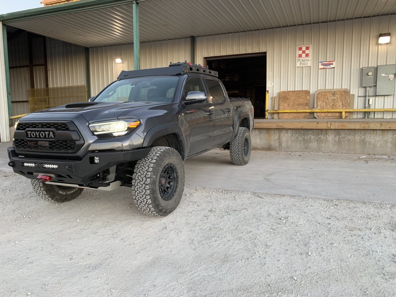

    Been awhile since I posted any updates. Well, I'm running at a 15mm pre-load with HS 1/4" spacers on both sides. I do have a slight lean towards the drivers side, so I might remove the passenger side 1/4" spacer. Haven't decided yet. I bought the whole kit from HS off-road and it came with SPC upper control arms. I also started out with the HD leaf pack. Since my first install, I removed the leaf packs and removed the 3rd leaf to make them medium packs and that helped a lot with the stiffness in the rear. I also greased between each leaf to get rid of the squeaking. Been squeak free since.
    However, I am getting some rather loud squeaking on the front passenger corner. Not sure what it is that is causing it, but it really only happens when it is cold out. Which makes me think it's a lubrication issue. Just need to find out what needs to be lubricated. I filled the boot on the SPC arms with grease, so it has to be something else. Anyhow, this is how she sits at 15mm pre-load and the 14/" spacers with medium duty leafs. Sitting on 285/75r16 tires, steel bumper with come up 9500 lb winch, lights, roof rack and DB rear bed cover for additional weight. The bumper along with the winch is ~200 lbs.

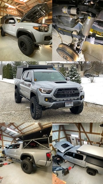

    All finished up!
    I set my preload at 15mm driver side and 12mm passenger side.
    Set all rebound and compression settings up 3 from the bottom to start.
    I went with the Dakar HD leaf pack and SPC UCA’s. SCS Stealth 6 wheels with a 255/85r16 Cooper Discoverer.
    I’m getting quite a bit of rubbing on the front outside rear fender plastic before the cab mount. I’m hoping a good alignment next week will help that.
    So far I’m liking the ride quality a lot. Feels great on the road. Handling my added weight a lot better than stock.
    I’ve got dual batteries, sliders and complete camper buildout in the bed so I’m lugging around some lbs.

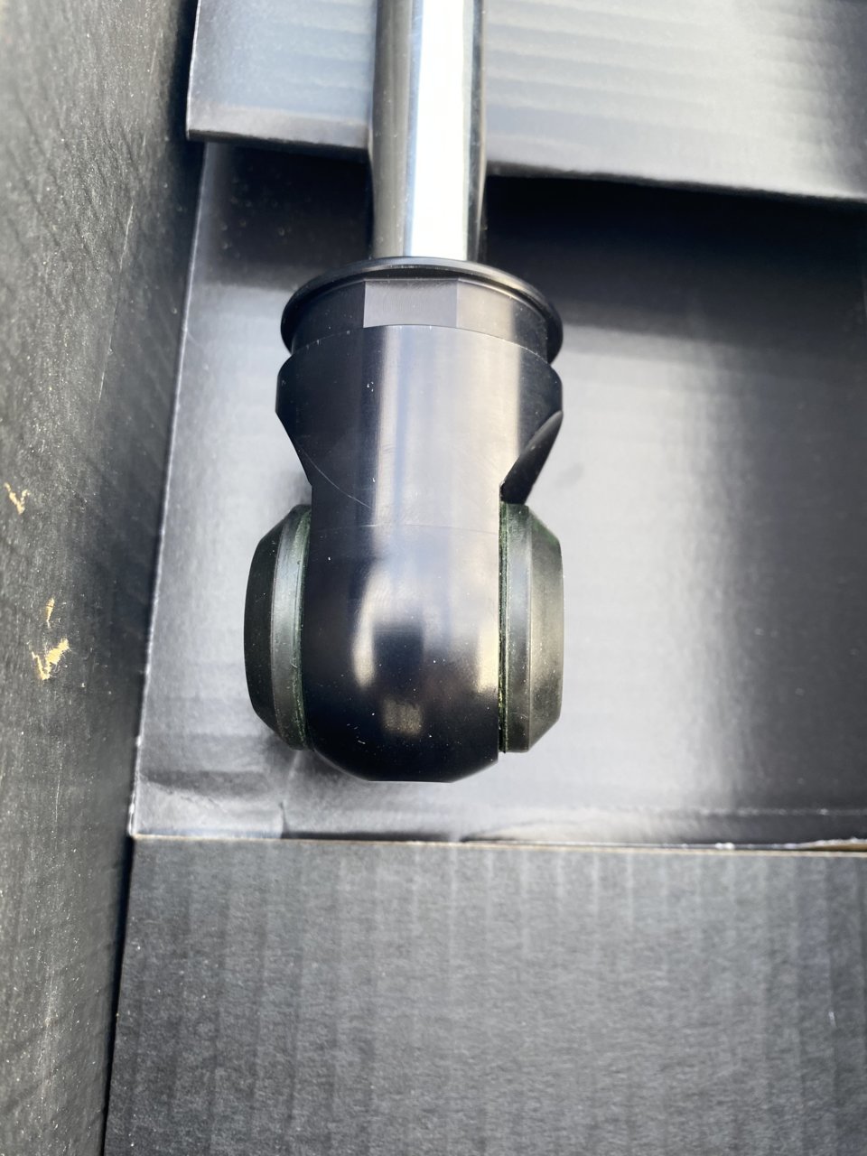

    this is the tool I have. Used with a wall mount spring compressor to adjust preload. The kit comes with 2 spammer wrenches for adjusting compression and preload.

    • Chopped Exhaust Tip Off @ Rear Axle Downpipe
    • Victory 4X4 Center Console Molle Panels
    • 15x30” PowerTye Cargo Net in GFC
    • GFC Awning Mount Brackets (New Style)
    • 12 Volt Solutions Remote Start Kit
    • ARB Coupler Dust Cover
    DRAWER BUILD:
    • (2) Hettich 48”, 500lb Drawer Slides
    • (1) Southco C2-32-15 Series Drawer Latch
    • PZRT Aluminum Pull Handle
    • Herculiner Bed Liner Paint
    • 3/4” Treated Plywood
    Haven’t weighed the truck yet but it’s coming soon.

    Pictured below is the bottom of the rear suspension. I ordered all the parts separately and don’t have any instructions. I attempted to put bottom into the axle bracket but it’s too wide. I got the fitment kit but don’t see how I can remove the rubber ends to make it fit within the bracket to bolt it. Like I said I don’t have any instructions and can’t find any online. Any suggestions?
  20. Mar 18, 2020 at 9:05 AM
    #640
    WreckedRooster
    WreckedRooster Well-Known Member
    Jan 17, 2019
    #279680
    1,254
    Jake
    Oklahoma
    2020 MGM DCSB
    You don't need those outside eye pieces. My kit came with them, but they 'were not installed. Looked like they could be pressed in.
