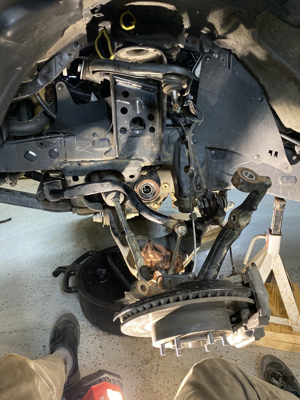

  4. Mar 23, 2020 at 5:22 PM
    #644
    2ayne
    2ayne Well-Known Member
    Oct 1, 2015
    #165609
    820
    Zayne
    Ohio
    2017 Cement TRD Pro
    Just realized I forgot to share some pics.

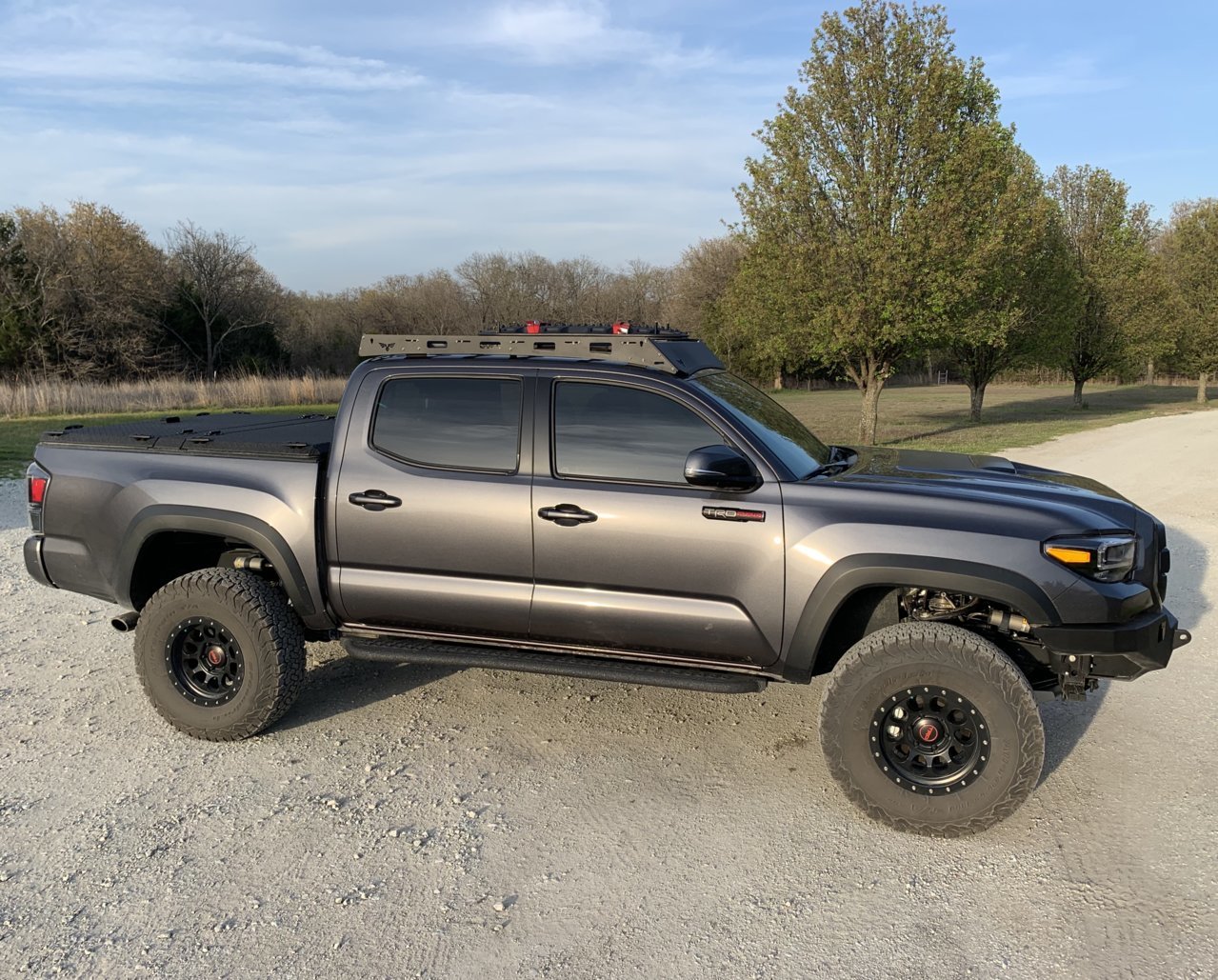

  20. Apr 4, 2020 at 7:23 AM
    #660
    WreckedRooster
    WreckedRooster Well-Known Member
    Jan 17, 2019
    #279680
    1,254
    Jake
    Oklahoma
    2020 MGM DCSB
    Just went outside and remeasured. I’m actually sitting at a 1” rake. 38.5” from ground to fender in the front. And 39.5” from ground to the rear fender. Pic below is how it sits right now.
