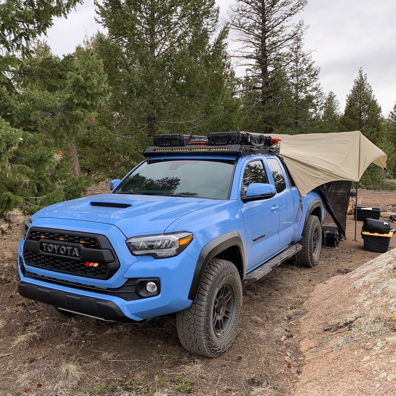

    Hmm okay. I'll see what it's currently set to, the previous owner didn't have bumpers but had Decked and a bed rack, thus the HD leafs. I don't want a harsher ride but I'd like my approach angle to be a little bit nicer.
    They only have an Alpha (the side plates one) for access cabs right now. But I love it. Drilling holes in the roof sucked, but since the ACs didn't come with factory rivnuts there's nothing I could do about that.

    I'm fortunate with the rivnuts. I'm working (at a glacial pace) to get my own rack fabbed up. I like the up top the most of the available ones however. I didn't know that about the AC's. Bummer. Your rig is looking good. The first time I've seen on in that color and been like, "damn that looks nice..." Good luck with the setup. We've had a rainy week so far with more in the forecast so minimal time for me to mess with the adjustments. FWIW I have so much more weight over the front, that I have it set to comp/reb different front to back. Front is set to comp-5, reb-8 and back is set to comp-2, reb-5.

    Thanks! It's actually a wrap, Avery Smoky Blue. Cement was my first choice but I took what I could get, 6MT ACs are pretty rare.

    Beautiful! I went cement, had to wait ages for it. Still love it but quicksand is my other fave.
