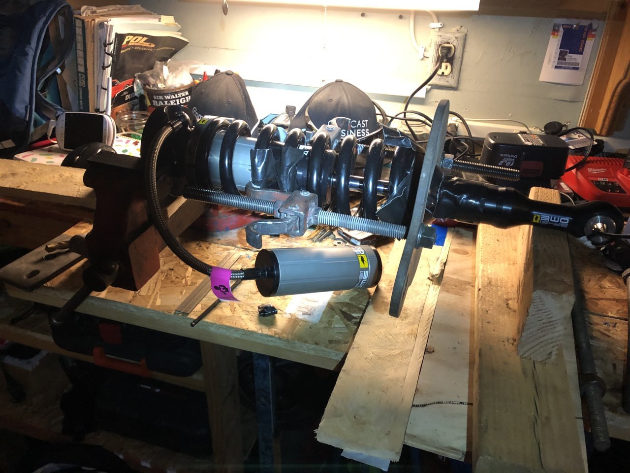

    Looking for some insight and help. Just wasted some time trying to adjust preload and was unsuccessful. I compressed the hell out of the springs but never got any slack to spin the collar. Are you guys using a specific spanner wrench to spin the collar? is there one i can buy that's recommended or any tips to spin the collar once you've got the coil compressed? I'm waiting on some other coil compressors i'm going to try that may work better. Any tips on this are appreciated. or, if anyone recommends a shop that can do it in the CA Bay area.

    So after messing with it, my dad came over and brought some tools my grandpa had made for another purpose. I was able to create a collar and compress the spring further than my first attempt and set my preload to 12mm. Will hopefully pull the passenger side in the next couple days and do the same. Will see what heights I end up at.

    THAT good sir, is certainly my kind of setup! I love shade tree engineering. Awesome.

    Right on! My dad said the plate we used was originally made to be used as a shock tower frame puller for straightening out front end damage.
    I noticed this as well. The first time I couldn’t get it tight enough with the spring compressors I was using. It felt like something was going to break going by hand. The second time with our new setup it went really smooth by hand I think because we were compressing more of the spring and at a more direct angle. Really happy with this new tool and setup. Makes adjustments easy.

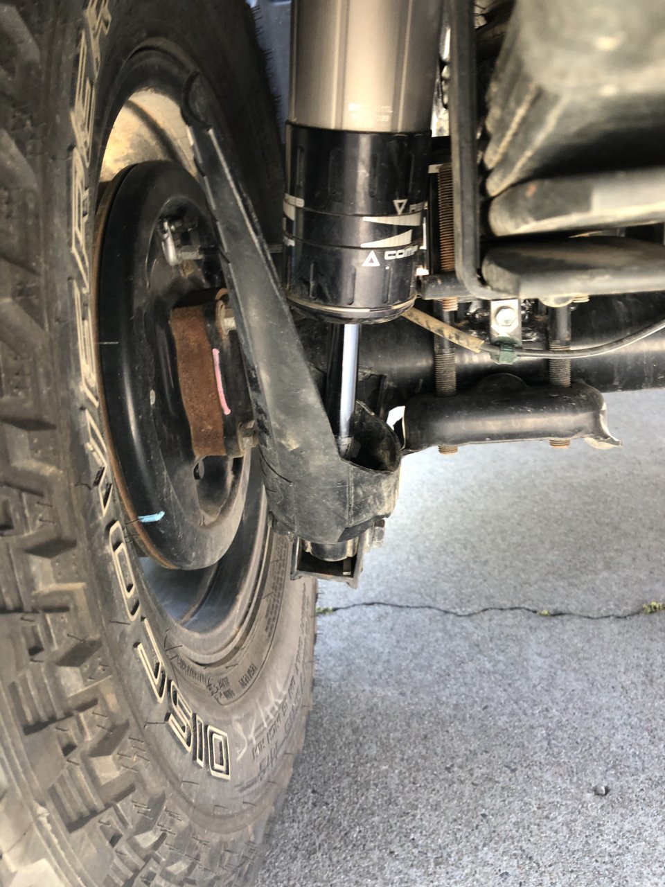

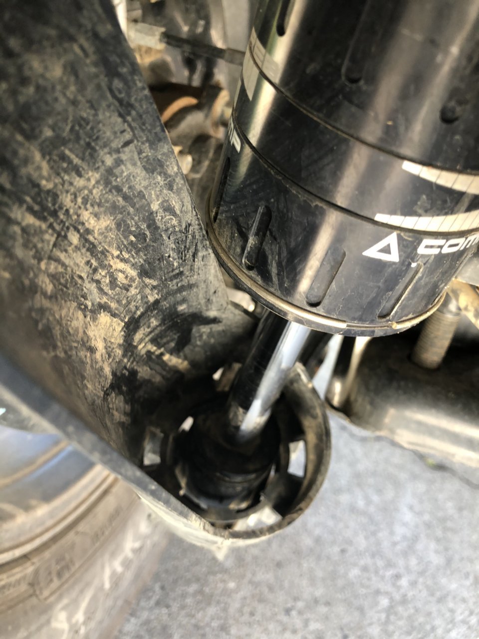

    For those of you running the rear shock and rock deflector shield? Have you just removed yours? I went out on my second time wheeling and looks like the clip already came out of one. Maybe carry a few extras on board?

    I got very activated when I was trying to install mine. I then processed to rip it off because I just had a feeling it was going to cause me to be more pissed off down the road. Then a few hours later I found it useful to make a gutter to deflect my front differential fluid into the drain pan when I did the ECGS bushing, haha.

    BAHAHAHA that was a great laugh. I can totally picture that. I'll prolly be in the same boat next time one comes apart, ARB is sending me out a replacement clip, but i'm not expecting it to last very long.
