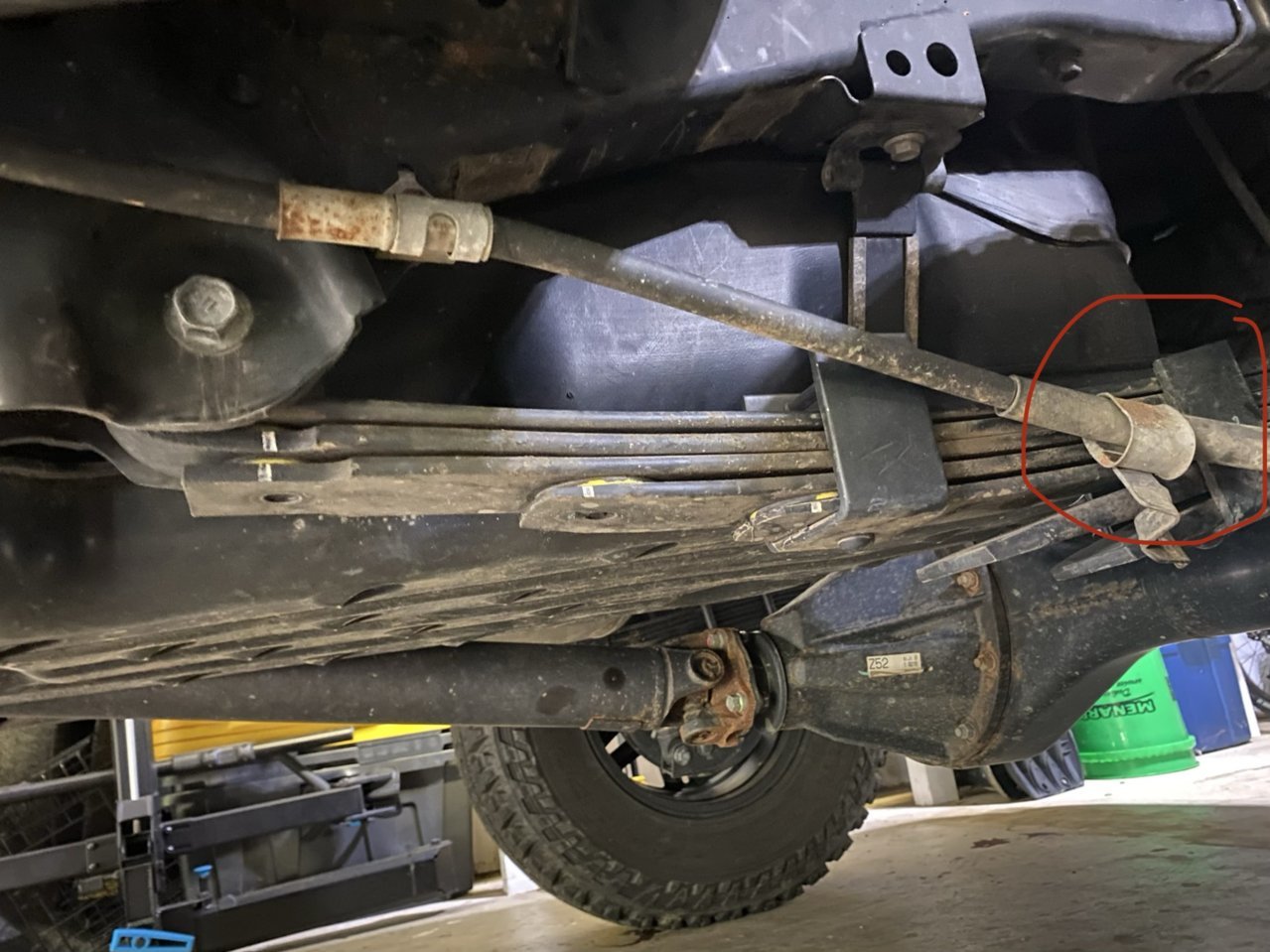

    What did you guys do with the bracket for the ebrake line?
    If I attach mine to the hole in the leaf spring where it used to be on my old springs it will rip the brake like out at full droop/flex.

    Mine is still dangling... Not an issue

    Awesome. Probably hack that bracket off then. I zip tied them were they’re supposed to go. That didn’t last long...

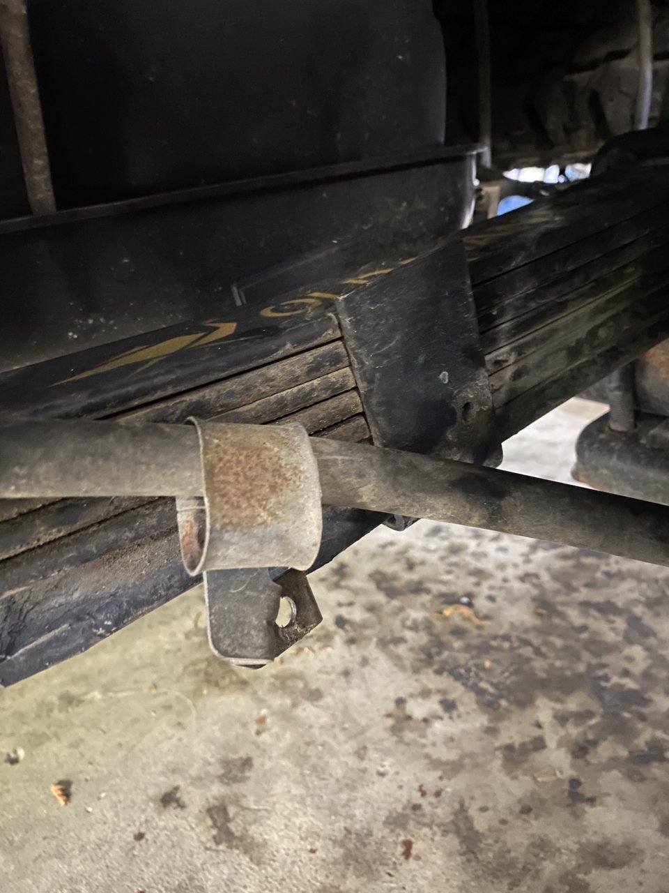

    Sooo, I just checked mine and the bracket is screwed in to the leaf pack, but it had backed off a ton. Almost to the point of falling off. I'm wondering if the cable has been slowly yanking on the bracket, ripping it away from the leaf pack this whole time.

    You must have a newer pack... or mine are backwards... I dont have that hole.. .never did...

    Yeah I totally forgot to mention that a few months ago when I installed the suspension.
    I had the truck jacked up and all the weight off the axle (full droop) and went to install the brake line bracket and said “uh this is going to go bad if I put that on” so I ziptied it.
    I’m running the HD Leaf Pack.
    I did have about 6-700lbs worth of Go Fast Camper, drawer build and camping gear in the back but I recently sold the GFC. Ordered up a different camper. ;)
