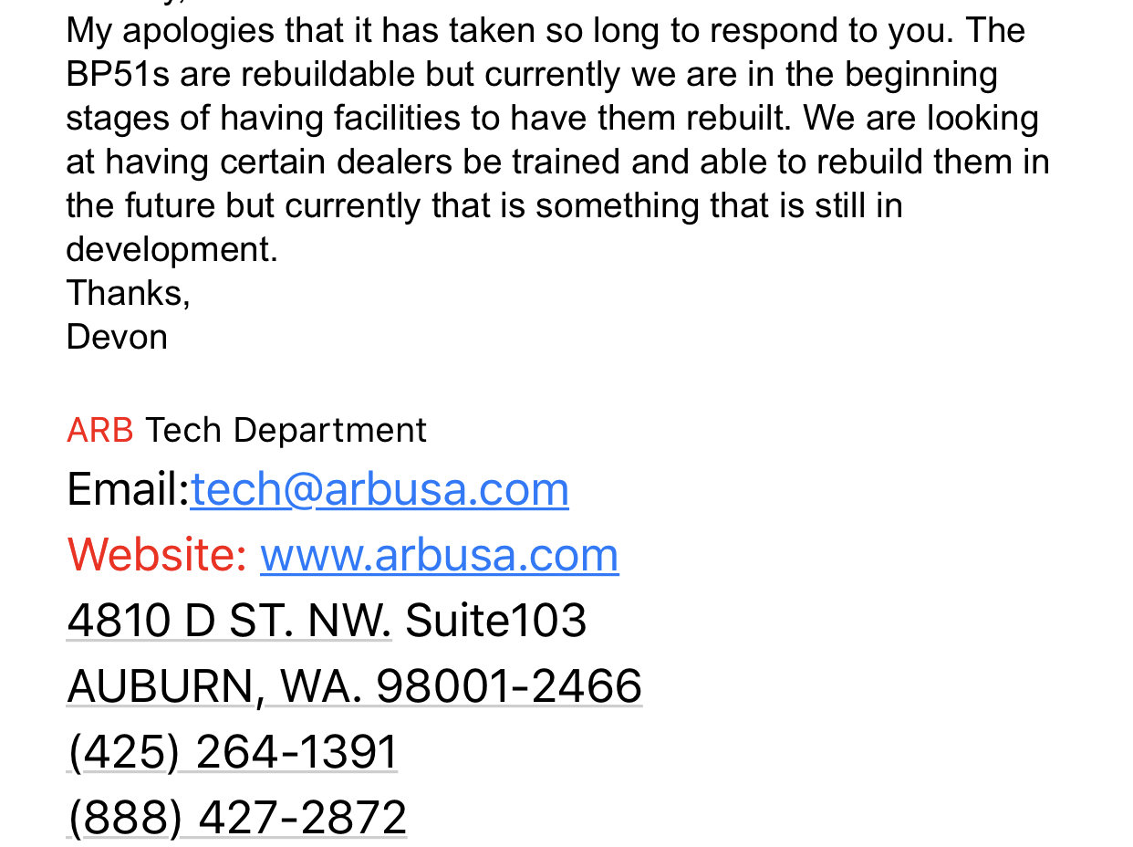

    Got this email today. I’m sure they will have something set up down the line and they look like great shocks, but I ended up going with the tried and true Kings. More travel, 2.5 vs 2.0, coil selection and I’m sure I won’t have any issue rebuilding those when the time comes either.

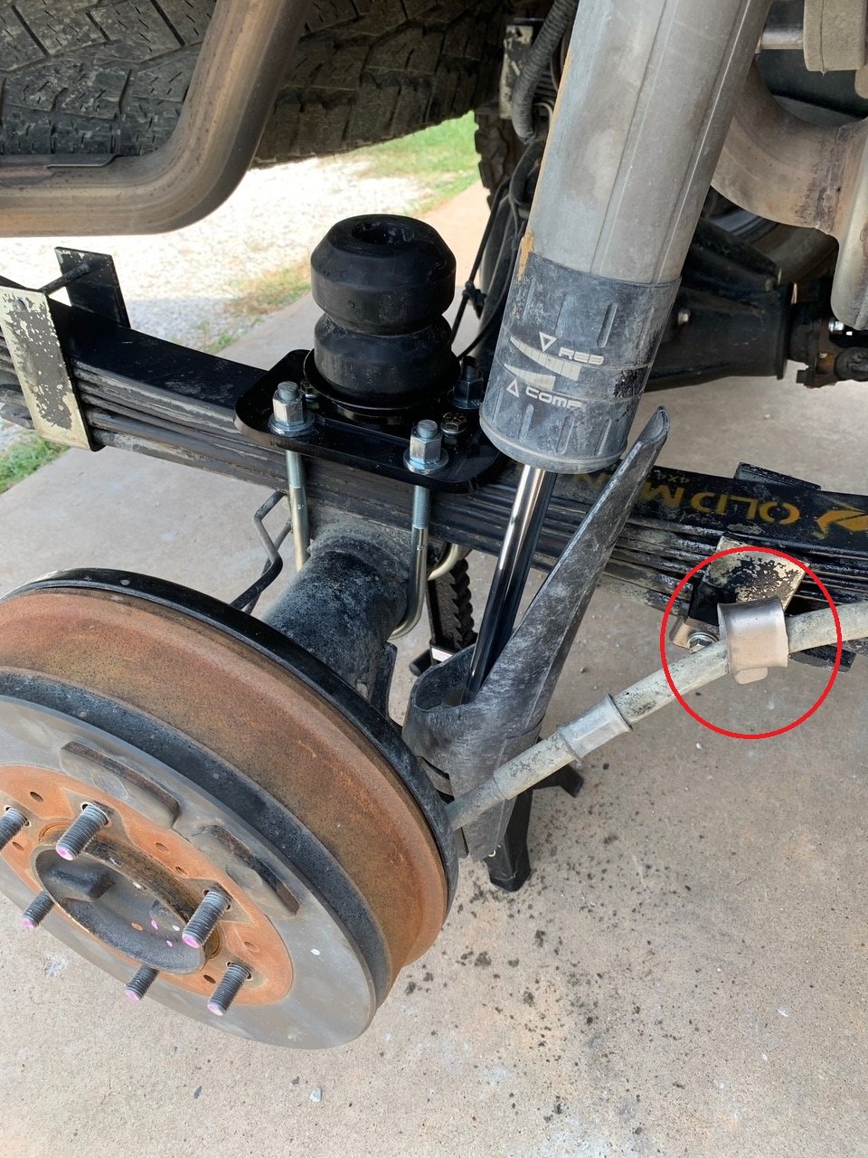

    Is this the bracket you're talking about? If so, y'all just cut it off and let the brake line hang zip tied it? Thanks.

    Mine is zip tied at the moment. I couldn't get the bolt in the leaf pack hole at midnight in the driveway lol
    I don't have much more info for ya - i'll get around to it eventually :)

    I have the opposite worry... If you flex TOO much and the line being snagged by being forced routed though that point... just cut it off

    Yep. I cut mine off. Then wrapped rubber around it and ziptied the rubber on on protect that second of brake line front rubbing the leaf spring.
    I just let the line hang. If not it will pull it out at full droop.

    Thanks! I'll do the same. It's pretty tight as it is now.

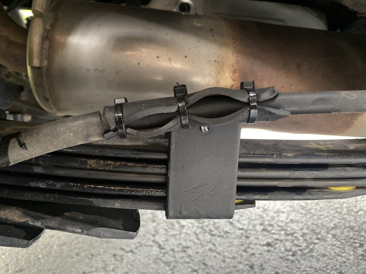

    So, cut the metal bracket and zip tie the brake line to what? Can someone show a pic? I'm going to take a zip wheel to the bracket today

    I cut the bracket off and just let the line hang.
    But where the line rests on the leaf spring I wrapped it with rubber to give it a little extra material so it wouldn’t rub through the hose over time.
    I used to have it ziptied up to the hole where that bracket would go but the first time I flexed the truck the ziptie snapped. Luckily i didn’t have the bracket on because it likely would have been the brake line.

    Like this.
