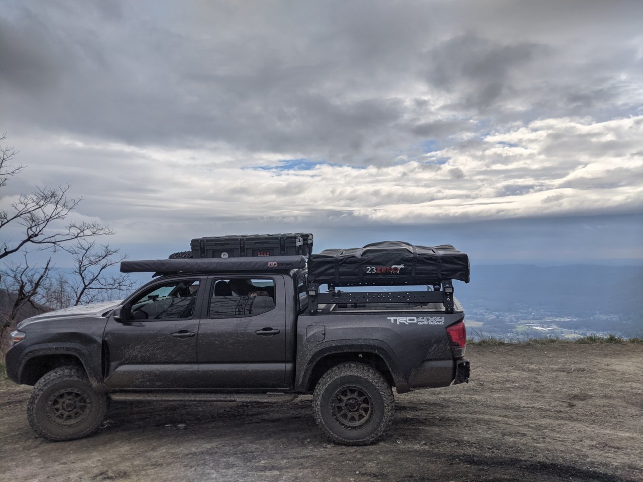

    Just as another data point, I've got dual agms in factory location, winch, steel skids from rci and the covert steel bumper from cbi.
    I have a 1/4" spacer driver's side.
    To get my rake close to even, I had to go maxed out driver's at 30mm and 27mm passenger. It still has a very small rake.
    I have a kbvoodoo steel rack and 23zero tent mounted in the rear
    Dakar heavy leaf pack in the rear.
    compression is maxed out all around
    She weighed in about 6500lbs lol
