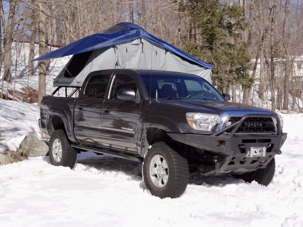

    When I installed my bp-51s, I ordered the kit with the Dakar hd pack because I knew at some point I would have added weight in the back end. At the time of installation, I had no weight back there so I split each leaf pack, and took out the third leaf, making each one just a regular Dakar pack.
    Well, I finally pulled the trigger on a rtt so it looks like Ill be adding those leafs back in.
    Ill also use this as an opportunity to do the u-bolt flip since I didn’t initially do that. Everybody seems to love the Timbrens, so I will likely go with this. Cant wait for the first thaw to get here so we can get out and go camping.

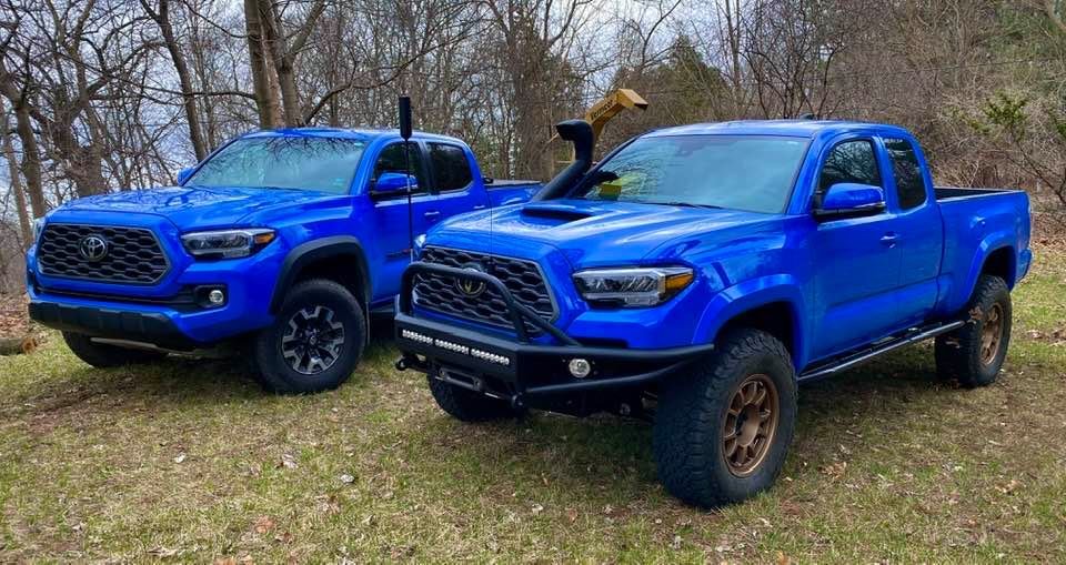

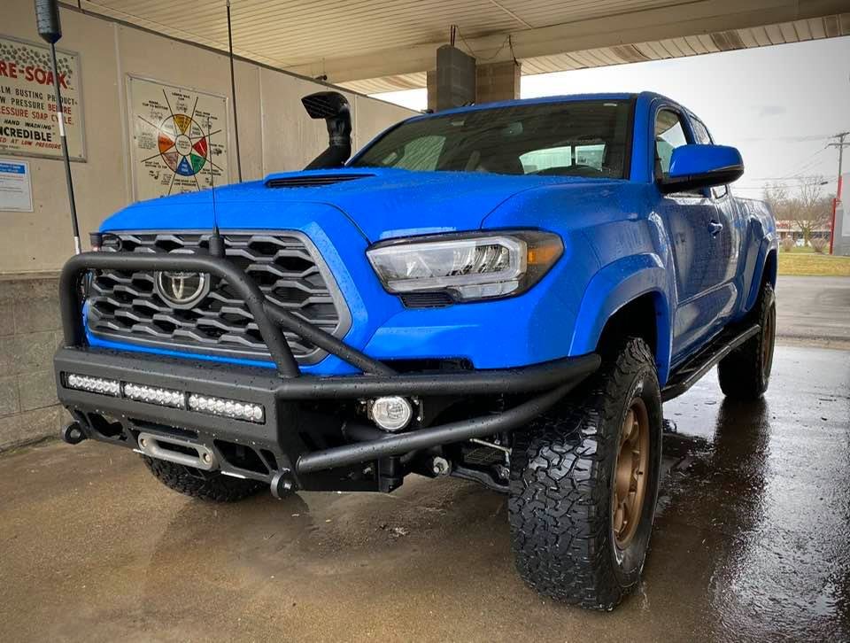

    Long travel house on 35s with a custom aluminum utility bed and FWC
    some welding required
    finally got around to taking measurements. Looks like I only net 1" lift with 12mm preload with a full steel bumper and winch up front and rock rails (ignore the rear, im not running OME suspension out back)
    no skids on yet but they are sitting in the basement ready to go on soon.
    anyone care to take a guess at what they think i should set preload to get to about 2.5" lift?
    I figured I'd start by going to 20mm, but im surprised how low I'm sitting with 12mm judging by the other people posting in this thread.

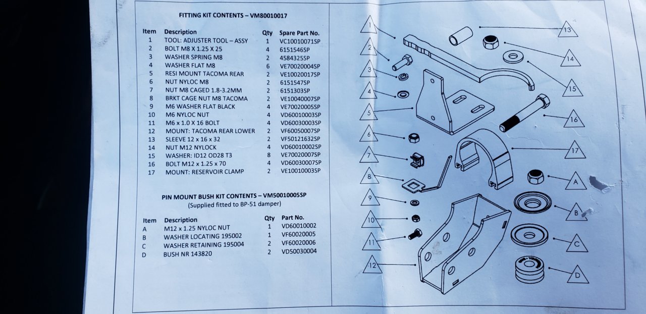

    Does anyone know the part number for the wrench to adjust the Rebound and Compression settings? I had found the part number at one point but lost it. I would also buy one if anyone has one they do not need anymore. Thanks!
