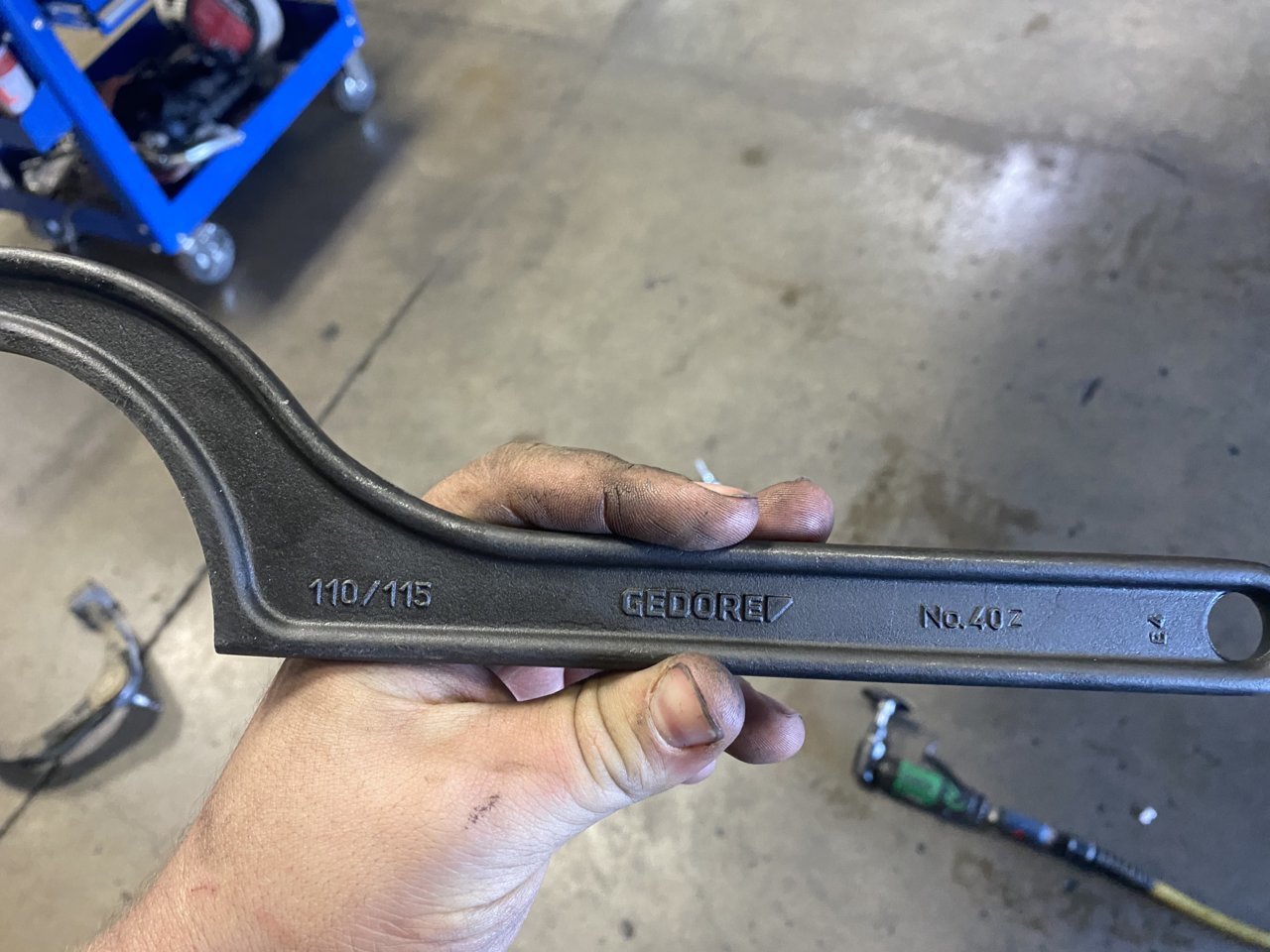

    anyone else struggling with the stock spanner wrench to changing the damping settings?
    the spanner is too "rounded" on the tang and keeps popping off the adjustment collar pockets with any amount of dirt/mud in them.
    actually even after i cleaned them really good they still pop off super easy.
    anyone have a better spanner?

    try taking a square file to that spanner edge to clean/square it up. I don't know of another spanner that will fit.

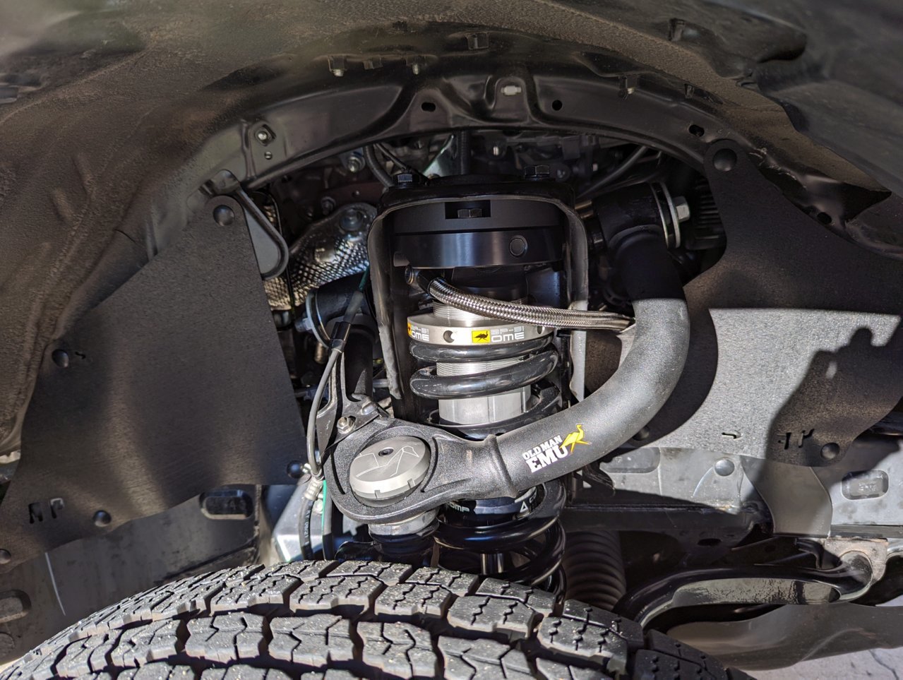

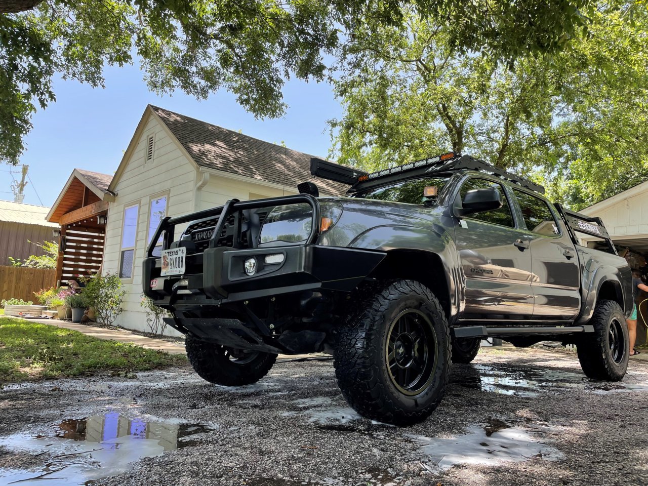

    Thank you to everyone who contributed to this thread. It has helped me tremendously preparing for my install. My BP51's are at the house ready to install and without this thread I would have been battling adjusting pre-load and trying to compress the springs with a spring compressor that would ultimately been a major hazard to myself. Now just awaiting a new spring compressor linked in this thread and will do the install on a weekend when I'm off work.
    For more info for any future readers, my current setup suspension wise and added weight is as follows:
    Suspension: OME Nitro Chargers with 886's + @HeadStrong Off-Road 1/4" spacers up front with SPC UCA's. Dakar HD leaf packs out back OME Nitro Chargers.
    Front: ARB bull bar bumper, Smittybilt winch with synthetic rope. ARB dual compressor mounted under the hood on passenger side. AGM battery in stock location.
    Center: Demello Sliders.
    Rear: 4XInnovations bumper with tire carrier, swingout & Jerry can holder + Hi-Lift Jack. KBVOODOO designs bed rack (Tepui RTT mounted when we go out adventuring; don't run it all the time)
    My plan is to set pre-load as close to 20mm as possible adjusting for the typical TACO lean and with the weight I carry daily try to be as level as possible, but I might settle with having a very minor rake up front so when I do load down with gear and the RTT I'm not negative raked out back.
    Again, thank you all very much for this thread. It was worth reading all 43 pages before doing my install.
    Xero, Jose_Dirte and BadDNA like this.

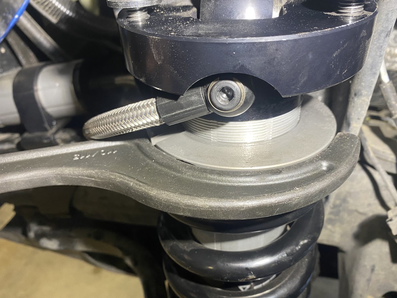

  7. Aug 29, 2021 at 11:51 AM
    #847
    Jose_Dirte
    Jose_Dirte Life's a garden, dig it
    Dec 12, 2018
    #275687
    660
    Joey
    Green Acres, CO
    A Tacoma, just like everybody else...
    For what it's worth.
    I believe you can damage the threads if you don't take them out and use a spring compressor to adjust pre-load.
    But that's just what ARB told me, they also said not to use the preload to adjust lift only to adjust preload for weight.
    stonylaroux likes this.
  8. Aug 29, 2021 at 12:46 PM
    #848
    Evan_P
    Evan_P Well-Known Member
    Jan 5, 2020
    #315262
    250
    Evan
    Hillsboro OR
    2020 Voodoo Blue TRD Off-Road
    Correct, there is a chance of damaging threads. My adjustment on truck was solely to realign the collar correctly as per ARB instructions as I didn't do so when I adjusted them on the bench in a compressor. But the wrench could still be useful then. As for preload for lift, I had to add some as when I first installed at the shipped 5mm preset, I only gained 1.25" of lift over stock, which did not work with the 3.25" lift the Dakar leafs netted. Driver set at 12mm, passenger set at 9mm with a Headstong 1/2" spacer on the driver side and 1/4" on passenger set the front perfectly level side to side and netted a total lift of 2.75" front and the rear has sagged down to 3" so far.

    +10000 on this post! ARB didn't have the wrench in stock and won't for a bit. I looked at every tool and industrial supply shop in multiple nearby towns and no luck. Grainger had this in stock and shipped same day. Thanks for the info Evan!
    Evan_P[QUOTED] likes this.

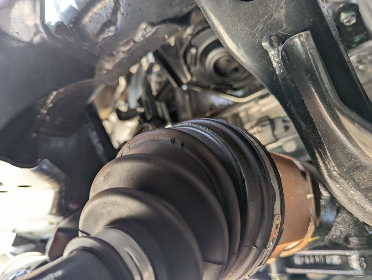

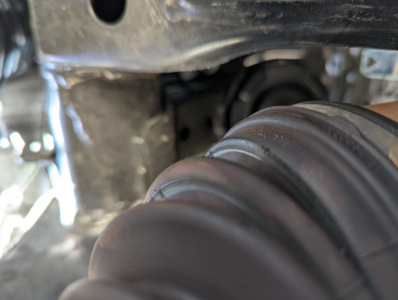

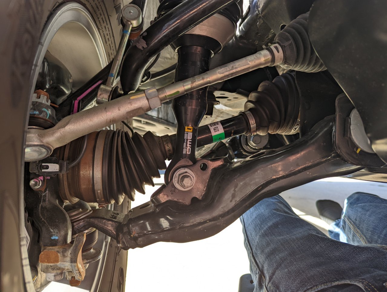

    Seems the upper cv axle boots are wearing a line in them after install, do I need to do a diff drop to fix the angle?

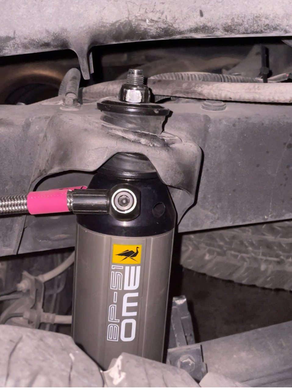

    Notched out my rear shock mounts . Read a few horror stories .
    eurowner and Lando883 like this.
  17. Nov 30, 2021 at 10:53 AM
    #857
    o313
    o313 Well-Known Member
    Jul 18, 2018
    #259750
    512
    N
    2018 DCLB AT SC
    Is this something that still hasn't been corrected?
  18. Nov 30, 2021 at 11:39 AM
    #858
    Jose_Dirte
    Dec 12, 2018
    #275687
    660
    Joey
    Green Acres, CO
    I saw one video where someone had this issue
    I personally have beat the crap out of these and never had any contact between the two parts.
    Edit:
    Just wanted to add that ARB is fantastic with their warranty and customer service. If this did happen, they would make it right. I personally would rather not modify my top mount and run the risk.
    pocketsmcaaron and o313 like this.
