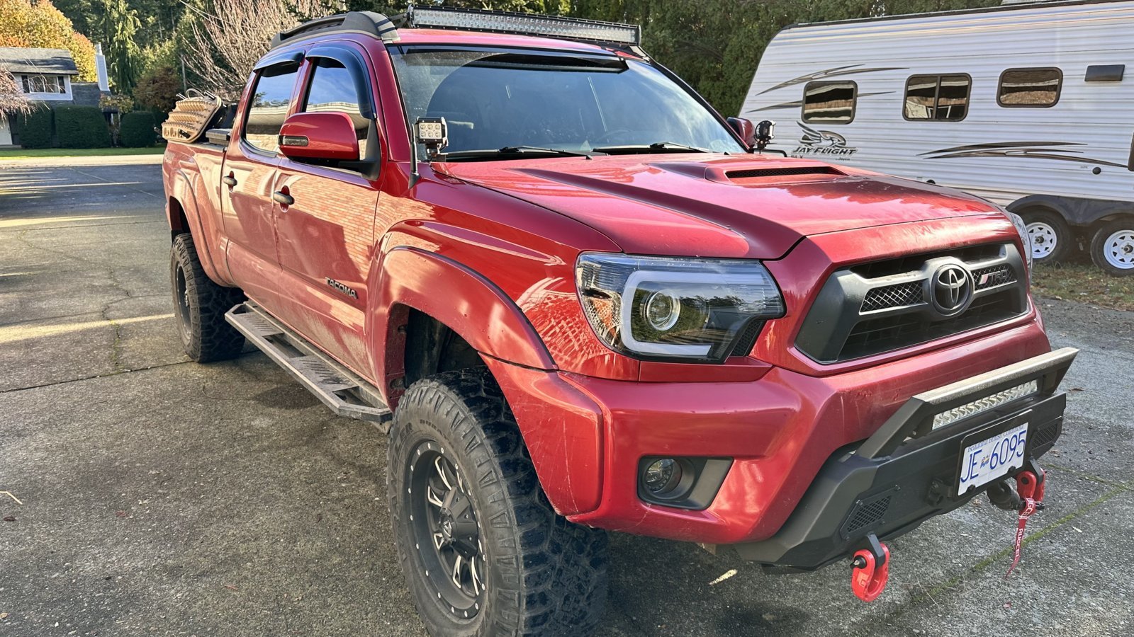

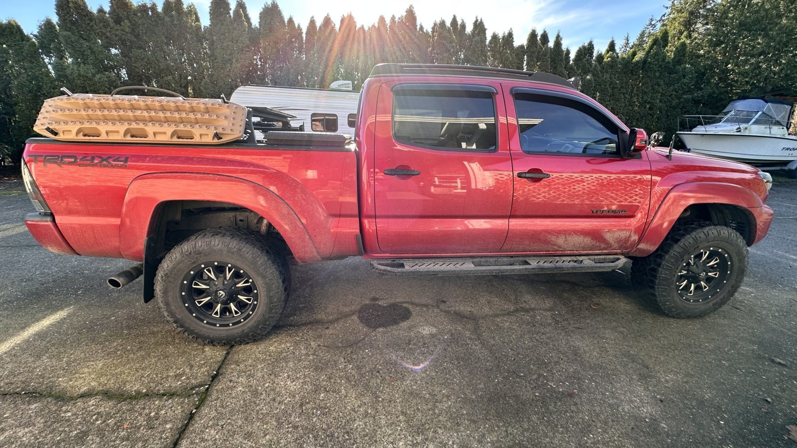

    Hi all, just wanted some input from your experience with preload settings for the BP-51s on my 2013 TRD Sport. I had a shop set the preload today, and they took my $$$$ and gave me my coilovers with 22mm on the passenger, 25mm on the driver side. I was a bit shocked, they knew my front setup (Scorpion bumper w/ 12k lb winch, no armor, pictured below). And for reference, I do have the OME HD Dakars in the rear, with some gear, toolbox all the time.
    So my question is, should i bring them back in and ask for a readjustment, or try it out? Definitely leaning to get readjusted to about 17mm on passenger side, 20mm on driver side, considering everything y’all have said in this thread.
    Any input is appreciated, as I don’t know what these guys were thinking. I really want a nice ride on pavement and dirt roads, and be able to use the comp/rebound accordingly and not have to pull out these guys 3 time to “dial them in”.
    myn75 likes this.
  11. Nov 26, 2023 at 8:20 AM
    #891
    myn75
    myn75 Well-Known Member
    Dec 6, 2020
    #348879
    593
    Nor Cal
    2021 TRD Off-Road 4x4 DCSB, 1996 4runner SR5 V6 4x4 auto
    ARB OME BP-51 2”, TJM sliders, AT3Ws, Diode Dynamics SS42"
    Id definitely bring that down, im 10/10 with no real added weight and even that is probably the most id go. It netted a 2.25 inch lift for me. The ride quality is also amazing and i was able to absolutely bomb down some straight rough trails with the right tire pressure. As well as on-road it feels like the stock softness
    Provided you do have some weight up there I think 17/15 is probably the best bet. However thats just an opinion based on what ive read on these and the weight you have. You still do want to have some down travel especially across different driving styles off-road and im not sure how your shop got to 25 whereas my shop says 20 itself is really hard to get to due to the spring being so compressed.
    Ive also read (but of course it must be taken with risk assumption) that up to a 1/4” top hat spacer can be added on top without exceeding the geometry limits of the suspension and have no affect to ride quality and will net you an extra 0.5 inch of lift. Personally id run it with an extended bumpstop if i went that route.
    But in conclusion id much rather prefer functionality over an extra inch or whatever of lift. If if i wanted more then it would be time to break out the ol’ wallet and dish out some cash for quality parts
  12. Nov 26, 2023 at 11:59 PM
    #892
    LukeDF55
    LukeDF55 Member
    Nov 7, 2015
    #168983
    10
    Luke
    2013 Tacoma 4x4 DBL cab V6 Sport Pkg
    3inch Lift, Duratrac Wranglers with Throttle Fuel rims
    Thanks Matt, very much agree with your assessment. I’ll be going in tomorrow, hopefully they will stand by their work and bring it back down. With my bumper and winch, I estimate I have about 120lbs extra in the front end. So I think 15mm pass / 17mm drivers is what I’ll go with. In the picture above, I’m sitting at 23” from hub to fender with the current toytec coilovers, which is about 2” lift, right?
    If I get 2.5” at 15/17mm and a plush ride I’ll be a very happy man.
  13. Nov 27, 2023 at 9:02 AM
    #893
    myn75
    Dec 6, 2020
    #348879
    593
    Nor Cal
    Not sure what your before measurements were as stock but that lift height should sound about right. Others have reported pretty decent lift above 2 inches with 20 mm and added weight and winch as per ARBs recommendation but also found it to be too stiff and top-out too early. These coilovers were also designed for heavier rigs as well so that’s probably why.
