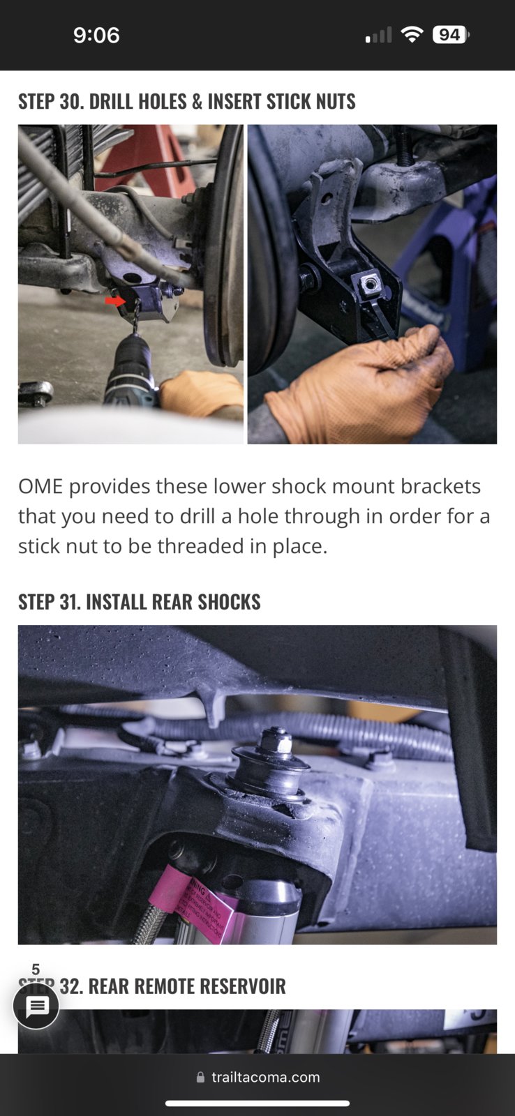

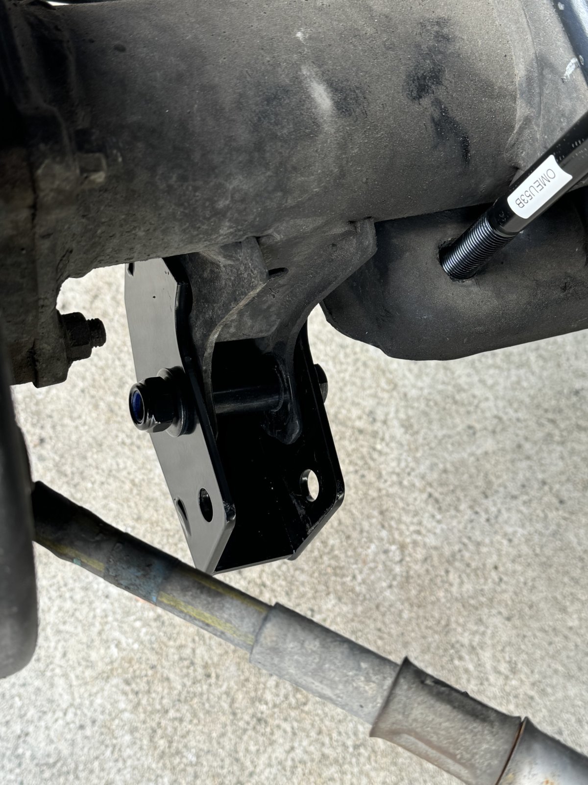

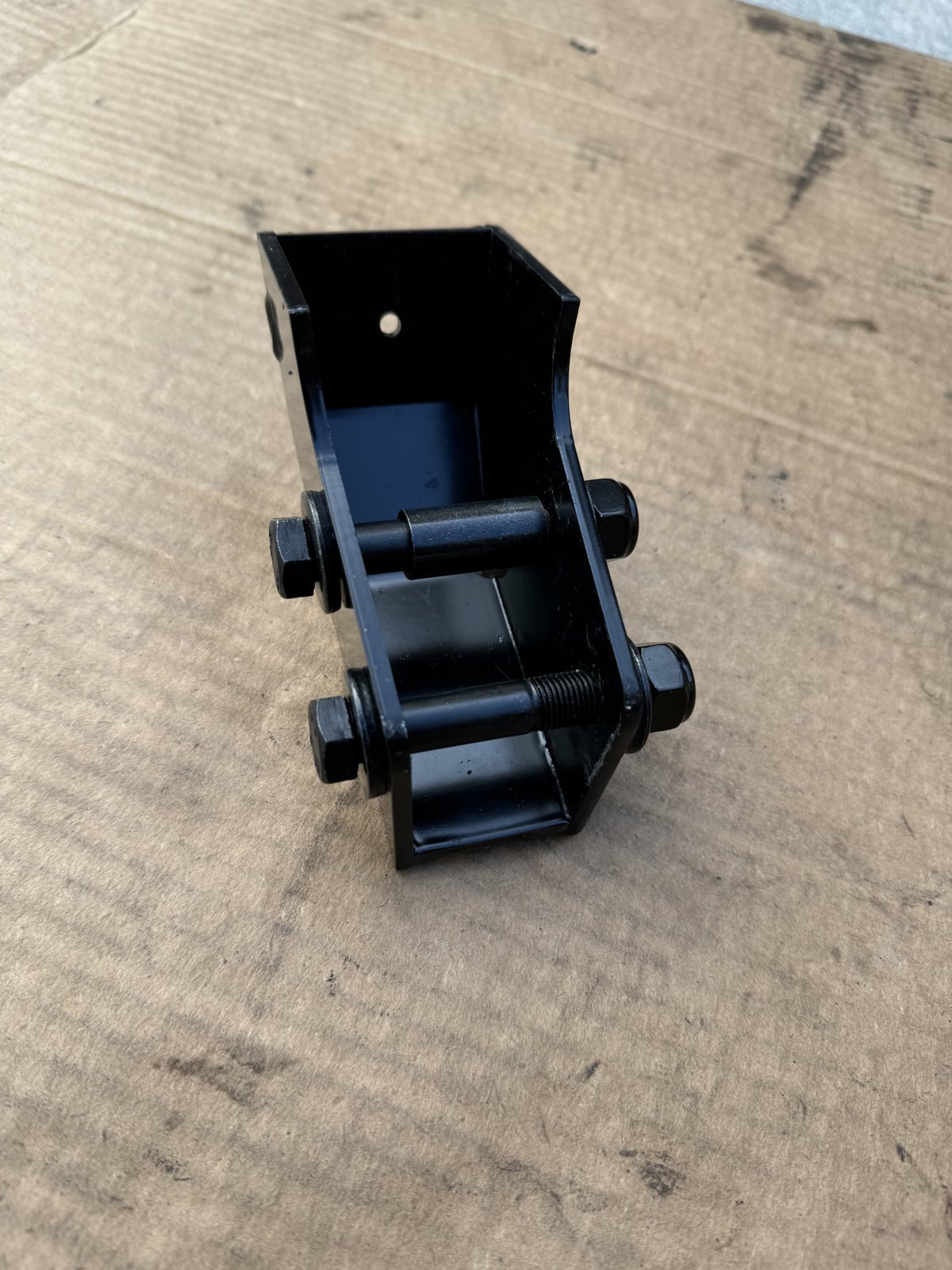

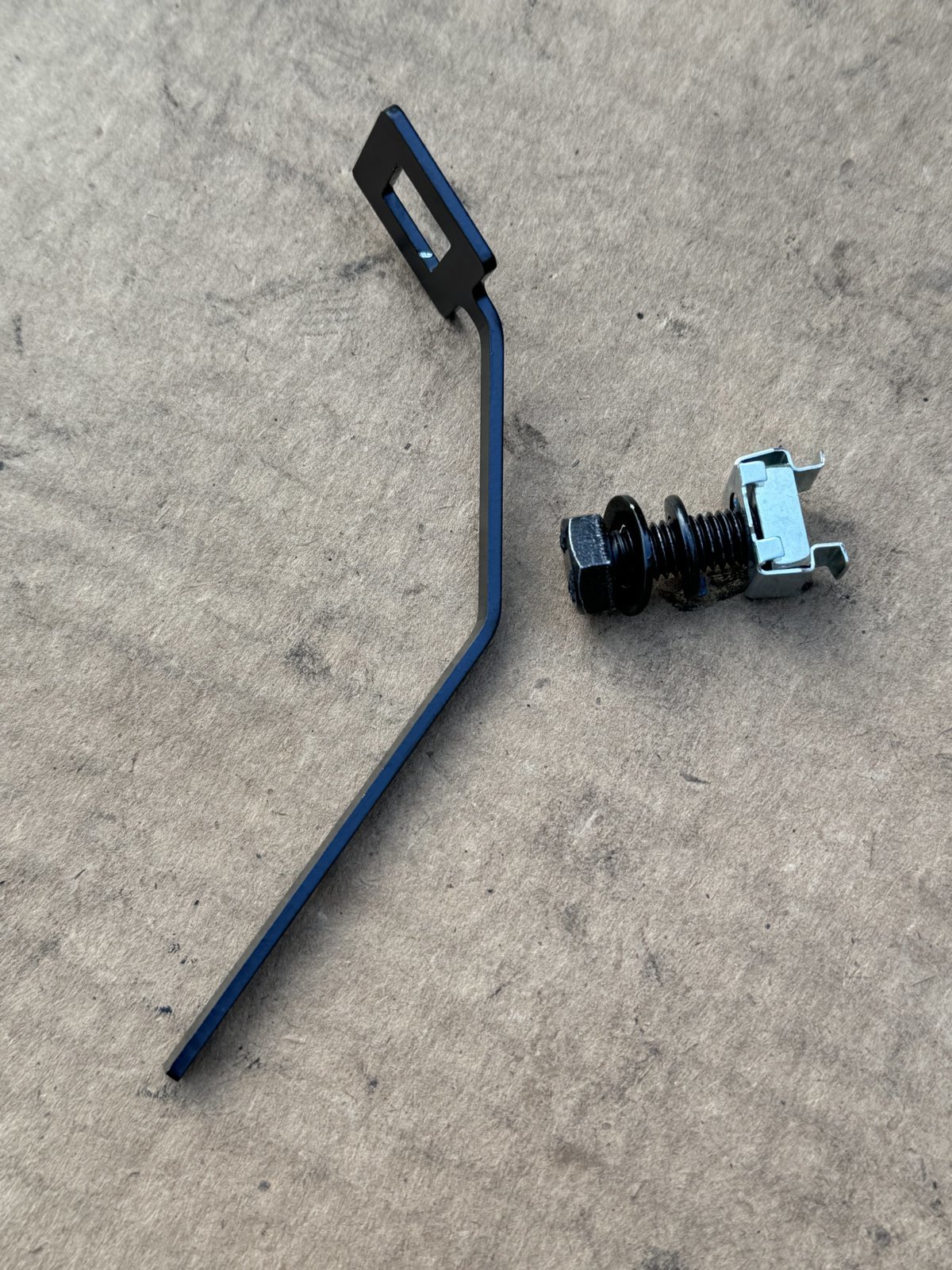

    Hey all, need help installing the rear shock bracket. I understand there some drilling involved? Mine didn’t come with instructions. I found a pic on the internet but it doesn’t detail what needs to be done. Would love to see pics if you have it.

    Looks like some time has passed since this comment, but essentially the bracket serves as a jig for your drill bit, just find one that fits the hole at the front of the bracket best. Drill the hole and paint it and resecure the bracket while using the provided hardware

    Thanks! ARB has excellent customer service and gave me instructions in a few hours after contacting them. They were also solid when my leaf liners was all damaged during shipment of the leaf packs and they sent replacements in just a matter of days!
