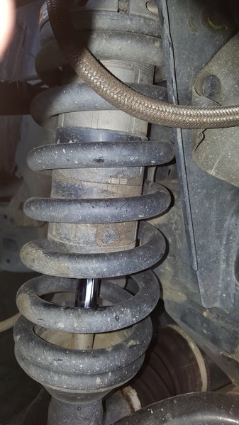

    One reason is the shock body is very close to the springs and needs a special compressor

    To put them in a brannick style spring compressor and release the pressure. This is to minimize risk of fucking up the threads.

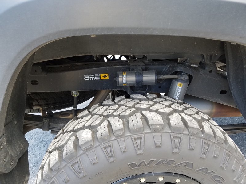

    Just installed my Kit... Not the easiest install, but all in all it went well. Having a beer, or many over the next couple days. Will try and gather my data, and post it when I get a chance.
    Teaser... Super Happy!

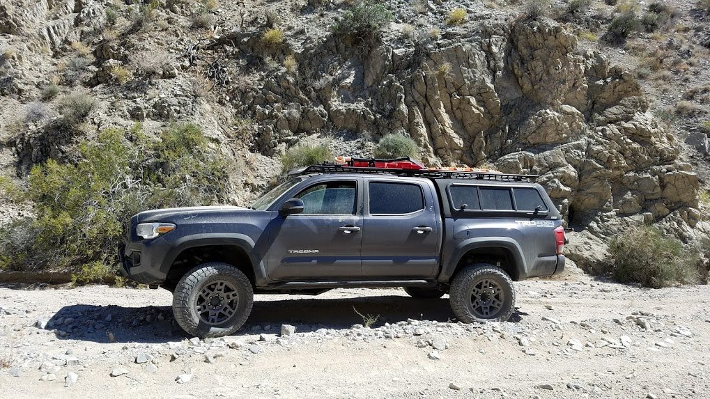

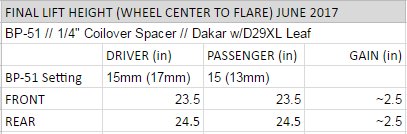

    As I mentioned before, the suspension 'tops' out too much off-road off bumps and ledges at the 20+mm setting even with the accessories I have on the front. I estimate between the extra Optima D35 battery (35lbs), ARB twin compressor and mount (20lbs), Southern Style Off-Road Slimline bumper (55lbs), Warn Platinum 10-s (75lbs), lighting and wiring (10lbs), that I probably have a total of 200lbs of additional weight on the front axle. In order to avoid damage to the shocks, I lowered to the 15mm setting. With the D29XL, and all of my accessories, I have netted 2.5in at all 4 corners. After beating the truck up for a few months at this setting, and the truck riding like a dream off-road, I've concluded this is the final adjustment for my build!
    Note: actually I tweaked the 15mm setting from side to side to avoid the Taco Lean:
    Loaded down in the back with all of my gear, she sits level.
