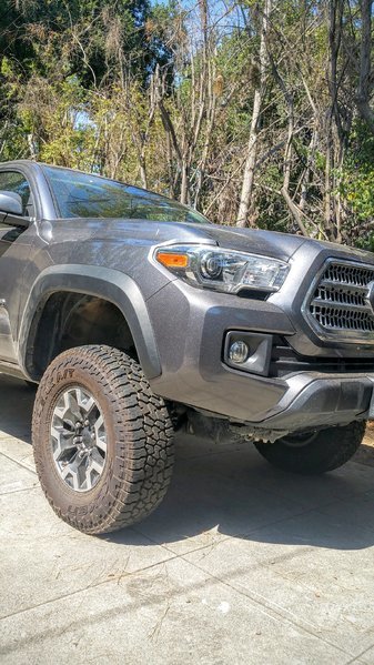

    Here's what a 3rd Gen TRD OR looks like with BP-51 coilovers at 20mm setting (pre-set by OME/ARB).

    Here's what it looks like with weight added on the rear, and the front BP-51 coilovers lowered down to 5mm pre-set.

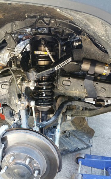

    Yes, use the tool VM80020001 on the bottom of the coilover, and orient the bottom of the coilover upward as shown. There are also instructions in the kit. The tool has 3 perfect slots that mate perfectly with the top side of the wall mounted spring compressor.

    If you plan to keep the front lightweight, I recommend absolutely no more than 10mm. 20mm is too much. My shocks consistently "topped out" over bumps as there was not enough up travel with no weight on the front at the stock 20mm setting.
