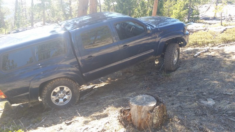

    Installing 2" shock extenders could fix the down travel issue and allow full travel from the drakars. I have them installed on my truck with 5100 bilsteins, toytec AAL and spacers to achieve 5.5" of lift in the rear. Lifted on a budget!taco.jpg Bunce 5-5.jpg

    Wouldn't you lose up-travel?

    I am not sure if I lost any up-travel...I did not measure stock vs. lifted. Maybe someone else has more knowledge on your question of losing up-travel w/ shock extenders.
    I am running 265/75/16's and it doesn't look like there is much more room inside the fender well. I wanted to run the 85 series but didn't have the extra money to spend on the front to fit them correctly.

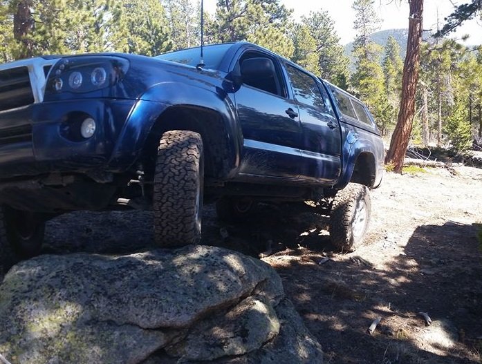

    Here ya go!
    So far...very nice but no highway or off road yet. That will be tomorrow. Mule did an outstanding job!

    Awesome stuff! Don't suppose you took pre- and post- hub to fender measurements?
